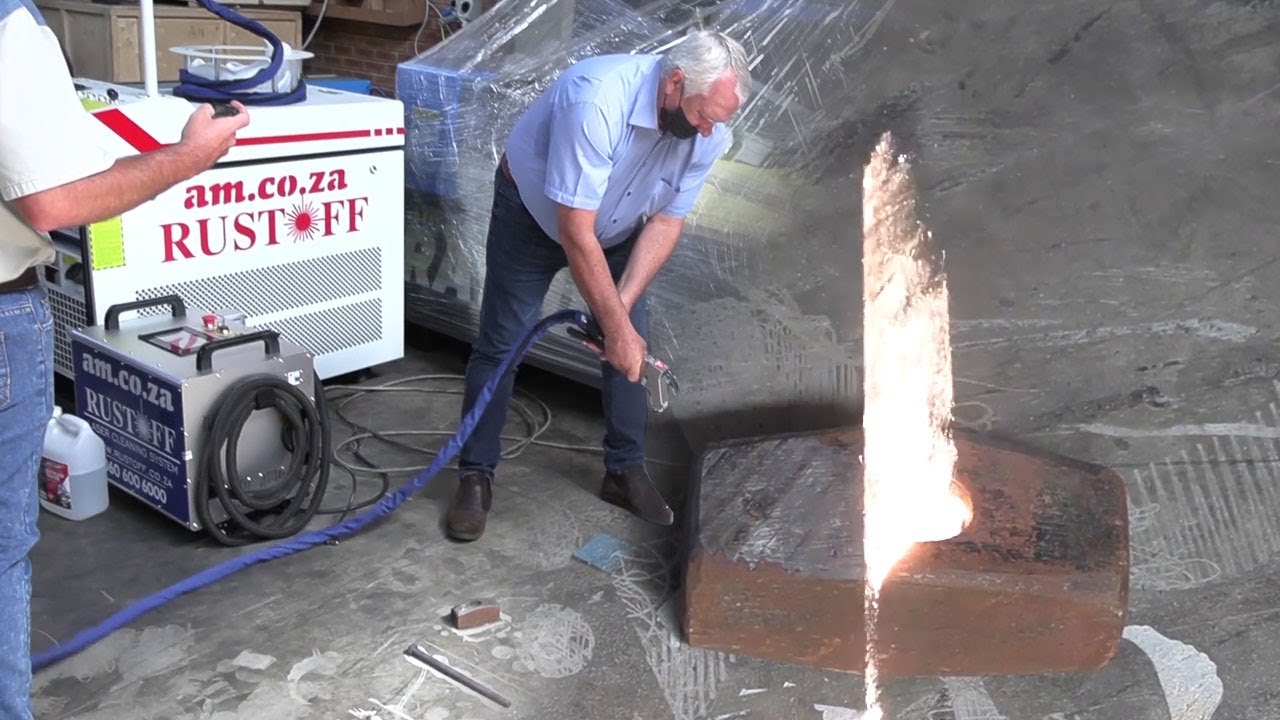

A 1064nM IR laser will pass completely through this, like it’s not there… If you can’t engrave it directly, it’s not going to be any good as safety glass protection.
Saying that, I’ve seen Youtube video of people using them with no glasses, include a rust removing fiber, Raycus and jpt sources and a hand held nozzle… no glasses…
This is a 2kW fiber laser… notice no eye protection… I think you should always were eye protection, even if it’s from flying sparks or other debris.
I can’t engrave on baloney either…
And no fume protection. Those surgical masks aren’t much good against anything like that.
Most of the time, nothing bad happens and you get away with doing it. Once in a while, you lose an eye. Maybe, years later, you start coughing up a lung.

I’m sure these people aren’t going home blind - I also doubt they are so stupid to keep sequencing people in that can see for the blind people going out…
I see the same thing in middle eastern machine shops with heavy equipment and material… all wearing open foot sandals…
Makes you question many things…
