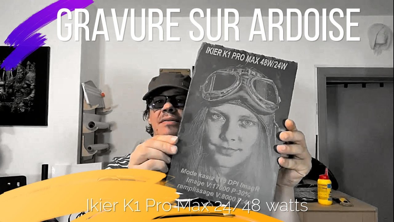

Did you invert your image? I recommend Benmaker’s great tutorial on YouTube, with his R image solution

the slate is black in 90% of cases, rarely gray, if we engrave as is the pattern will be white (+/- gray depends on the test) on a black background. Otherwise it is possible that an incorrect setting is the cause. There is a professional on YouTube, it’s Benmaker second time I say it but if we don’t take the trouble to understand.
So I post the link, I do the work…
His work is top of the top? so listen to him…
English version?
Try this:
  • Hit the Youtube link to view it there
  • Turn on closed captions
  • Hit the settings to auto-translate into your favorite language
Might be gritty, but it’s way better than my (nonexistent) French.
I turned on closed caption for a Japanese clip..the captions were also in Japanese. :face_with_spiral_eyes:
