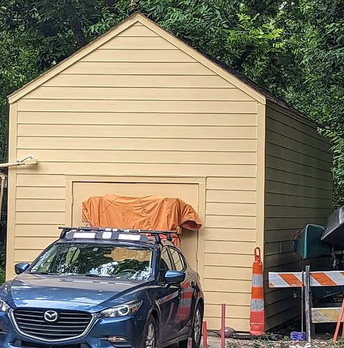

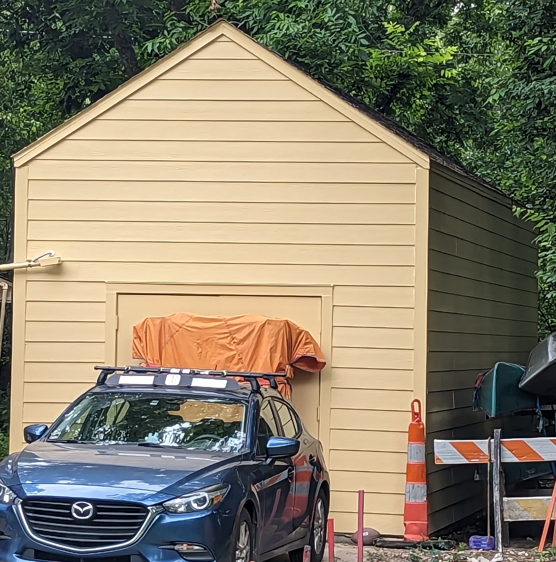

Of course, if this is also going to be a bit of a show-off-your-shop thread, um… I’ve got to get things a bit more photogenic before I snap inside photos, but I do have a slightly dated outside photo, at least, although it doesn’t have the air intakes…
(The shop couldn’t be more than 12’ wide due to the house, a natural gas line, and the required setback from the property line, so it’s 12’ wide. It couldn’t be more than 30’ long due to the driveway, house entry door, and a giant pecan tree at the other end, so it’s 30’ long. Building code here has tables for wood studs up to 10’ tall, but above that requires a structural engineer sign off, so it’s got 10’ ceilings. And the rafter hangers I used (to make it stronger against hurricanes and much easier to build solo, as I did) allowed up to a 30° pitch to the rafters, so it’s got a 30° pitch roof for maximum storage above the open-joist “ceiling”. Don’t even get me started on “1-hour fire-rated wall assemblies”, or you’ll be here quite a while. :wink: Oh, and I brought 100-amp service through to the subpanel in the shop, so if my next vehicle’s electric, I’m ready.)
