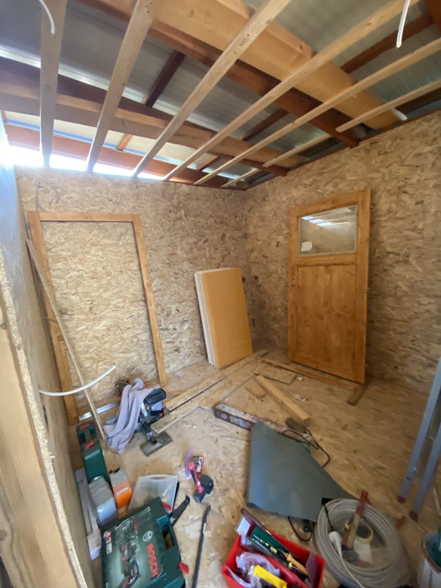

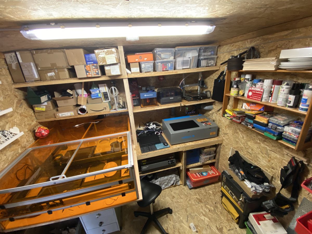

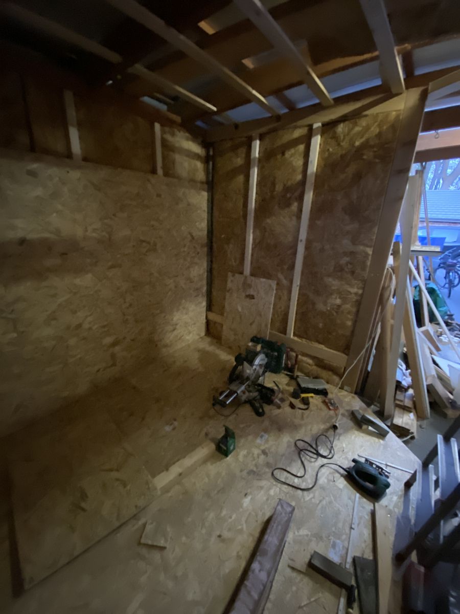

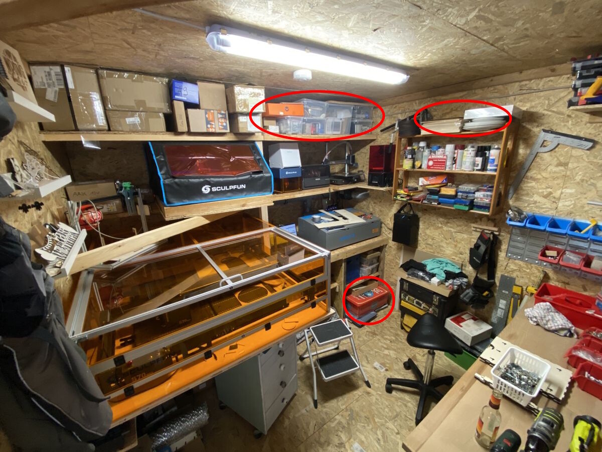

Hi everyone,
over the last few months, I was not that active in terms of new laser projects, since most of my machines were dismounted and waiting to be moved into the laser shed that I was building (in my free time beneath family and work). Now it’s somewhat finished (it will never be finished, but it’s usable :wink: ) and I can use the lasers again. Here are some pictures of it :slight_smile:
I still have some more machines that I need to find some space for, since the shed was too small from the beginning :wink: (I knew that but there is not more space available).
Features are:
  • main emergency power-off for machine power supply
  • centralized exhaust system to connect multiple machines
  • drawers at full machine size to make them usable below the desk as well
  • some automatic fire extinguishers (though still not perfect, too much wood in the area :wink: )
At this stage I’m able to run up to 6 machines in parallel from a single control laptop. But a few more might move in as well :slight_smile:

I will elaborate a more adequate comment but for now, WHERE IS THE FIRE EXTINGUISHER?!!! :rofl: :rofl:
I know you will not forget that but I have to take advantage of the opportunity while I don’t see it. :innocent: :wink: :+1:

Actually, there are four mounted, all of those that have collected over the years :slight_smile: There are two fire balls, one fluid-filled one (you can’t see it in the pictures, it’s mounted over the laptop and K40) and the extinguisher that was already spotted in the shelf, which is usually mounted at the door below the emergency switch :slight_smile:

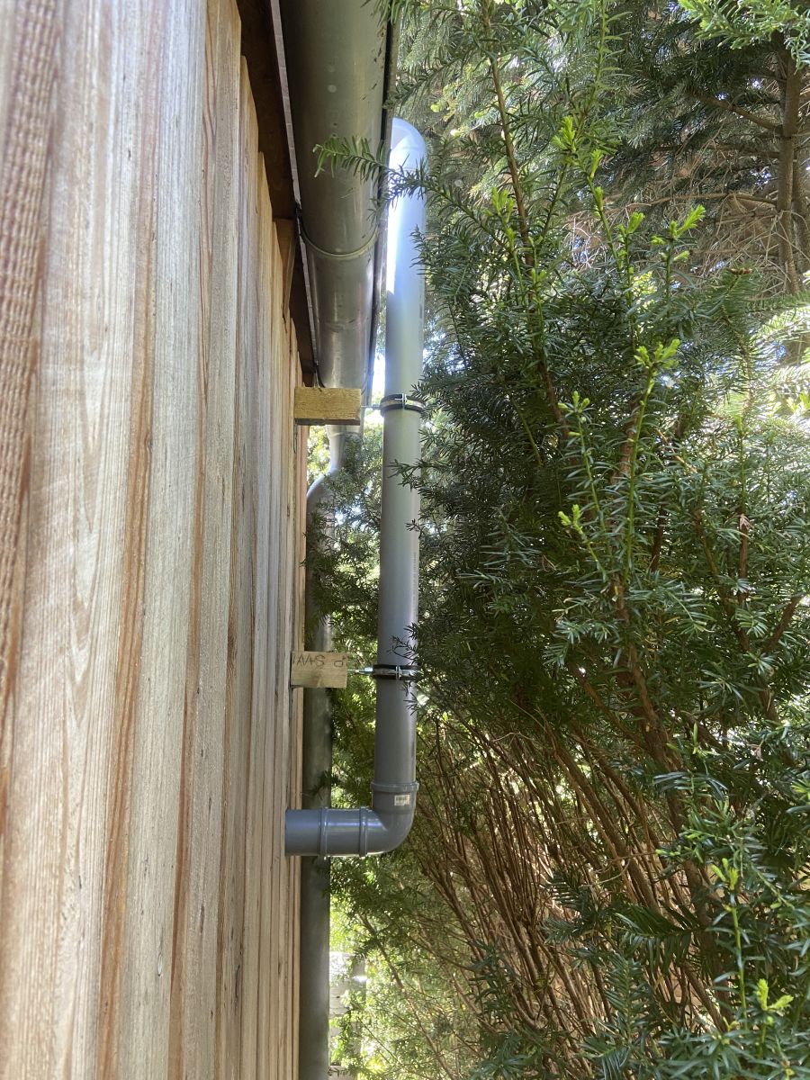

Yes, we also call it sandwich plates here. The roof of our carport is done using them. In this case they were too expensive and two of the walls were already there, so I just went on from there. Though I have 12cm insulation inside the walls (14 cm wall thickness in total), so hopefully, I can survive the winters as well :wink: But I guess it will become cold anyway with the exhaust system that sucks out 200-300m³/h of the inside air to the outside :wink:
I do not have that many materials, since I do not use the laser for professional work or mass production. I have collected a set of different materials, but only a few of each. Wood is stored on the bottom right behind the red box (the drawer is about 60x70cm in size, so also large wood plates fit in). Materials like jewelry, metals, boxes, textiles etc. are on the top shelf. And some A4 plywood that I use most is just put on the small shelf on the wall.

I knew you wouldn’t neglect such an important factor as safety! :wink:
Interesting are the ball-shaped fire extinguishers that I only know from TV series. Here in Portugal they are not used, perhaps by firefighters, but not by the general population.
With that air flow, no matter how good the insulation is, you will definitely cool the interior. But the air must be renewed and not recirculated when smoke extraction is required. The only way I can see without renewing the air and “extracting” smoke would be to recirculate the air with a filter system to retain harmful particles, which would not be cheap to maintain.]

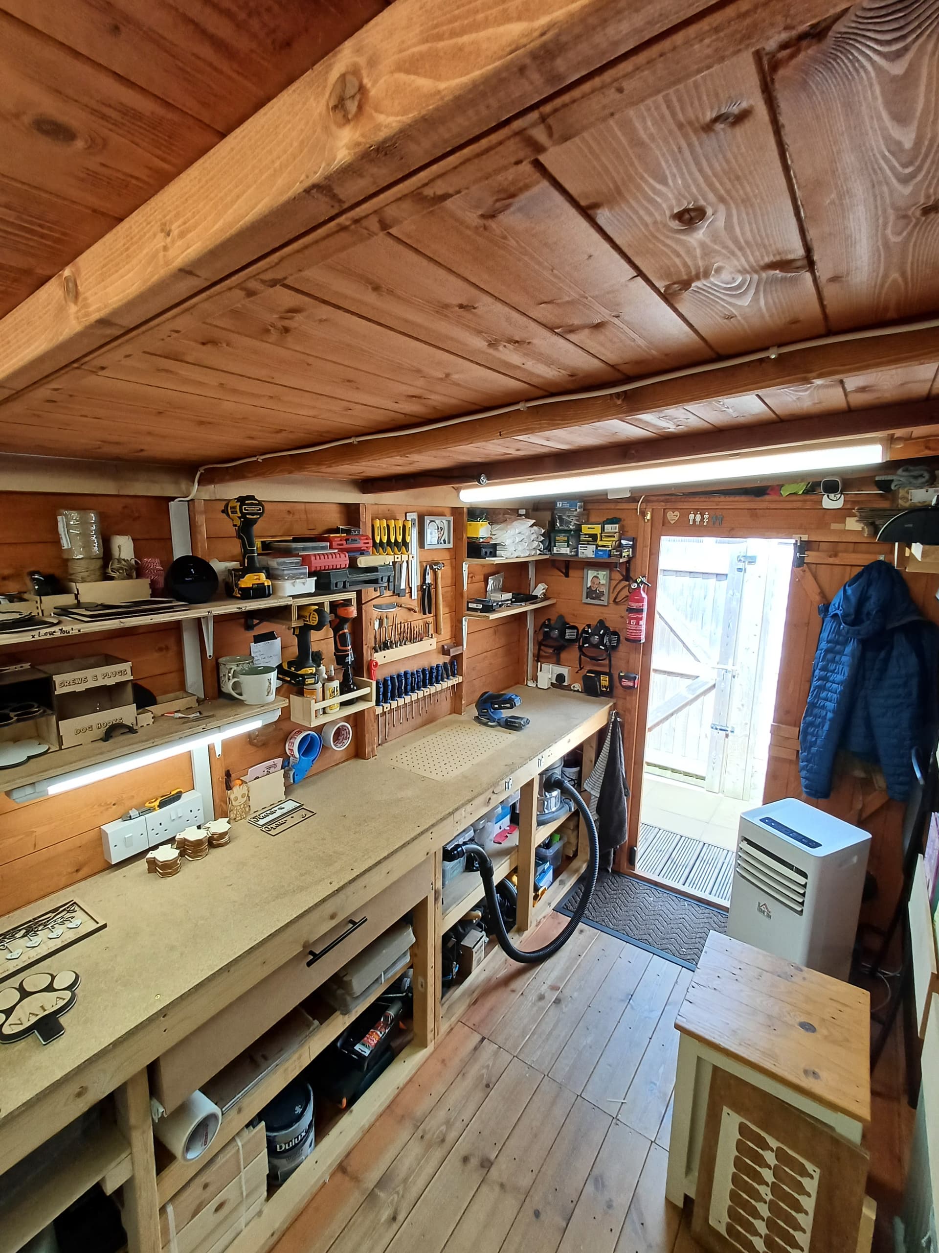

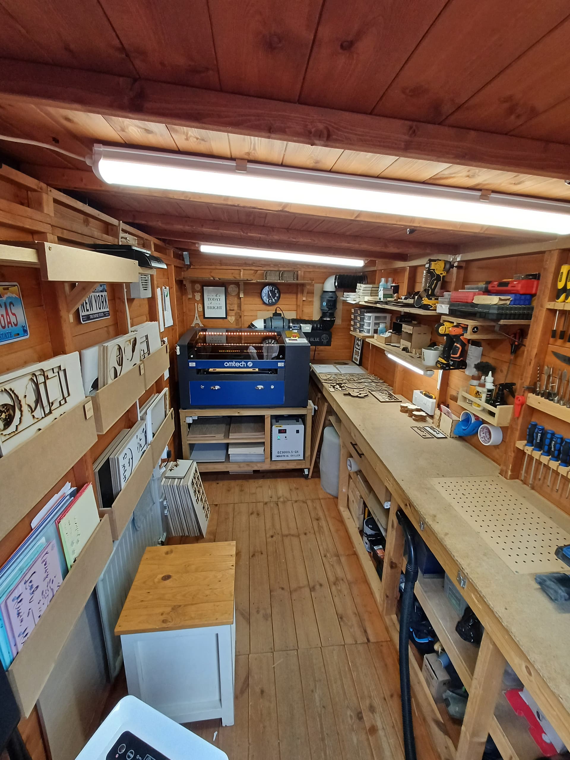

Thats my Shed set up! My 2nd home as everyone calls it :laughing:
Looks really great! (and clean :wink: )
That’s a good idea for material storage, I might need to borrow this for mine :wink:
This is most like a Shed Pro Max.
The dehumidifier came included? :laughing:
It even looks like you put wheels on the laser bench to move it when need to be maintained. Is this accurate?
Very nice home,… shed I mean. :smiley:
Thays after a day of work aswell :grinning_face:
Yeah used to have material on shelfs and was a nightmare finding odd cuts to use so had a brain storm one day and just have new material under the machine now, its even in wood type and thickness sections lol! Made from some simple 10mm MDF
Hahaha i use that as my AC in Summer!
Yeah caster had to be done, so easy to pull in and especially when maintenance is required. 4yrs of modifications but still not hapoy with it all, who ever is hey :laughing:

Yes, that’s an option :slight_smile: But I think that’s too much effort for my shed :slight_smile: What I thought about first is to use a dedicated air inlet with a fan of the same size, which would also increase the air flow inside the enclosures. Then the air extraction would be decoupled from the air inside the shed.
But since the enclosures are all different in size and position, this would mean a lot of new hoses. I planned a different housing setup in the beginning, but I didn’t have enough space to create a pile of boxes that could have inlet on one side and outlet on the other.
