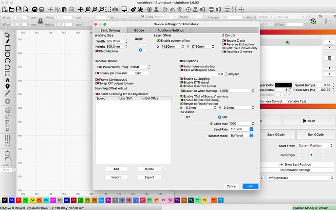

I’m encountering an issue with my AtomStack A24 Pro, which I use along with the AtomStack R2 V2 Roller. After about one hour of use, the machine starts to skip certain symbols and lines. Most noticeably, dots and finer details are not being engraved properly.
I’ve attached a screenshot showing the file and the settings I used, as well as an image of the actual result. You can clearly see where the problem occurs. It seems that dots and fine elements are especially affected, while the rest of the design comes out fine.
I’ve noticed this issue with previous projects as well, where dots and point connections weren’t engraved correctly, but other parts of the design came out perfect. Also my first silver plated rings were without any errors - they just came in with further rings being engraved.

Update:
I have just looked carefully through the first pieces and noticed that at the first piece there is a skipped dot. So it seems that the frequency of skipped characters increases linearly.
