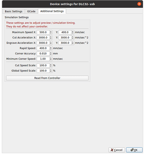

Recently I have noticed that the time that showed up in the preview as compared to the actual laser time was dramatically different. In some cases the laser took 9 times longer. Now when I went to engrave tumblers thing went crazy. My sped and setting were way off as compared to 6 months ago. I went from 4200/100 to 8000/80. But when I did the engraving the laser head just crawled, so slow that the overscan actually showed up on the final product. I have 2 Ortur olm3’s each powered by different computers. I ran the same file on the 2nd one and it ran so slow as to just about burned thru the plywood. Normally to cut the plywood I have to run at 75speed/100 power
Check the UNITS setting. Diode machines usually use mm/m.

An update. When I run a test at 8000mm/1% power time is correct. engraves at correct speed. When I change power to 80% and leave speed at 8000 it slower down to a crawl
Just ran another test at 5000/1% ran fine. 5000/50 it crawls
Did more testing this am. What I’m engraving is a image for clarification speed setting 8000 preview time 1.26 8000/1 time 1.28 25/50/75/100 power settings All times the same 13.40 minutes. Then tried just fonts 8000 speed preview time 1.57 1/25/50/75/100 power settings 4.40 minutes

Lightburn uses the Cuts/Layers settings to compute the estimated burn time. I found that the difference between computed and real increased with higher speeds. Then I am thinking, “Why!!!?”. It seems when you command high speeds, the laser cannot actually accelerate to those speeds. This means burn times in reality will be less than what is computed.

Lightburn uses the cut/layer settings to emulate the job, for this to work correctly it gets the controller values such as acceleration from the controller itself.
You can ensure that it has the correct values by clicking on Read from Controller.

It seems you think I do not know about the Read from Controller button. What you did not do is warrant the laser will behave exactly as Lightburn computes it should.
My accel and max settings are conservative, so this statement does not apply here. What you describe would surely result in a failure of positioning accuracy, which did not happen here. I am pretty sure if the motor loses half a dozen steps, known as “cogging”, it will be noticed.
My tests were done with an i5 PC and a 32 bit controller. It is very unlikely a streaming bottleneck would occur. If you think something else is happening, an opinion would be welcomed.
If I assume you’re PC and controller are fast enough, then the only possible bottleneck is the serial connection…
If your machine slows down below it’s specification, something is wrong with it or it’s specifications. You have enough computer power at each end of the usb, the only thing left is that serial connection.
How big is the command buffer in your laser? Usually it’s only a few instructions.
