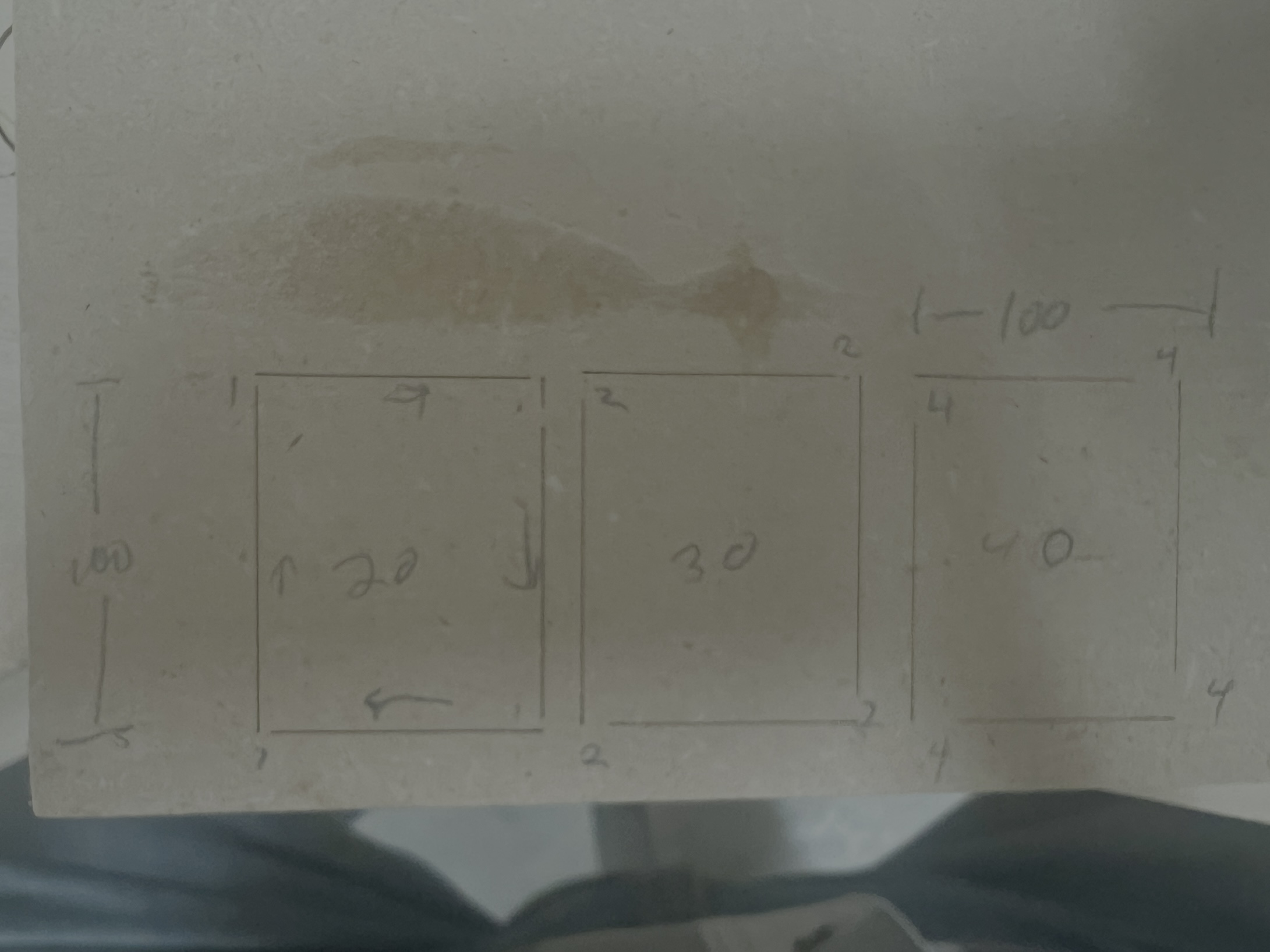

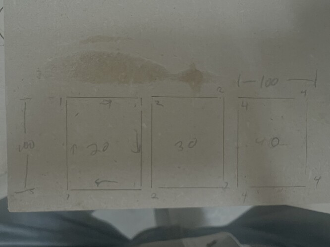

I have a Lowrider 3 with a Neje A40640II controlled by and SKR Pro running Marlin.
If I run at 10mm/s or below, life is grand! If I start speeding up, I’m seeing gaps a the end of lines. These gaps grow as speed increases. It also appears that the start of the line is darker than the main part of the line. If I draw a 100mm x 100mm square, the gap is at the end of the line in both X and Y, regardless of direction. The image contains 3 identical squares. I’ve noted the direction of travel which is the same on each. The gap at 20mm/s is about 1mm increasing to 4mm at 40mm/s.
Any clues?
Thanks,
Steve

So it most likely has achingly slow acceleration. :grin:
This Troubleshooting section seems relevant:
You can try cranking up the acceleration, but you may be stuck with very low speeds due to the combination of large moving mass and small-ish motors.
You may be right. I started cranking the acceleration up and as I did, the gaps got smaller. I’m suspecting that 40mm/s is more that my machine can handle mechanically as I was getting some ringing at that acceleration rate. 20mm/s looks very doable. Thanks!
