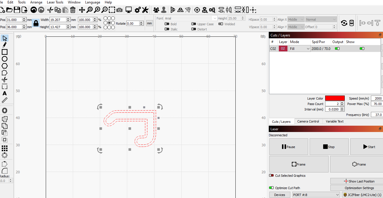

Hi
i changed computer (export the parameters from the old computer).
The software doesn’t see my laser, it shows as “disconnected” even if it sees the connection on port 8.
I tried to add my device manually, still doesn’t work.
I also disabled the power usb windows settings.
can you help , thanks

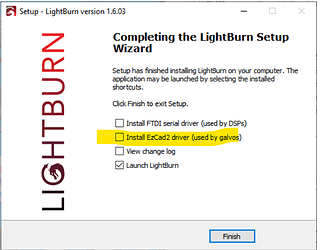

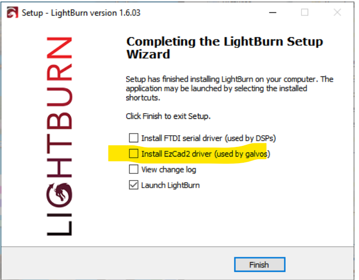

Hi Jerome,
You’ll need to perform the driver swap in order for LightBurn to talk to your laser. Follow our documentation here on how to do that: Galvo Driver Installation - LightBurn Documentation
Basically: re-run the LightBurn installer and make sure to tick this box to “install EzCad driver” in the last step, before clicking “Finish”:
We also have a video showing the process here: https://www.youtube.com/watch?v=YbzSO20bSuA
Finally, if neither of those methods works, try doing the Zadig driver swap, as explained here: Zadig Driver Swap
