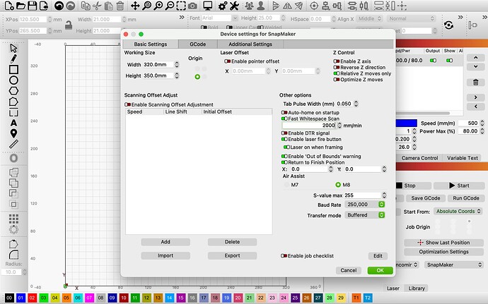

The laser on my Snapmaker will come on to frame the project. When I start the engraving job it stays at the low power setting and does not increase to the 70 or 80%. It will run the job correctly just at the framing power setting. I’ve tried a number of things in different posts but have been unable to increase the power.
There is a Snapmaker specific device type. Make sure that’s what you are using. Your profile implies that you’re configured to GRBL.
I’ve tried using the Snapmaker device type and used the find my laser both are doing the same thing.
Can you provide the following:
  1. Screenshot of Edit->Device Settings

From what I can tell the gcode looks okay and I don’t see anything in Device Settings that would prevent this from working.

Thank you for your help I figured it out it was the latest update to the firmware. I went back to the previous version and everything works now.
