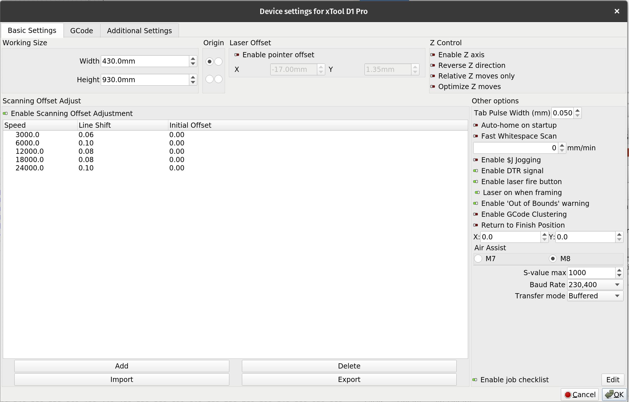

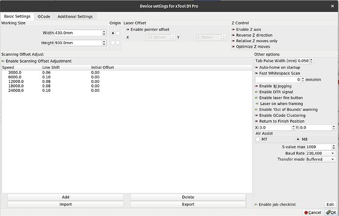

  4. Take screenshot of Edit->Device Settings and post here

It did it again. Here are the things you requested.

I don’t see an issue with the gcode. Your Device Settings seem okay.
