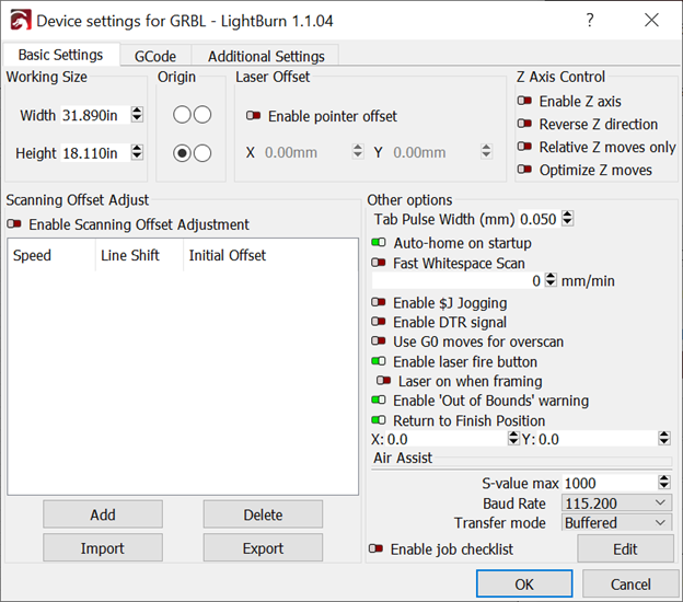

The laser stopped firing after a Lightburn update. I’m sure it’s a setting I need to adjust but I haven’t been able to discover which setting to change. The laser still works and I verified this by using the NEJE software. Any advice on what setting to update?
$30, $31 and $32 all look right to me.
Click Edit, wheel all the way down to Device Settings and click that one.
Make sure S-Max = 1000 the same as $30
Thanks for the quick response. It is currently set at 1000. Thoughts on other settings or other pieces to check?

Thank you John! That seemed to work. Do I need to do anything to save these settings?
They seem to be automatically saved whenever there is a change.
