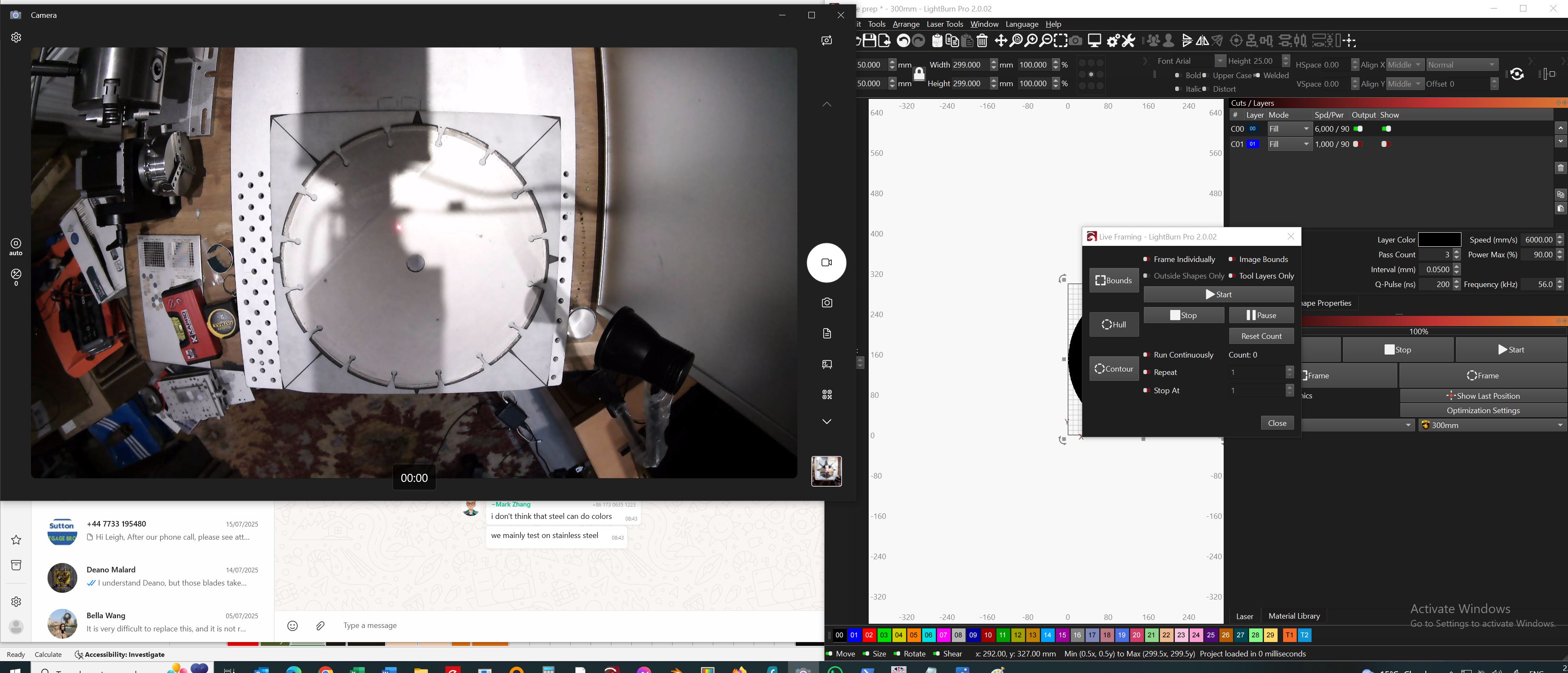

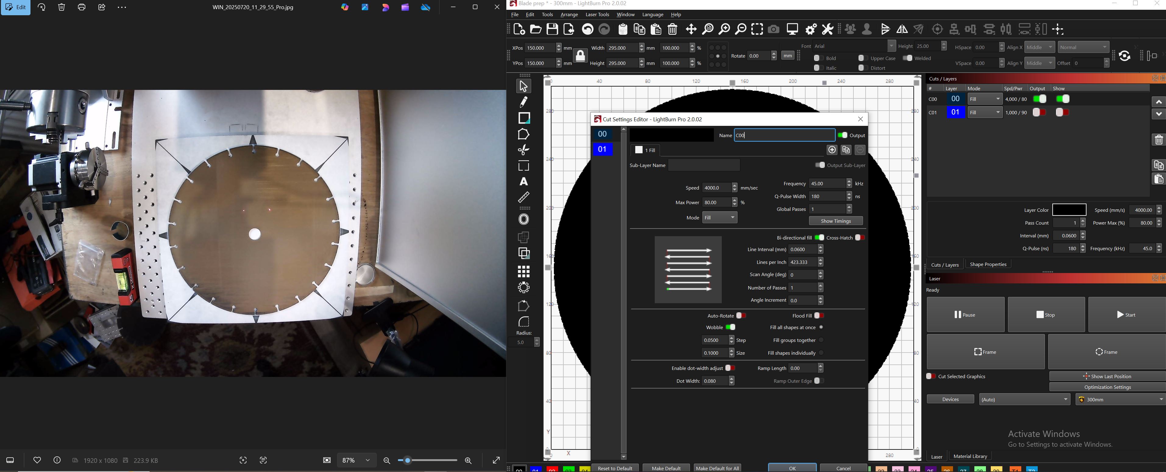

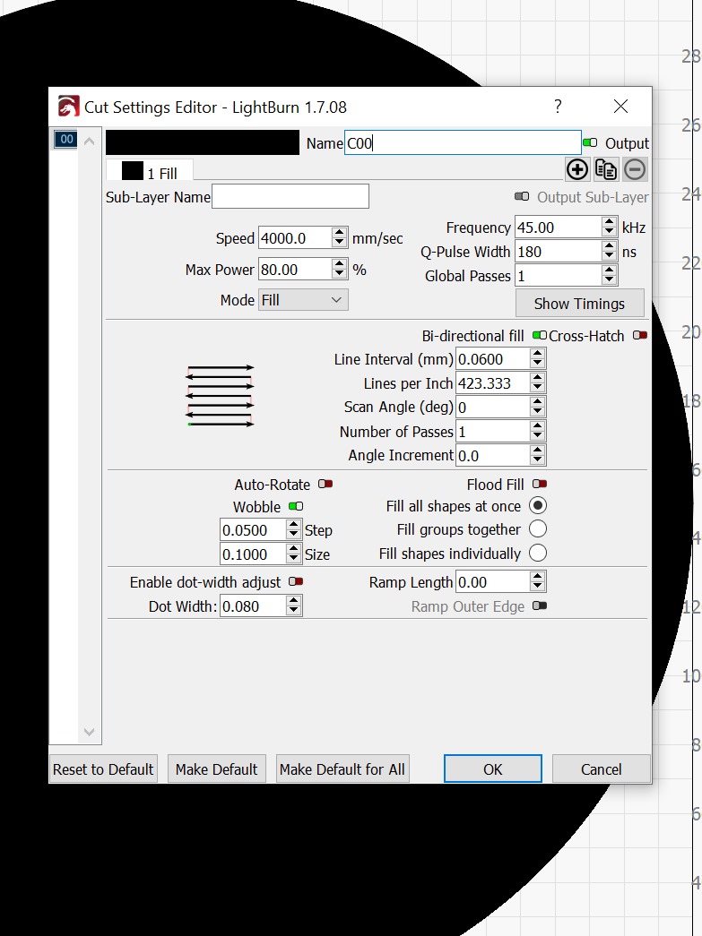

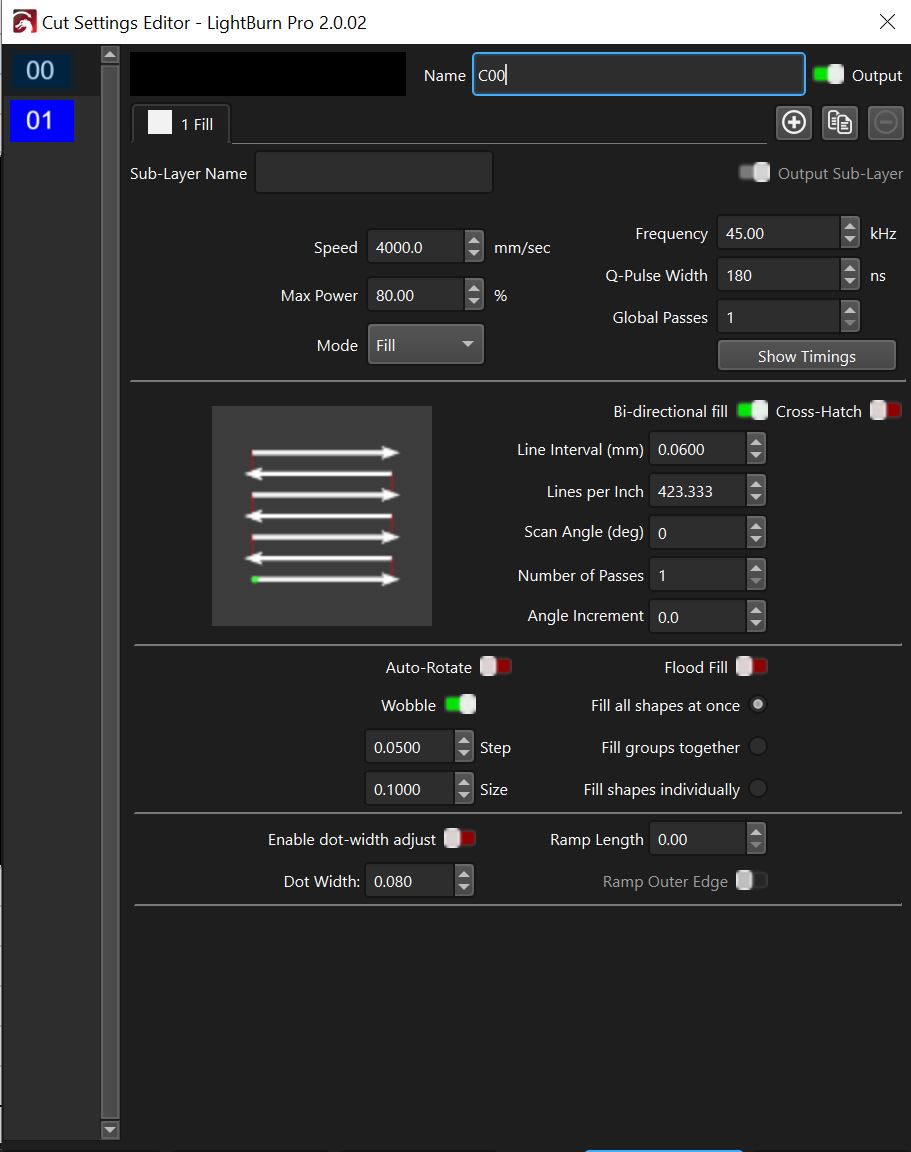

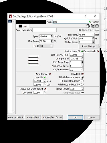

I have a Haotian 60W fiber mopa laser, and have a probelm with the laser stopping part way through jobs, and wondered could this have something to do with lightburn?
I recently updated to the new version: 2.0.01 but for several reasons at that time I rolled it back to the previous version: 1.7.08
Please see pic of most recent job, it had already stopped part way through 3 previous times
Any advice very much appreciated

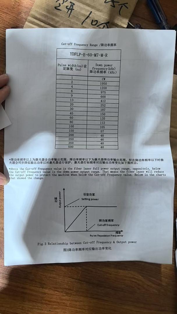

PS: I was recently provided a q-pulse chart for my machine, but I do not fully understand what this means and could my settings here have something to do with this problem. Can anyone advise what this chart means?

This is a complex topic and not really easy to understand. But in general, this chart gives you an idea of the minimum frequency that you can choose before you reduce the power of the laser. You can imagine that the laser needs to be “loaded” with power before it fires. The longer the pulse width, the more time it will use to charge, and if you have a low frequency, it does not get loaded fully before it fires.
This is not related to your problem; this is only another factor you can use for adjusting the power of the output. If your frequency is below the “down power frequency” for a given pulse length, then you will just have less than your nominal laser power as output.

As with all circuits and systems, it takes time to pump up a fiber. Frequency determines pulses/s, higher frequency mean more pulses/s.
During a pulse, the seed diode controls when the energy in the fiber is released and it’s duration or q-pulse. Q is just a fancy term for a change in how well a signal is resisted or blocked. Hence the terminology of Q-switch the Q at the end of the fiber is switched to a low impedance or low Q, to allow the pulse to be released. While this Q remains low, energy of the fiber is released. Most of these pulse in the area of about 15kW, however a MOPA can change the Q pulse shape. This is from my JPT YDFLP-60-M7-L1-R User Manual-20191202.pdf.txt. It’s a pdf, so remove the .txt extension.
How long a fiber takes to pump up is based on it’s power rating, hence a 50W fiber will take twice as long to pump up than a 100W fiber… Output is similar, but the 100W allows more pulses/s, because it can pump up the fiber quicker allowing more pulses at higher power.

The problem seemed to be - I had the wobble enabled, and it ended up several times crashing lightburn. If it did not crash it, it would just stop the laser and it would need to be restarted. Once i disabled the wobble, it stopped the problem

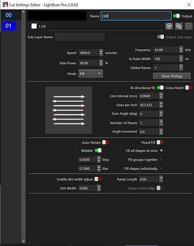

Did the exact same process and settings (with wobble enabled) as previously, but with version 2.0.02, and it completed without problems, so it seems the problem was with the previous version 1.7.08

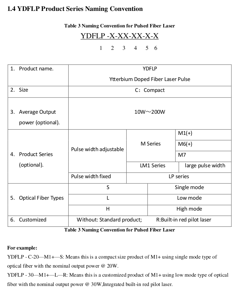

Hi again, just started to read through briefly the [JPT YDFLP-60-M7-L1-R User Manual-20191202.pdf you posted earlier, and it looks very interesting. I was just wondering, would you know - how relevant is this manual to my machine - Haotian 60w fiber mopa laser? and is it usually normal for the manufacturer of a machine to provide this type of information when purchasing initially? I was only provided an EZCAD manual and a Unboxing-and-initial-setup-guide, but nothing else. Is there other documentation I should ask the manufacturer for?
Is a pretty standard fiber source. Most of these machines only have one of around three manufacturers. Mine is this model.
In the model means it has other specifications. You can find the breakdown of each variant in the manual.
I’d say Haotian can answer that better than I. If you have this model, then this is the manual and it applied directly. It’s pretty simple to ask Haotian laser what model was put into your machine.
I’ve also head of others sending the model/serial number to JPT for a more specific information pertaining directly to your model.

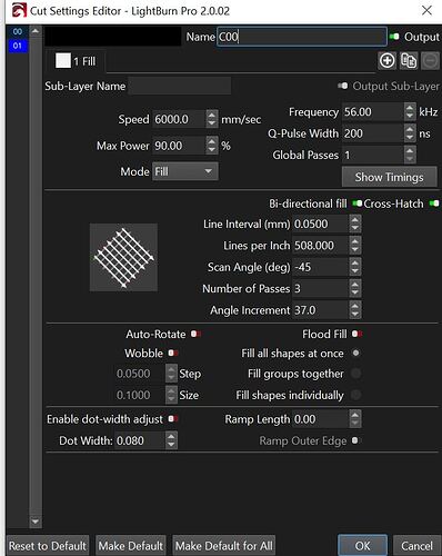

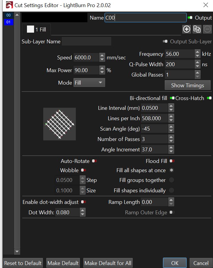

Just running passes (3 passes) and its stopped again
Any suggestions what is happening, is this software or my machine? Or, have I simply got my setting wrong?
Running most recent version 2.0.02

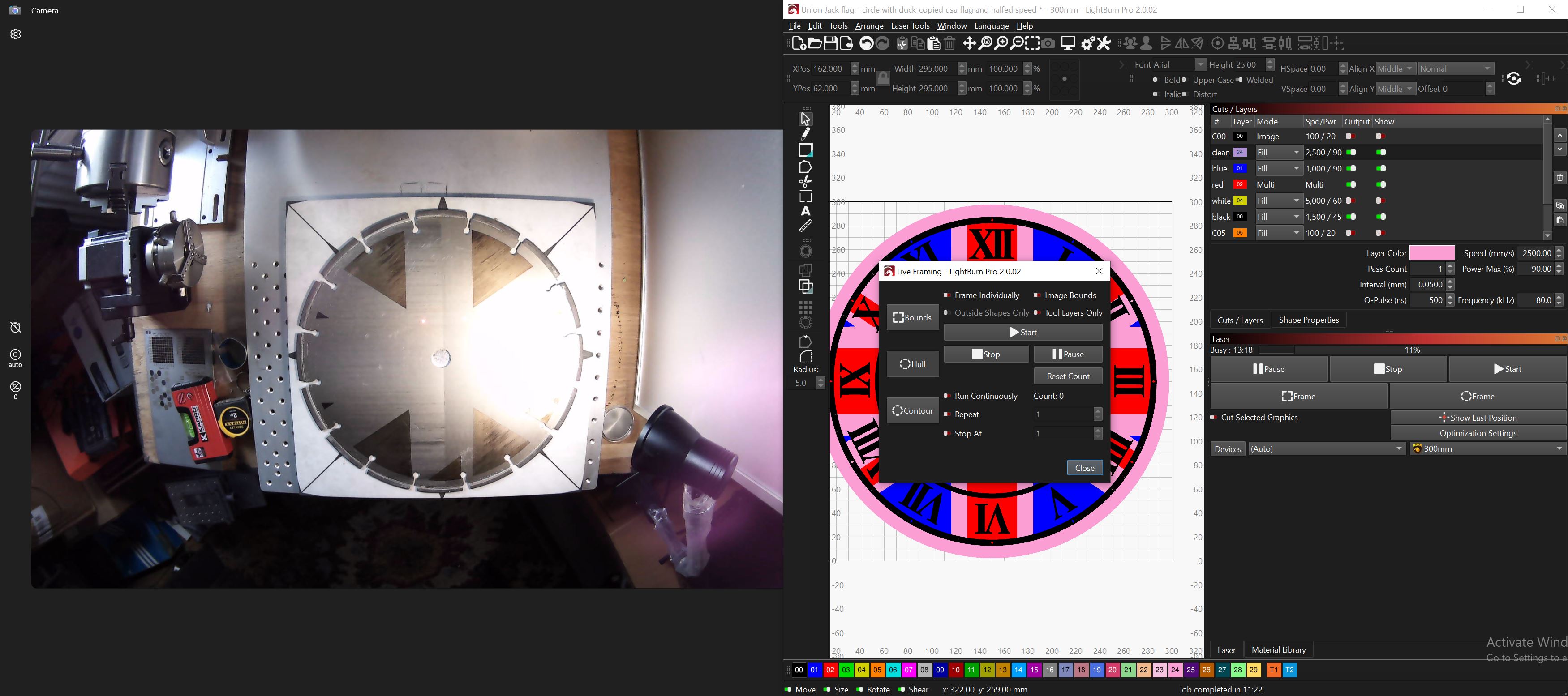

This is not the reason in my case. My camera will pick up even the lowest settings when the laser is working, even if you cannot see it with your eye. Lightburn does not recognise that the laser has stopped working and the % of job keeps moving, after a while if left untouched the laser starts working again (picture shows the first layer has stopped half way through then started again on the second layer, brown in pic)
Im informed from the manufacturer that with a 300mm lens, engraving upto 295mm I must use slow settings, as in this case 2500mm/s / 90% power is too much, and I suppose to stop any damage to the machine, it shuts down, until it can safely start again
This seems to make more sense and seems to be what is happening, I do wonder if this is normal though?

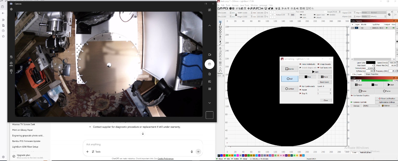

You can see on my picture posted previously the right side of blade upto the middle is where it was marking, but then it just stopped, and the red led line just continued where it was supposed to be marking but obviously did not. Im guessing it just over heated, and then, by the time it came to the second layer it had cooled down enough to start and mark again
