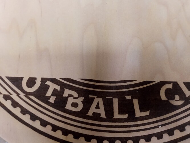

Hi There,
I have a blue and white Chinese laser that is about 2 years old. It’s been a workhorse.
Lately though I am running into this issue…
  • 275 mm/sec
  • Zero scan angle
  • Power 20%
  • Belts tightened
As I do a burn (Vector Image) the machine will start fine but after a while (random) I get a pause, stutter and shift on the X axis. It will lose its position and keep going. Obviously screwing up the burn (pic). This only happens on the X axis.
The weird thing is this… Using the same settings and same design, if I change the scan angle to 90 the results are perfect. I don’t get it. lol
I have adjusted the belts, checked for bad, cut and loose wires. I also changed power supplies.
Why would it run perfect on a 90 degree scan angle but not at 0?
Any help would save me a bunch of drinking! Thanks!

The Ruida ‘knows’ the overscan and would have advised you of an issue there. Since it’s a ‘workhorse’ I will assume the configuration is ok.
It looks like a hardware issue, either mechanical or motor/driver area. I’m dubious it’s a controller problem at this point
This is occurring on the X axes, so changing the scan angle would only exercise the Y axes for scanning and that seems to support you have an issue with the X axes… Probably motor or driver circuits.
It definitely lost steps… strange it lost a lot all at once.
Were you watching it and did it stutter or anything?
Is is reproducible at the exact place? I bet not… if so, we could be on the wrong tail…

Changed my USB cable after getting an error on the Ruida display. I don’t remeber the exact text but something like “can not find usb”.
Also while cleaning my laser nozzle, I notice a few “rough” spots on the top of the gantry, where the nozzle bracket slides. I cleaned that up and smoothed it out too.
After doing this I ran 3, 45 minute designs at a speed of 300 with a 0 scan angel… All 3 burns worked flawlessly. The problem now is that I don’t know exactly what the problem was. The USB cable or the roughness on the gantry. LOL
I am leaning towards the rough top of the gantry. I am also wondering how it got that way.

I’d bet on the ‘rough’ gantry. It’s always good to move them around so you know how they feel. When something goes south, it’s nice to be able to say ‘that doesn’t feel right’…
You took the right steps and solved it…
