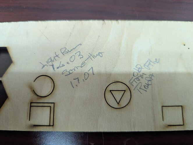

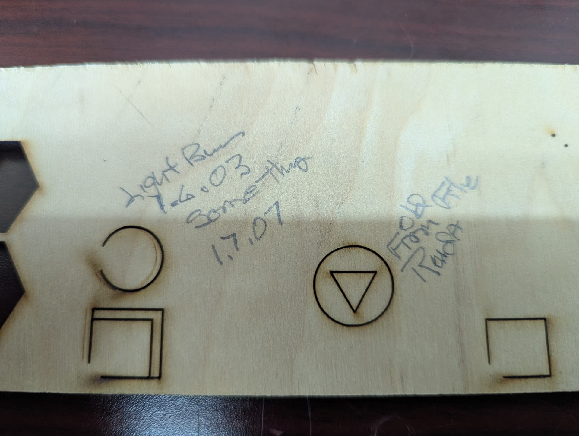

Laser stops cutting just befor the end
Attached are some photos of the problem. The photo with the squares and circle you can see the place the cut stops. On the cut with the circle and triangle (old file that is stored in the Ruida) works fine. When creating the file that don’t cut correctly you can see in the Ruida screen that it is missing the line. I have changed the USB cable with no improvement. I also cut some existing files and they work fine.
Has anyone run into this problem before?
Chinese 50 co2 laser
Ruida 644XG
Device Profile 6-14-22.lbdev
Settings 2-26-25 .lbzip
Windows 11 Pro mini-computer running the laser for about a year.
I haven’t seen this problem before. Can you post the file you’re having problems with?
Could the settings have “create tabs” set? Could that be a tab?

Your correct, I didn’t know the tabs were set (can’t see them) but that was it. I thought it was the PC but I’m happy now - THANKS
