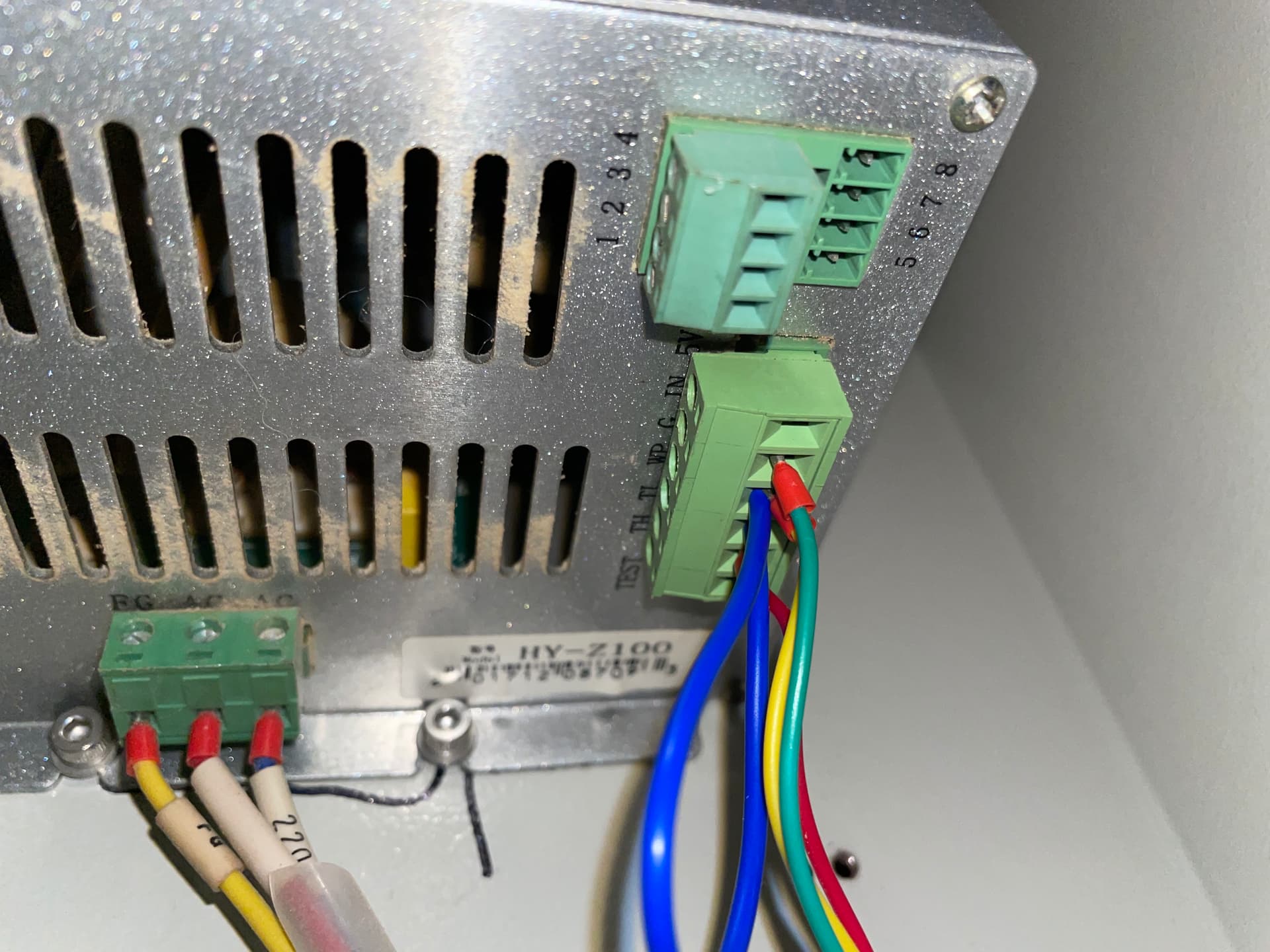

  1. If you have moved the chiller alarm to the controller, then on the LPS there should be a jumper between the WP and GND contacts. Check that this connection is secure.
  2. If your laser has a laser pointer on the nozzle, check to see if it goes off at the same time as the laser tube. On Chinese machines, laser pointers are usually powered by LPS (+5V). Its wires are of poor quality and become bent over time, which leads to a short circuit and tripping of the LPS protection. To test this theory, you can temporarily disconnect the laser pointer wires.

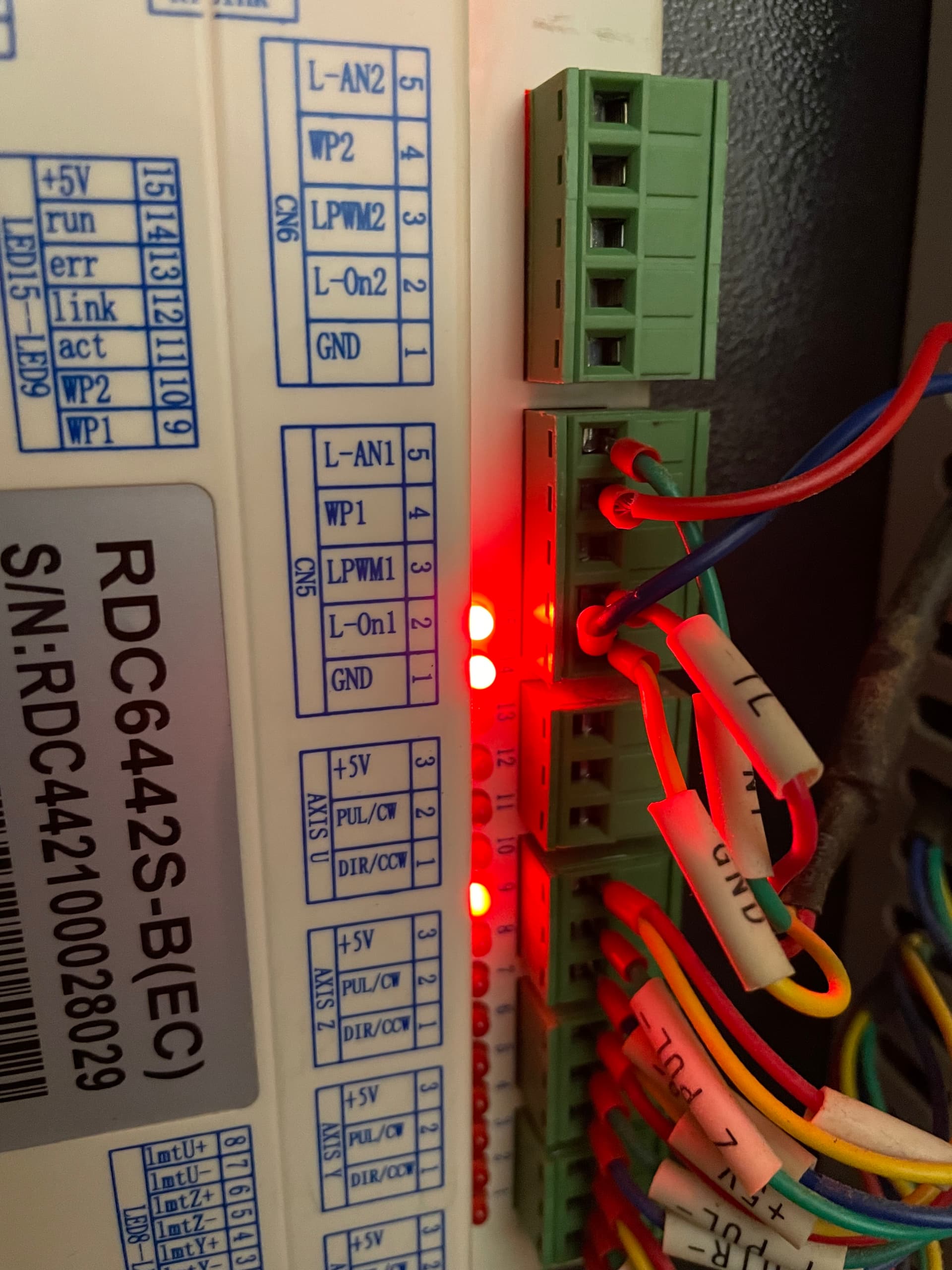

OK, I have got myself a digital multimeter now!
I’ll add some pics of the connections that I believe are the ones I should be looking at, which are listed below.
L-AN1 on the controller is connected to IN on the lps (green wire)
WP1 and GND on the controller go to the chiller. (red wire and blue wire)
L-On1 on the controller goes to TL on the lps (red wire)
GND on the controller also goes to G on the lps (yellow wire)
Lastly the lps has the blue loop going from WP to G.
Does that all look OK? Pics of the lps are a bit shoddy sorry - its in an awkward spot to get at.
How am I best to go about testing all these connections?
Thanks for that! Yes I have got a wire going from WP to G on the lps.

Yes, it looks fine…
It is working, but it fails midway through the job. This would indicate all the connection are correct and it’s got to be an intermittent wire or a failing controller or lps.

Ok so I have done some testing - I couldn’t access the terminals on the LPS easily which was annoying, I will need to do more of a garage reshuffle for that, but for now I have taken some readings off the controller terminals which should at least confirm that that is sending the right signals.
Readings are as follows
At idle
L-AN1: 0.00-0.03V
L-ON1: 4.26V
Running (working correctly) at 50% power
L-AN1: 2.66V
L-ON1: 0.24V
Running (once issue has occurred) at 50% power
L-AN1: 2.67V
L-ON1: 0.24V
So that all looks like its correct to me.

I also checked the test button on the power supply which did the following:
Running normally with wires plugged in - no laser
Running normally with wires unplugged - laser would fire
After laser has dropped out, wires plugged in - no laser
After laser has dropped out, wires unplugged - no laser
Im thinking maybe the lps has some sort of fault?
These signals, from the controller, tell the machine to lase, this would indicate the issue between where you took the readings and includes the lps/tube.
I’ve got my money on the lps… doubt you have faulty wires between the controller → lps … easy for you to check.
I’ve never seen a tube do this, but I’ve been surprised before.

Usually when a tube goes, it fails to conduct and the lps voltage goes really high, enough to punch through the hv wire insulation.
Since that’s not occurring, my best guess is the lps…
These are hard to test, as you’re dealing with 30kV of potential.
