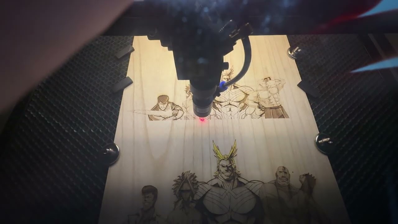

I don’t feel like it’s fail elsewhere, I feel like the controller has just frozen. In the “paused” but showing “run” state, I can select stop and the machine will move the head to the home position. I agree the stepper drivers don’t send position feedback back to the controller, but the controller is still able to move the laser head back to home without crashing which means it’s assumption of where the machine is is correct.
Motor drivers are fine as they drive the head when I select stop.
I uploaded a video to youtube at the following link, shows what the machine is doing below.
I do have a meter for doing some measurements. I can also confirm this has been happening to multiple different jobs of differing lengths, but it seems to only affect jobs that last longer than about 20 minutes. And only fails at about the last 5 to 10 percent of the job, i.e. a 22 minute job failed with about 2 minutes left and an hour and a half long job failed with about 10 minutes left.

It seems to be a heat issue, but it doesn’t make sense even though both of them fail within 10% before the end of the run..

I am doing a couple more tests on my end and will get back to you with the results, specifically if the same job fails at the same point exactly or if there is a window where it fails. Secondly I’m going to run the job with the laser turned off and see if that affects it. Thirdly I’m going to try loading the job on a thumb drive to see if excluding the network and the bridge has any change.
Will let you know with an update to this thread.
Another possibility is the Windows USB energy saver setting.
To fix USB disconnection issues in Windows 11, disable the USB battery saver toggle in your system settings or turn off the power-saving feature in the Device Manager. This stops Windows from cutting power to your external drives, mice, and keyboards to save energy.
