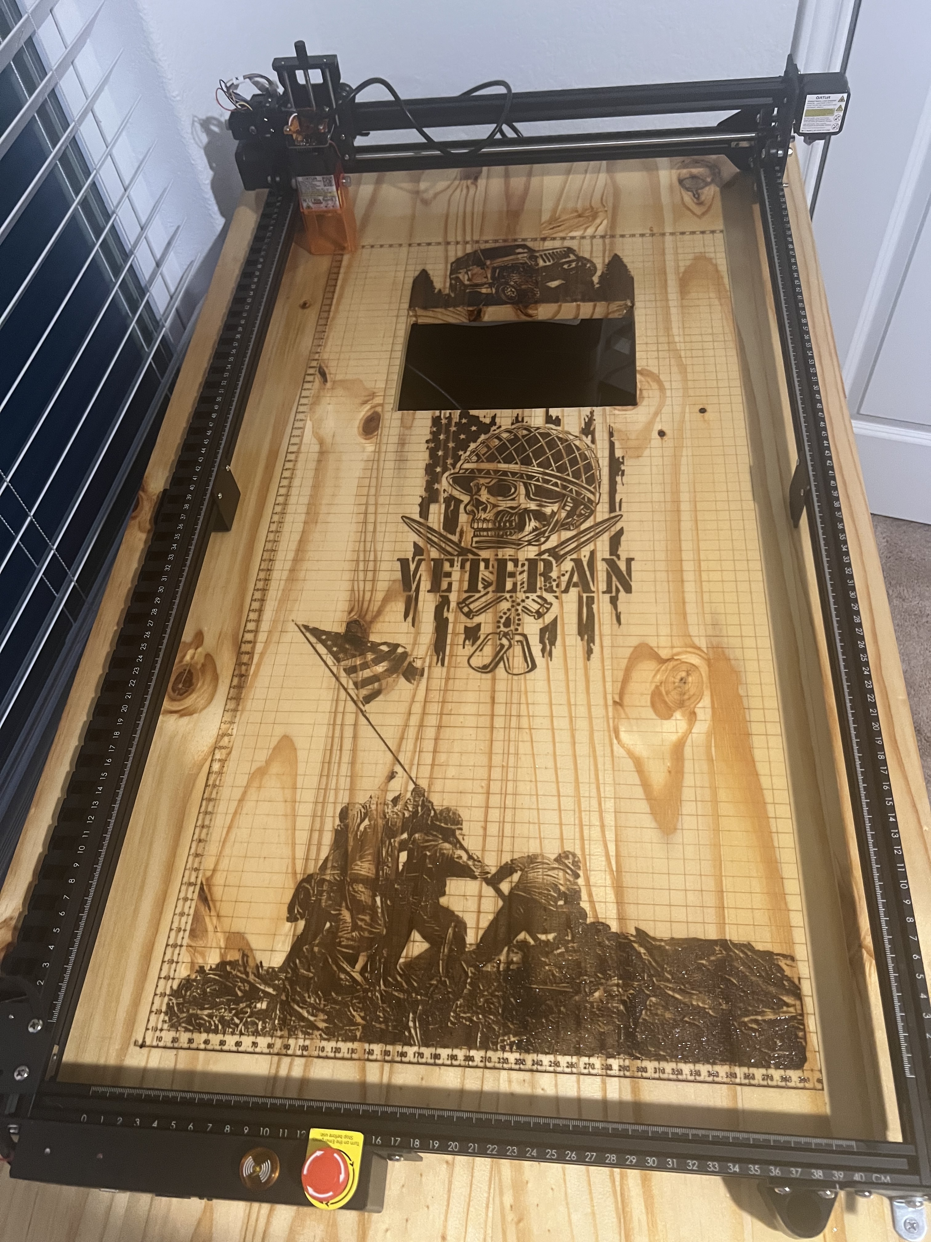

SO for the past 2 days I have been trying to do a burn that is 784.9 y by 399.9xon my Ortur Master Pro 2 S2. My work was framed perfectly each time i checked. When it came to the burn it initially did from 0 to 60mm then stopped. I tried the same burn 3 times, and before each burn I framed my work, and after framing, I called it home to start my burn. All 3 times stopped in the exact same spot. I checked every last setting and made sure none of my USBs would go to sleep. Nothing worked. So I got a bright Idea to CUT my image to exactly where it stopped and do a new burn. Again I checked everything and framed my work and everything was good to go but this time it only burned from 60 to 70mm in Y Just 10mm of burn that was it but again stopping in the exact same spot. Lightburn showed it was still streaming while the laser itself was shut off but not the Ortur board… Those lights were still on. So after 3 tries on that I decided to try out LaserGRBL. So far so good its almost done except some of my burn is not showing up. I mention that because I really do not want to hear its the LASERS FAULT, because its not its Lightburn. I have seen other posts with the same prob and all the Lightburn/Ortur product people post its the laser not lightburn which in my case it is proven to be Lightburn. So How do I fix this???

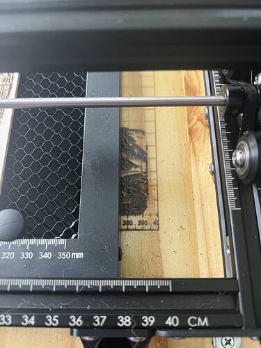

So Yeah its still a no go at this station… Still stops in the exact same spot around .230mm to 235mm. Laser GRBL just rolls through but burns higher. Any suggestions to try and fix??
Can you take a photo of the burn?

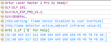

Also, are you getting any sort of error when this happens? What does Console show?

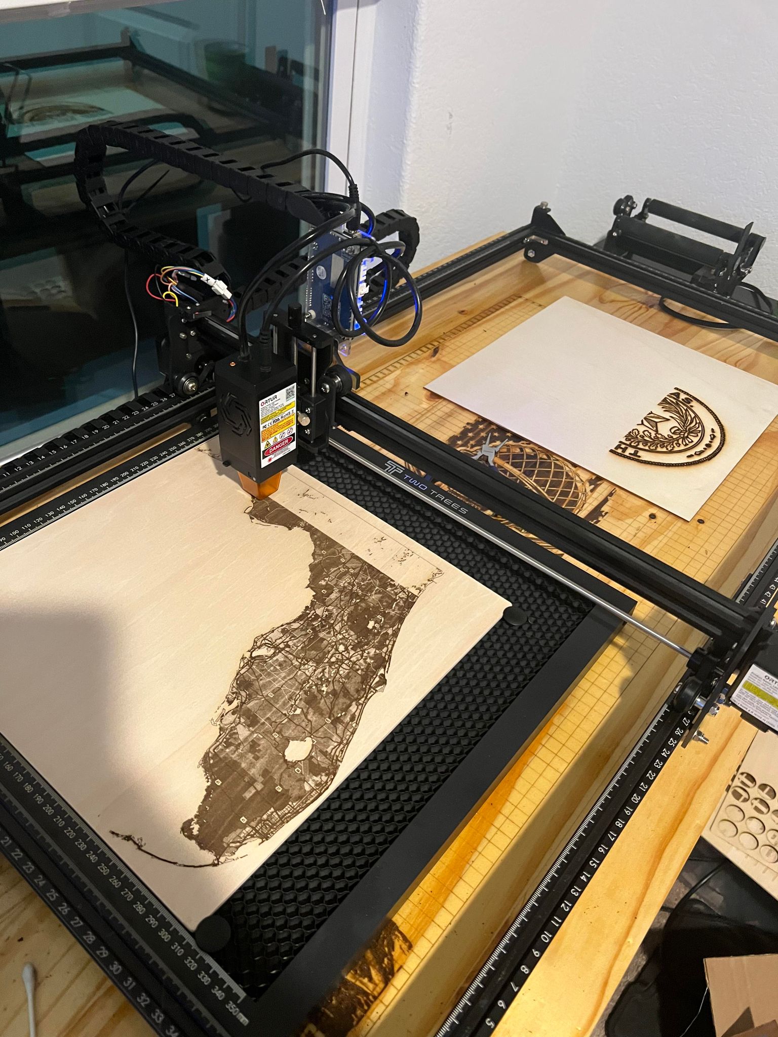

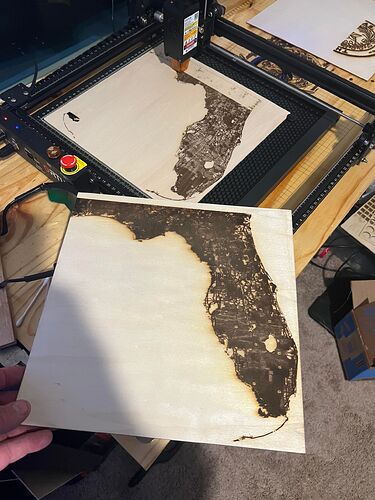

And like I said before, Lightburn shows that its still going but the laser has stopped and as you see in the pic it is the same spot as always. I did delete Lightburn from my computer system and tried to find and delete all associated files and then I reinstalled before receiving your message.
Also if you notice in the pic the full outline that was before doing the etch just to see if it would give me the full board which it did. I have a full burn from LaserGRBL from right before using Lightburn which came out a bit toasty

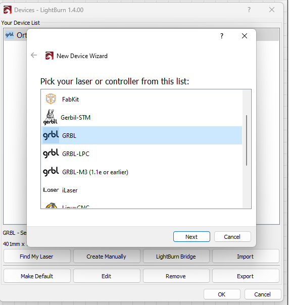

A few observations:
  1. You are using the incorrect device profile. You are using “GRBL-LPC” but should be using “GRBL”. This may be an issue with auto-detection. Push Devices button in Laser window, then click on the name of your laser, then Edit. Then select GRBL. Complete the wizard.

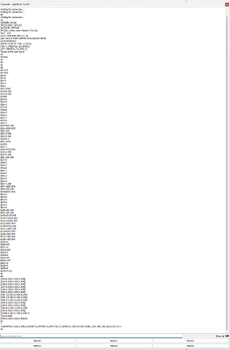

Can you review and also provide the following:

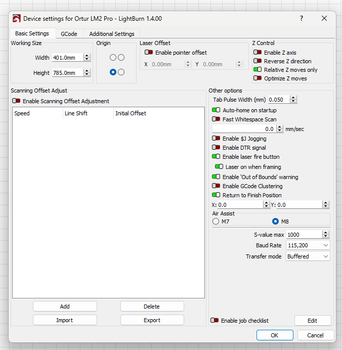

  1. screenshot of Edit->Device Settings
  2. output of these commands in Console:
$H

Can you take a screenshot of Edit->Device Settings?
Device Settings looks mostly okay but with a couple of oddities:
  1. the width in device settings doesn’t match your machine. 401 vs 400. Is that intentional?
  2. 400x785, is that the expected dimension of your laser? I was under the impression that the OLM2 S2 with extension was 390x800 from what I’ve seen online.
No that was an error on my part its back to 400 x 785. And yes the 400 by 785 is what I checked over before adding the numbers in when I built my board.

What does it show in Console when the job stops? What do you need to do to recover from that point?

See what gets me is it’s only happening on a full etch after I changed from the 400 x 400 mm frame to the extended 400 x 800.

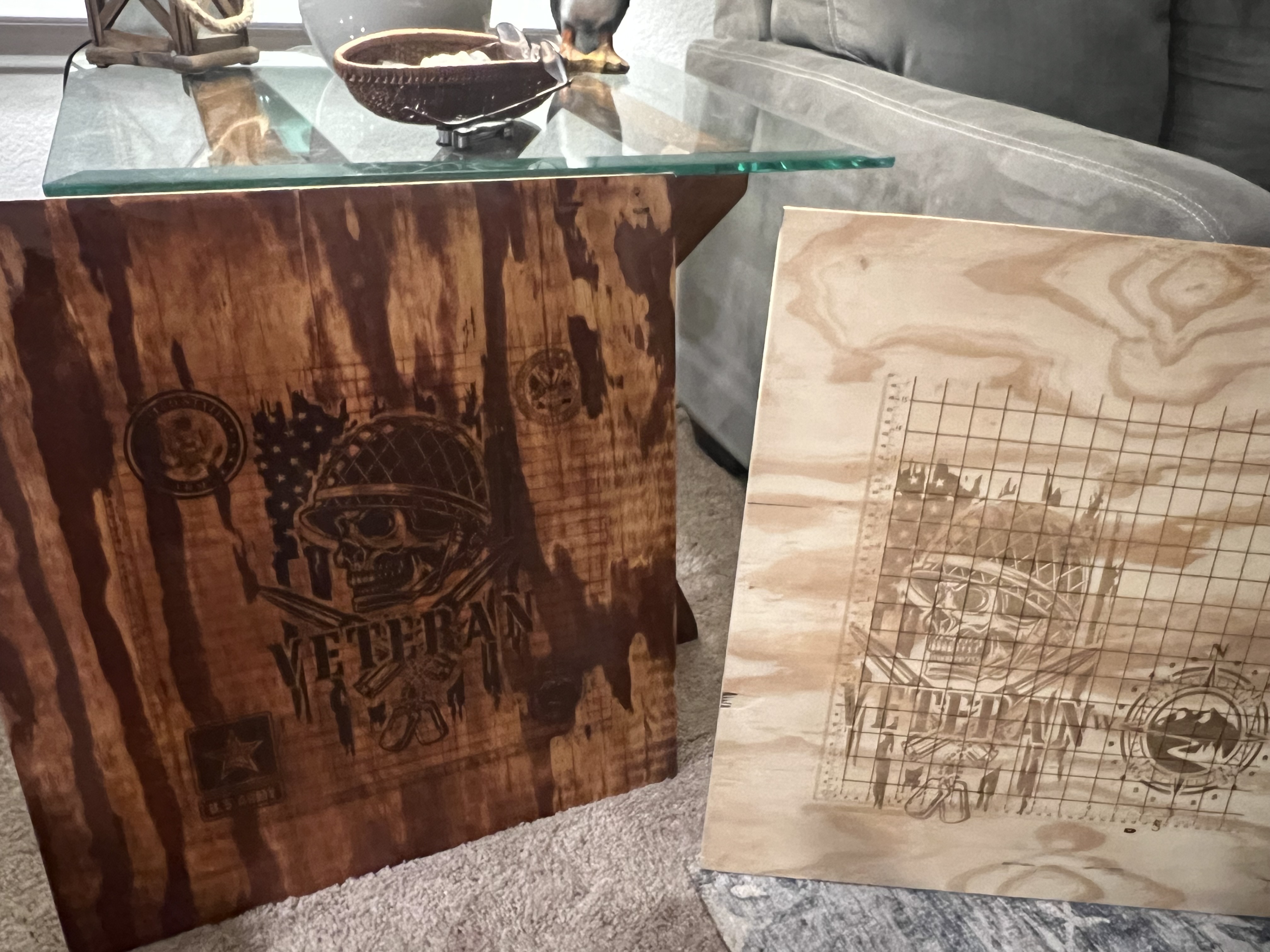

When I did the trace and burn of the Florida I sent you it was just fine. Did the framing and then burned the trace. With static - static usually is a stop and not in the same place. This literally always stops same place. Again it’s only happening an a etch which perplexes me. Tomorrow I’m going to try and cut the trace. I’m also perplexed because I had no problem initially when I did my ruler board I have the frame on.
