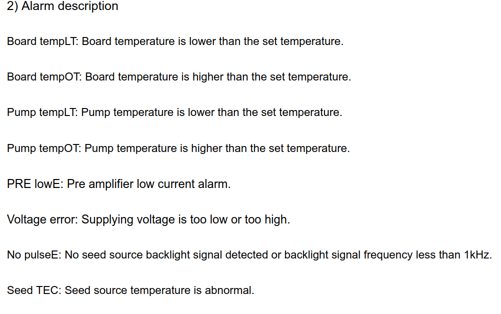

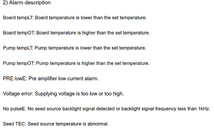

There are 2 overtemp alarms and some more exotic ones- “No pulseE, PRE lowE, Seed TEC, and Low voltage” I don’t pretend to understand what they are other than the “low voltage”. And LB has no connection to see these signals, either. LB can’t currently read any of this error info AFAIK so we’re operating blind.
On my I have indeed seen what I think is the same thing on my YDFLP-E-300-M7-M-R. At high freq, the beam just disappears for a moment and then comes back, only to disappear again, and the period doesn’t seem too regular. This went away when I reduced the freq for a given q-pulse type. I haven’t been able to get a manual yet for my YDFLP-E-300-M7-M-R yet and there’s no copy of it online so I have no chart to go by here. And also I can’t say with confidence how to read a chart either, yet, if you did have one.
But I THINK the behavior we’re seeing- beam cutting in and out at high freq- is a normal protection circuit kicking in, and there’s nothing wrong with the laser. AFAIK it is not hurting the machine, the machine is doing the cutoff to make sure it’s not going to get hurt.
