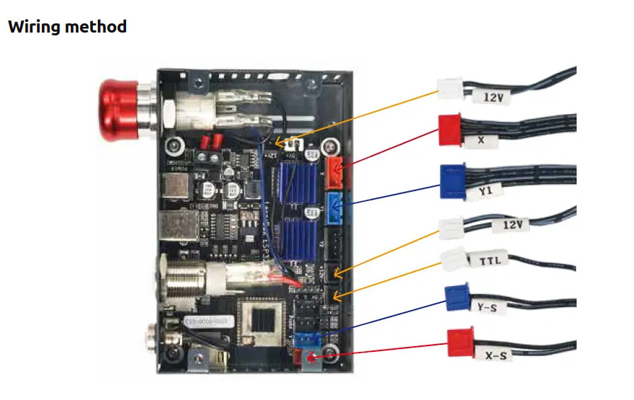

I am considering purchasing this laser module [LT-K60] to replace the 33W laser module [M150} on my Atomstack X30 laser engraver. I have downloaded the user manual for the K60 but I am still somewhat concerned and confused about connecting it to my X30 control board. The pin out on my X30 is five [5] pin and I do not know what each one of those wires in the 5 pin configuration represents. I see that the K60 has a 3 pin input on top of the laser module [PWN-GND-24V] - and I assume that in the kit there is a 5 pin to 3 pin - or 5 to 4 then 4 to 3 pin reducer/adapter. My concern is that they are in proper alignment wire to wire so there is no potential damage to the K60 laser module or my existing controller board for my X30. Looking at the top of the M150 laser module and the 5 pin connection - I don’t know what each one of those wires represents. If anyone knows, say from left to right, that would be great - or any other affirmation of the wire representation would also help. I own 4 diode laser engravers, an LP4 Laserpecker, and one CO2 laser engraver and have been doing this for close to three years now so I’m quite capable of making any potential necessary changes. I’m simply looking for specific details on the connection process. There is nothing on YouTube. Any assistance and help in this matter is greatly appreciated. Thank you.

I suggest you use the supplied driver board. All it does it separate the power so it’s not drawn from the control board.
I converted a JL1 from a 500mW to a 5.5W NEJE 40630 module that required the power be separated as the control board can’t supply enough current. You can see the small board on the bottom right.

On mine, without surgery, these boards separate the supply from the controller and use the supply that came with the laser. Generally you cannot just put a larger supply (current) on the controller board.
Normally these control boards cannot supply enough current to the device.. This is because of the copper trace thickness, there is a limit to how much current they can safely supply to the laser.

That confirms that I will use the PCB board that comes with the laser tree 60 W output laser and use the power supply adapter that they provide and connect that to the PCB board. Got it. Thanks again. If I’m wrong, let me know. It’s happened before ![]()
