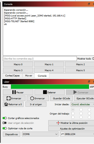

Laser TTS 10 Pro
Esperando conexión…
Esperando conexión…
Esperando conexión…
[MSG:Local access point Laser_32943 started, 192.168.4.1]
[MSG:HTTP Started]
[MSG:TELNET Started 8080]
ok
Grbl 1.1h [‘$’ for help]
ok
laser: TTS 10 Pro no se logra conectar , funciona a veces y cuando trato de conectar nuevamente solo sale ocupada .

yes. I follow all the steps. install the driver… but stil have the same issue. I had to restart the pc several times . also days and sudenly connects . but just for few minutes . because if I wait with the engraver connected. it said that the engraver is busy and dont let me do anything else

If I wait one day Long. i can use the machine just few times. ather that shows busy … and Even if I restart the laser, the pc , still showing Busy .

Meanwhile, in the “laser” window where the COM port appears, have you tried changing the port and seeing if it already connects?
