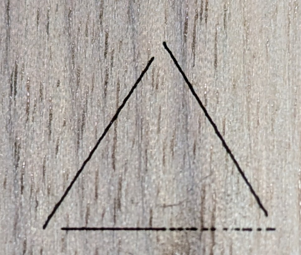

Laser turning down power at end of line? (no min power setting?)
Description covers it - 2500mm/m, 25%, 9 passes in 3.5mm walnut.
Falcon2 Pro 40W Diode
Curious what setting could help this? Seems like the laser is lowering power as it gets ready to make the turn? This is the back view and the laser traveled clockwise from this view. Something changed as I was able to do this cutting last year during the holidays. Now it’s making the cut but not those last bits. Did something change with Lightburn GRBL?
Acceleration is set to 1000mm/sec ^2 for both x and y. Default machine settings.
I see mention that this is to avoid burning the corners however it seems this is too aggressive. Is there a ‘knob’ to turn to adjust this?
Doubling my power to 50% and doubling my speed to 6000mm/min shortens the uncut bit but it feels like some math with how lightburn or GRBL adjusts power with corners needs a knob for us to turn?

Higher speeds helped minimize lower speeds in the corner it seems and less ramping down of power.
The outline cuts fine(longer lines than inside) with last years settings minus a little bit at the end with deceleration. The inner pieces are worse. Last year I crept up on the cutting setting as I wanted to use minimal power to minimize burning of the edges.
Did anything change with how lightburn ramps down power into corners?
No, because LightBurn just sets the overall layer speed.
The controller regulates the laser head speed using the axis acceleration / speed limits, with more-or-less proportional power adjustments as the speed changes near the corners.
If (last year) you set the LightBurn power just high enough to not char the edges and the laser diode has weakend with age, then (this year) the results will be about what you see.

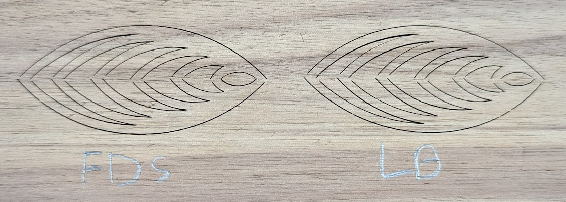

I ran the same SVG with settings the same in Falcon Design Studio as in LB, 3000 / 25% 9 passes and you can see, Falcon Design Studio on the left did a better job of getting that last little bit before turning the corner(smaller uncut section).

This is normal if you use dynamic power. Make sure to activate constant power in layer settings.

I did note that the movements with Falcon Design Space were different from the GCODE movements Lightburn did.
There are a myriad settings affecting the outcome.
Tracking down what’s different involves speed, power, that pesky Max S-Value setting, and so forth and so on, but you should be able to get equivalent results after you identify all the differences.
This is what I needed to enable. No burn marks and clean cuts all the way through!
Wonder if that some how got unchecked or the like from last year. Odd but good to go now. :slight_smile:
