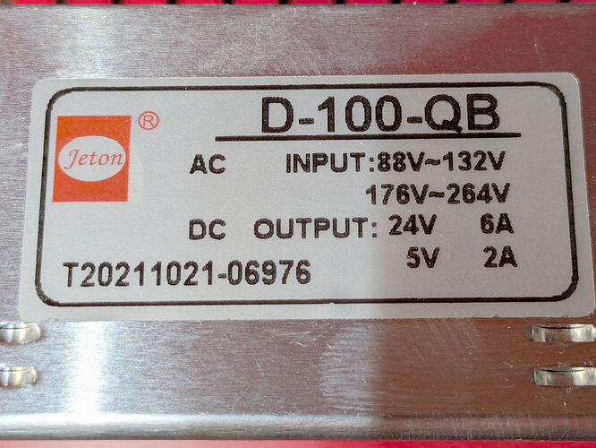

The power supply has a dataplate = sticker on the case with its output voltage and maximum current:
It was a dual-ouput supply:

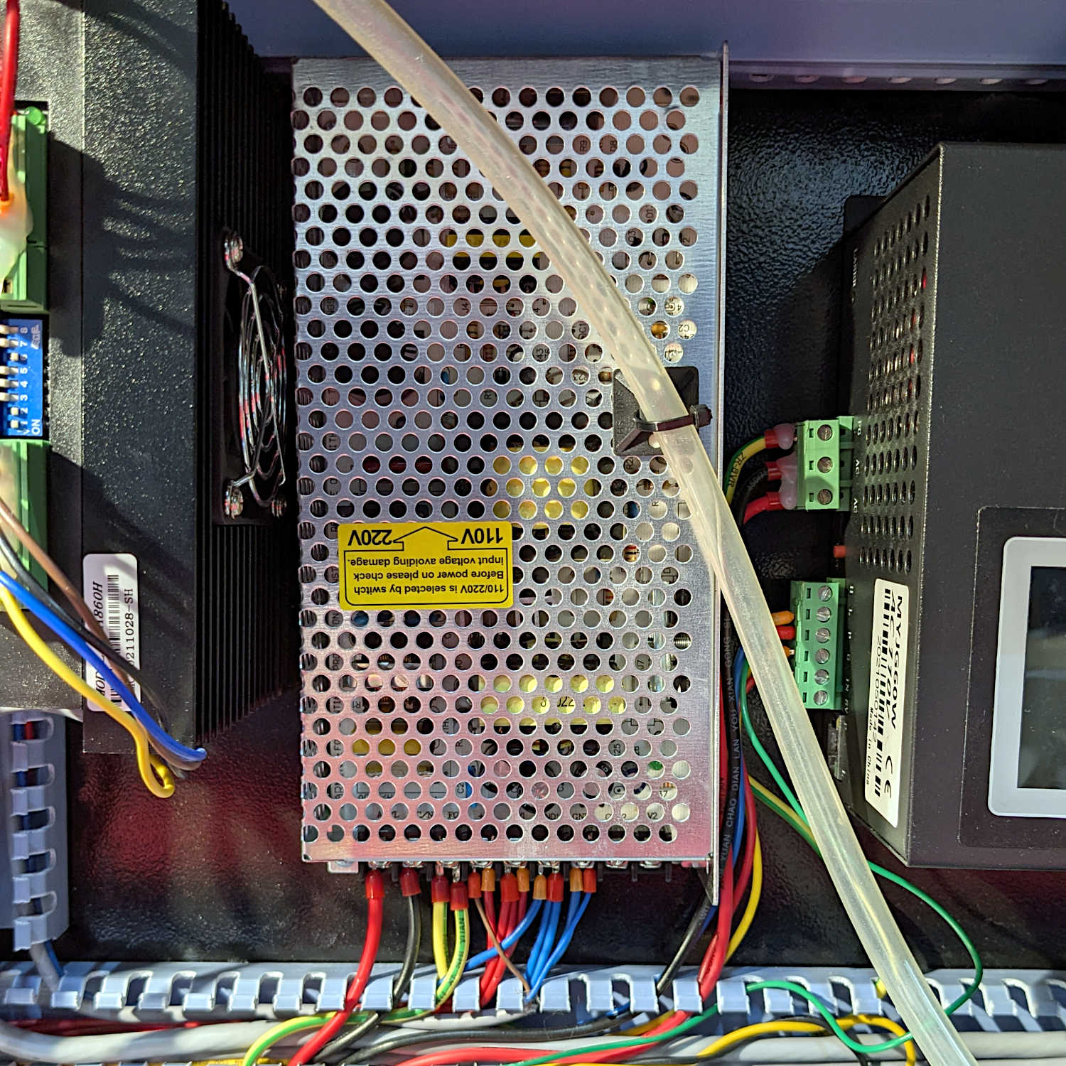

But the power supply will (almost certainly) be mounted in such a way as to make that sticker invisible:
It’s on the left side, smushed against the Z axis stepper motor driver. :grin:
I extracted the OEM supply and replaced it with a beefier one, which precipitated a major battle because it did not fit the same way:
But, hey, I can read the label.
I had that power supply on the shelf, but it has a much higher current rating than needed even by my absurd standards.
If I were buying a new supply, I’d look for one with a 10 A rating that fit into the original space.
