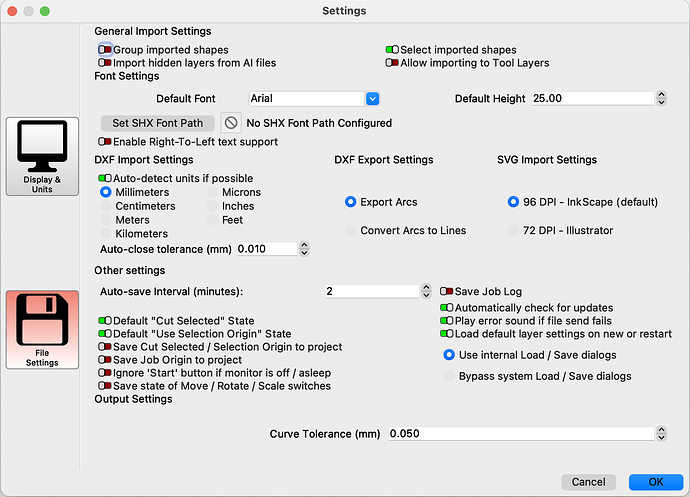

I’m fairly new to laser cutting/engraving. Lightburn has been working well and I’m getting a decent grasp of the basics. I’ve been using an older iMac to run lightburn and the laser. It was working great until I decided to change out the older iMac to a new model. Now every time I start to cut or engrave, the laser backs up about 25mm or so and then starts working. It makes it impossible to place a design accurately on the material. I have not been able to find any setting that is incorrect. Does anyone have any ideas? Thanks in advance.

Can you provide the following to help diagnose?
  1. Full screenshot of LightBurn with the design loaded and Cut and Laser windows showing
  2. Screenshot of Device Settings
  3. Save the gcode by going to File->Save Gcode. Save the file with a .txt extension and upload to the forum

a ha! I see a pointer offset in your Device Settings. Try switching that off.
@Colin has called out the likely culprit.
Can you confirm you’re not using the red crosshairs for alignment? If so, then that’s certainly the issue.
I just ran a test and it worked. I do not use the crosshairs so that make perfect sense. I saw that and assumed that since I wasn’t using crosshairs, it wouldn’t matter. Wow, thank you for not only finding the issue, but also for the fast and friendly responses.
