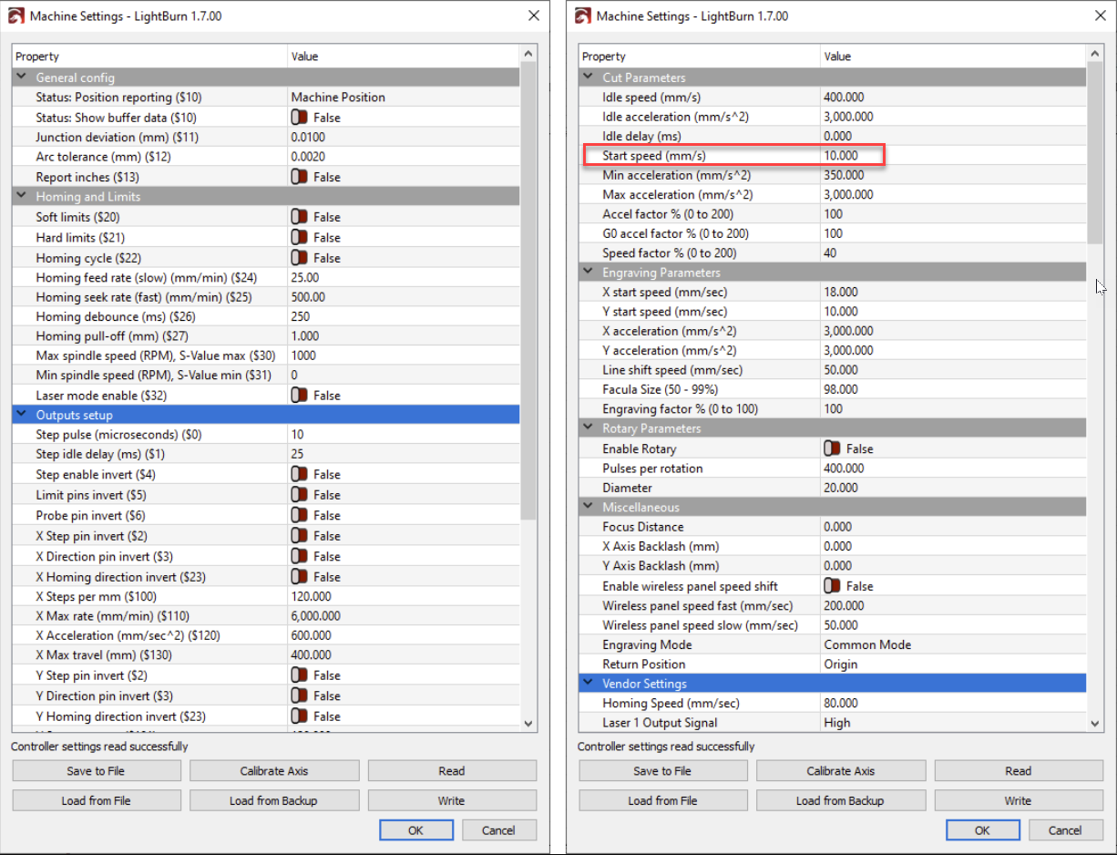

I think you may be going slower than the laser start speed. Try this. Increase your speed to 15mm/sec and run it. Check your Ma meter now. I think you will see a significant increase in power.
If this works, check your start speed in settings and either lower it or keep your speed above this threshold.

I didn’t know that the laser had a start speed and as the output was so low I had it set to only 4mm/sec.
Increasing the travel speed would never have occurred to me as it seems logically ridiculous to go faster if you cannot even cut at low speeds.
Any idea where I would find that start speed setting?
Bob
With the machine connected, look in Laser Tools>Machine Settings:
You can still cut slow you just need to increase/use Min Power for those situations.
