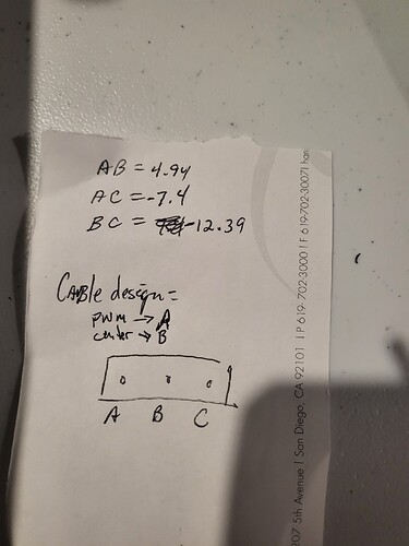

I tested across the two outer pins on the “laser” plug. It measured zero at all times across 1 and 2 and across 2 and 3.
Does this connector have any visible markings near the pins?
If not, assume for the moment that the center is G. Then check voltage across Left and Center pins. What is voltage? Then test Center to Right. What is the voltage? If one of them reads 15.3 V then that will be the Power pin. The other is likely to be PWM.
Once PWM pin is identified test at 0% power, 50% power, and 100% power. What are the voltage readings?
For this photo, I can see PWM pin marked. Are the other two marked?
There are no.other markings than what you see in the pics.
BC is likely power and ground. Was the positive probe on B? If so, B is likely ground and C the power pin. That would make A PWM.
Did you run the AB test while you were demanding 100% power in LightBurn? Or is it always providing ~5V?
If it’s always showing 5V then that’s likely the cause of the issue you’re seeing.
That would be either a firmware or hardware issue in that case.
Ok, it is always showing approximately 5 v.
So, I suspect the firmware is bad or the card as a whole? Not likely the laser because this is all without the laser hooked up, correct?
