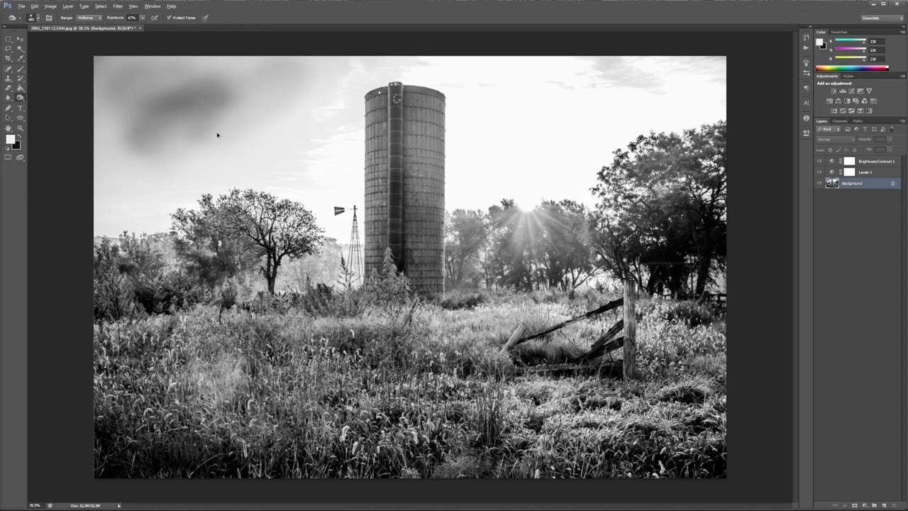

and then this video that explained how to do dithering right in Photoshop.
There seems to be a lack on continuity in Russ videos, and he completely skipped the process of getting the image he’s made in RDWorks into Lightburn, and then out to the machine. I mean, what did he even save the image as? what were the settings in Lightburn? Did he use dithered mode on an already dithered image? or did he use pass through. I don’t have RDWorks and don’t have any interest in it (like using Gimp on top of Photoshop when Photoshop already has all the tools), so I found the 3rd video about turning an image into a dithered image in Photoshop… but even that one completely failed to explain how to process the resulting image through lightburn.

If you ‘dither’ it external to Lightburn then you should use pass-through. If you have an image set that is dithered and you disable pass-through, lightburn will dither it again.
If you use sites such as https://www.imag-r.com/ you should to use pass-through as you have processed the image…
There is no reason you can’t dither a dither on an image, but the results may be unexpected.
