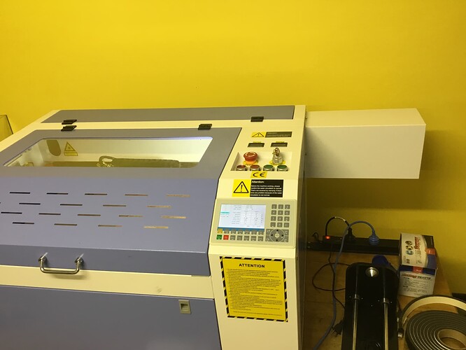

new machine from Liaocheng Julong Laser Equipment 100w 600 x 400

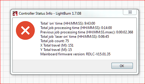

lightburn sends filed to Ruida no problems, reads the controller info can make controller changes nmo issues so lightburn is talking to laser controller et
any file put into the Ruida by USB or sent from Lightburn will run the path but no laser
so far only been able to run demo file that came in the controller and it work perfect
I can run a file from lightburn and the head follow the cut path only - no laser
laser wont pulse from lightburn either

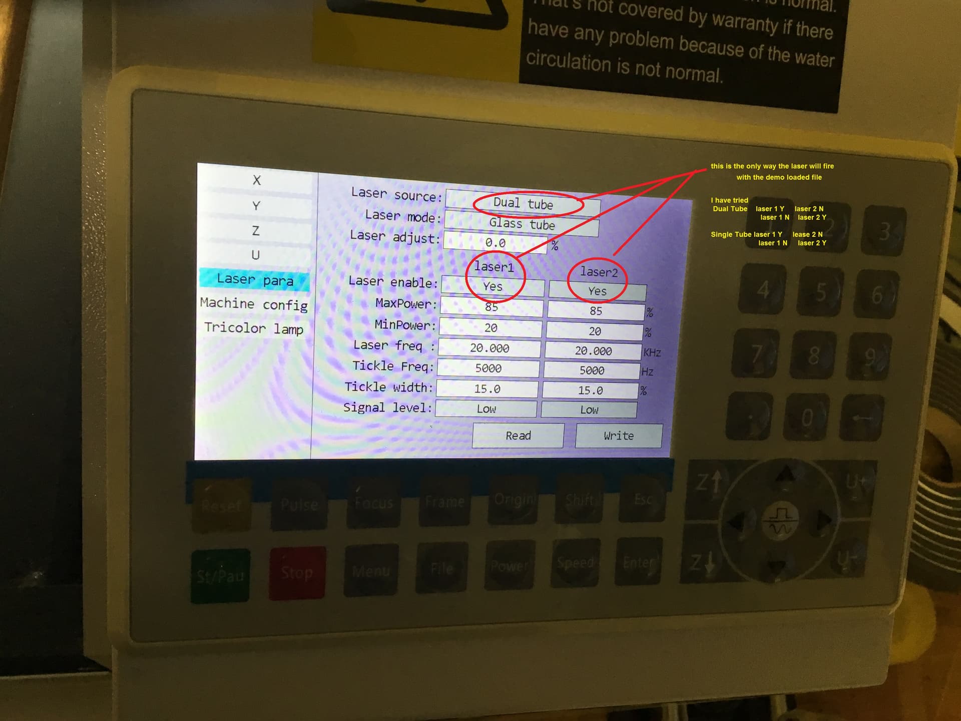

on the Ruida the pulse button works and every thing else on the controller does what it supposed to, so I have deducted that it has to be a setting Lightburn somewhere

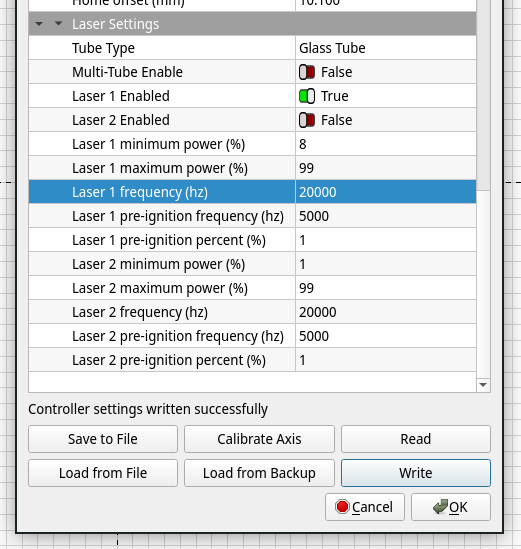

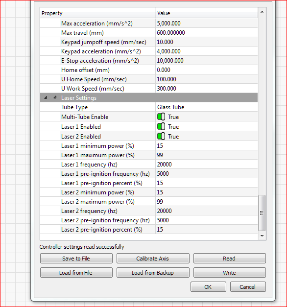

Upload screenshots of the Machine Settings so we can take a look at Laser Settings section:
Also upload a screenshot of the window you’re using to pulse the laser, because IIRC the Fire button should not be available for machines with Ruida controllers.

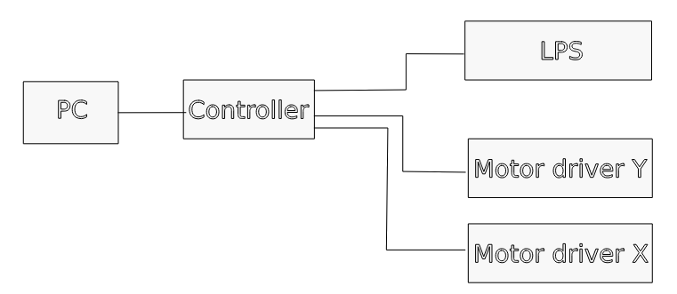

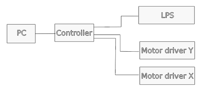

A very simplistic layout of controller (Ruida) and it’s connection to the lps/motor drivers.
If the controller will pulse the laser, then the controller is likely working, as you surmised. However, I know of nothing in Lightburn that can cause this kind of anomaly.

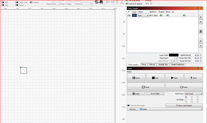

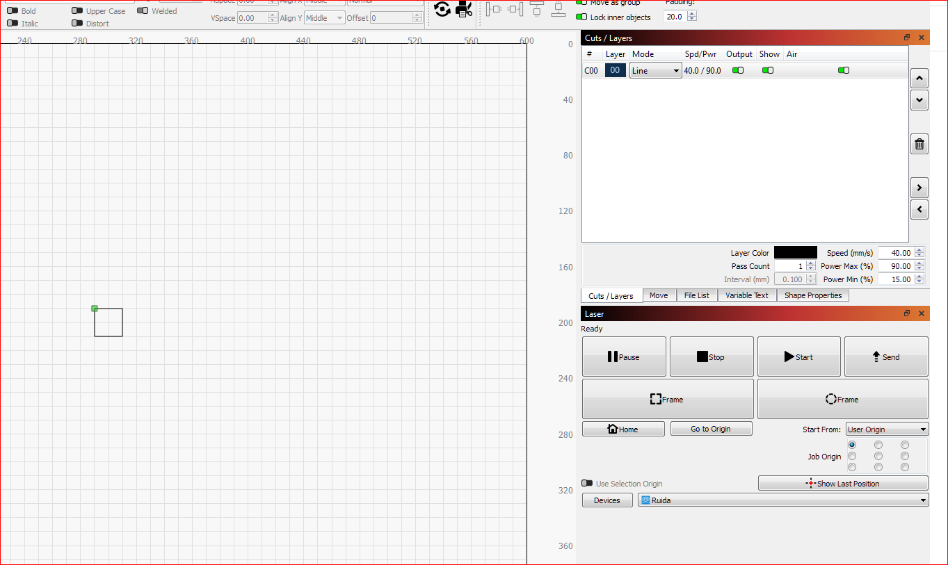

attached the screen shots
also a 20mm Sq made in lightburn for test setup
it loads into Ruida, follows path but no laser on

In the Ruida it is set up for 2 lasers, if I turn either off the supplies demo follows path but no laser

Go into the Lightburn machine settings and save your current settings in a file, just in case you hose things up.
Did you change the items that @ednisley suggested?

First of all, turn Beginner Mode Off so you get the full set of choices everywhere; you’ll eventually need them and it makes things easier for us to debug.
Assuming the machine homes correctly when you turn it on, then:
- Use
Start From: Absolute Coordinates - Turn on
Cut Selected Graphicsso LightBurn will cut / engrave only the things you select, which eliminates a ton of heartache & confusion
Assuming:
- It has a single glass tube
- The controller’s
L-On1andL-PWM1are wired to the high-voltage power supply
Then:
- Set
Multi-Tube Enableto False - Set
Laser 2 Enabledto False
With a 100 W tube, set the layer power to 20%, because more than about 75% will use up the tube entirely too quickly. Practice on cardboard until you gain confidence in your control over the machine.
With all that set up, select that little square, hit Start, and report what happens.
hit start, follows the profile no laser
tried the demo file, profile & no laser

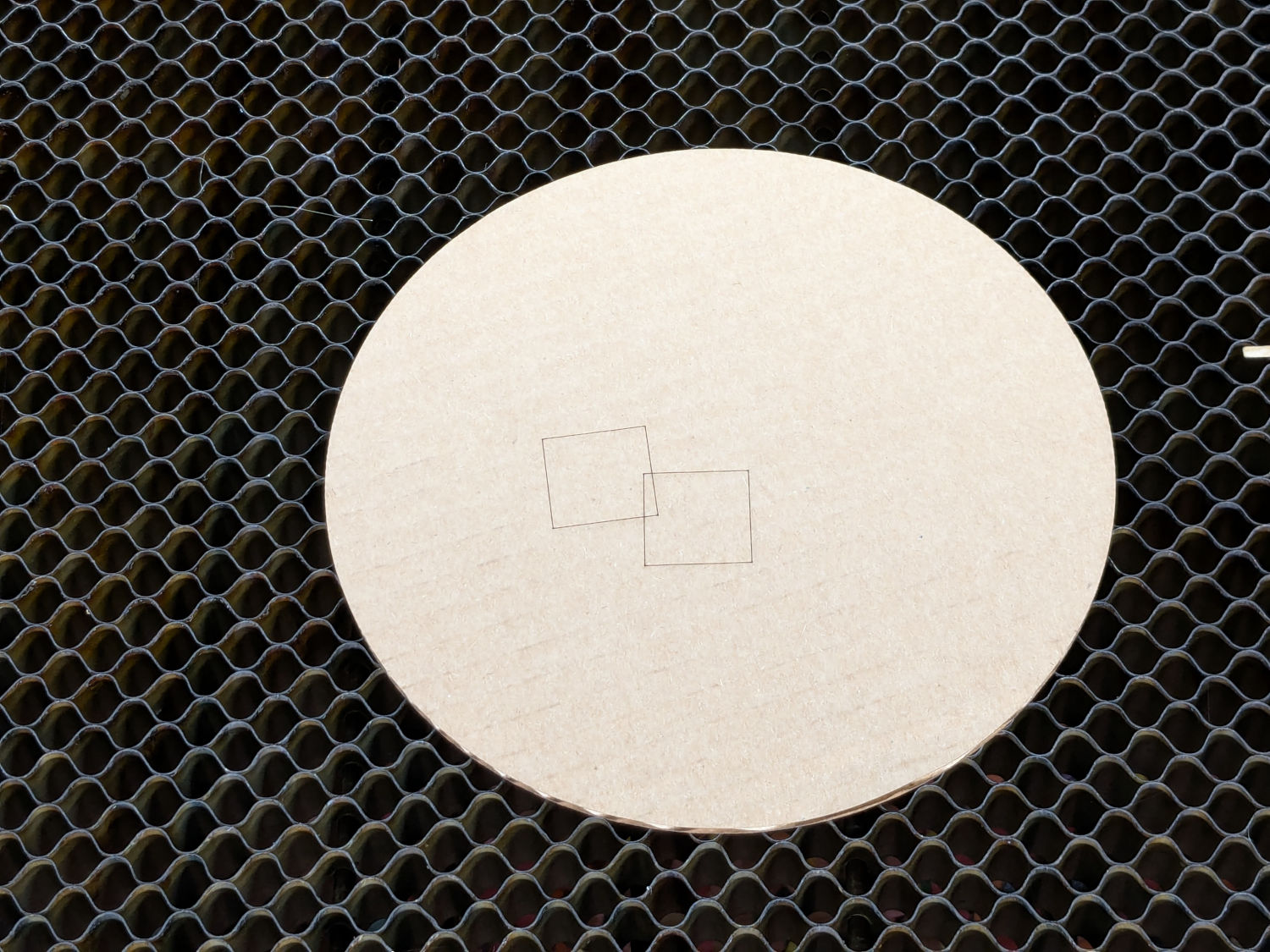

Both the LightBurn file and the RD file work fine, although I reduced the power level to a level suitable for cardboard:
Without knowing any more about the machine, they may have wired the power supply to use both laser tube control outputs, perhaps with L-ON from tube 1 and L-PWM from tube 2. The reason may have nothing to do with good engineering practice and everything to do with the length of the wire harness.
Perhaps telling LightBurn the machine has a second tube would work, but it would definitely require some careful experimentation with close attention to detail.
