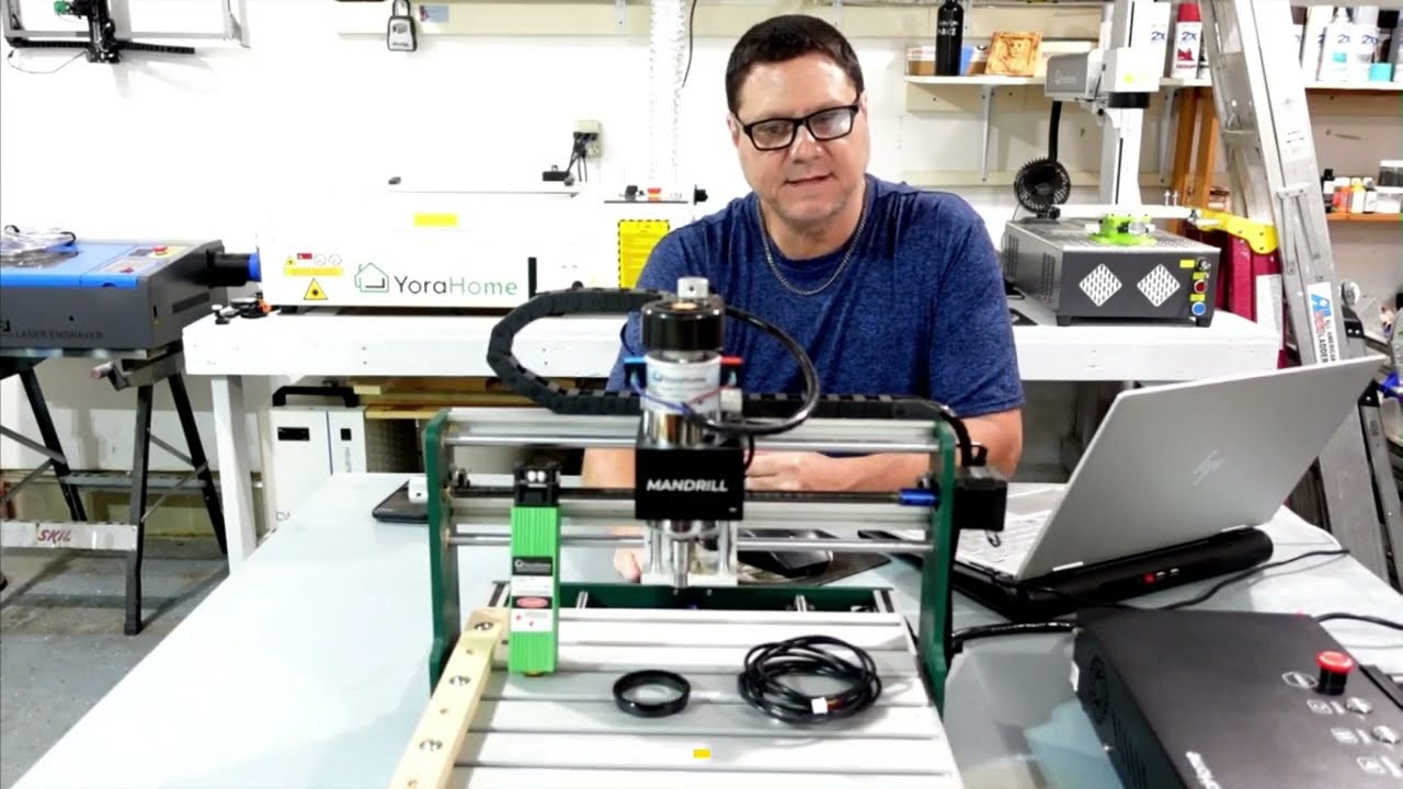

Did you follow this video for the installation and setup?
