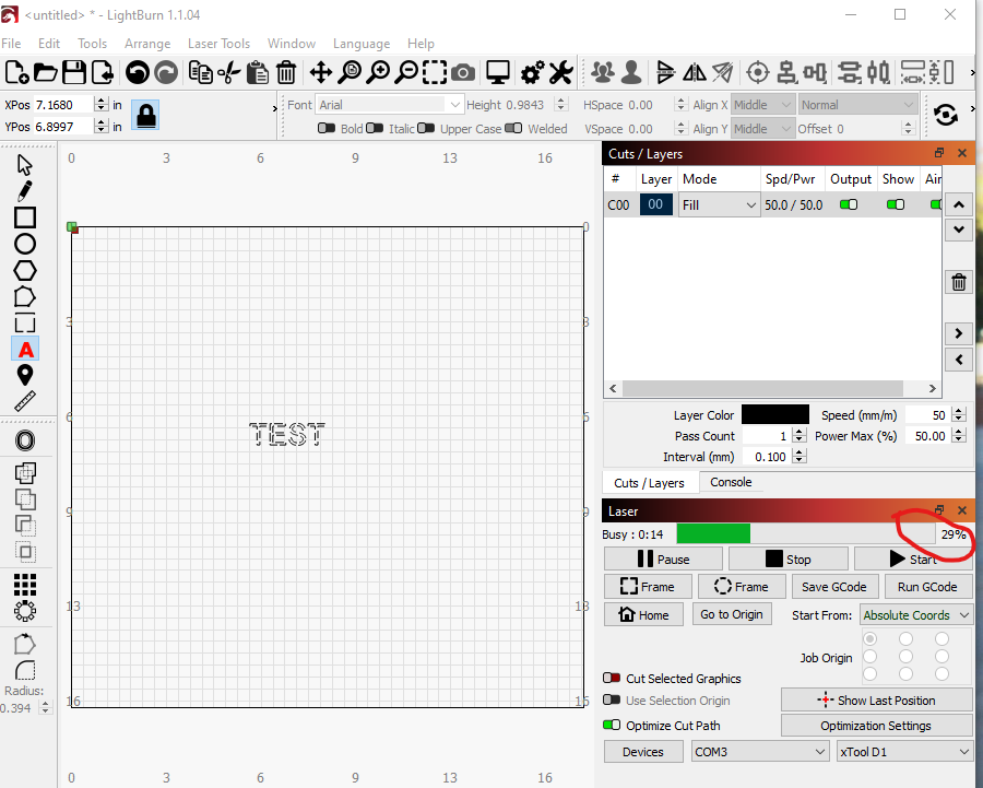

I have a XTool D1. I’ve got Lightburn set up, driver file installed, etc. Tried to run a test project, had the laser head in the top left, framed the test run, push start. the laser head moves to the start of the cut position and nothing happens…laser doesn’t start. I’m sure there is a setting that I missed somewhere. Any help would be appreciated

Here are three screenshots
  1. Before I pushed start
  2. Shows it goes to about 29% then stops. The laser never fires. It moves to the start position, the red cross hair blinks once, then it sits there.
  3. Shows the console, shows rebooting, next line is fsquare~square squaref~
I’ve uninstalled Lightburn and reinstalled, removed my device and reinstalled (multiple times), rebooted the laptop. I’m at a loss.
Your setup looks fine. Seems to me your controller is crashing and then rebooting.

Can you capture the full Console output which includes what happened prior to the reboot? There’s likely something that occurred prior to the controller crashing.

Here is a screenshot from starting the machine and framing a test run (I framed it twice).
First part of the console when I tried to run test
Last part of the console on the test run
