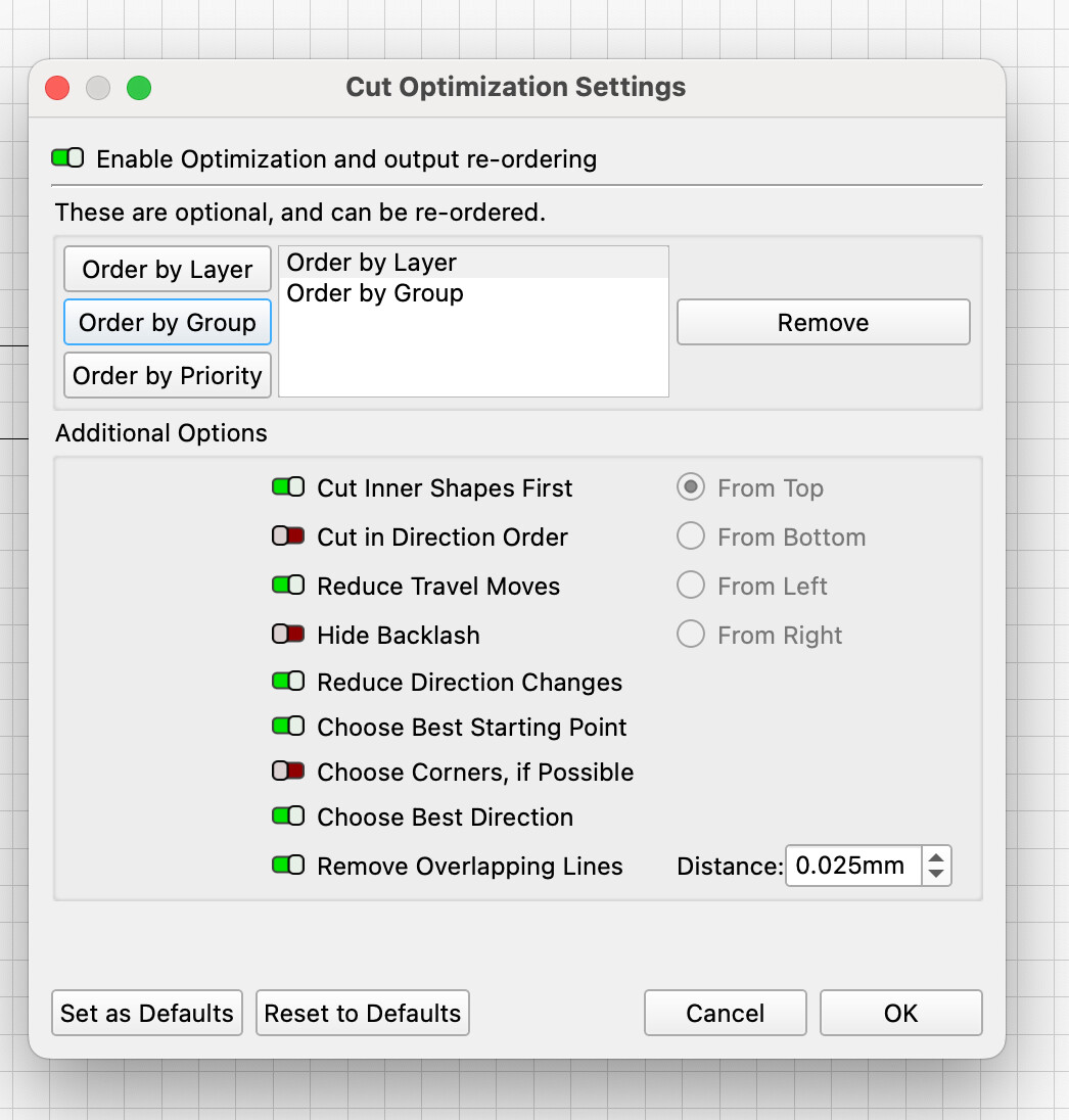

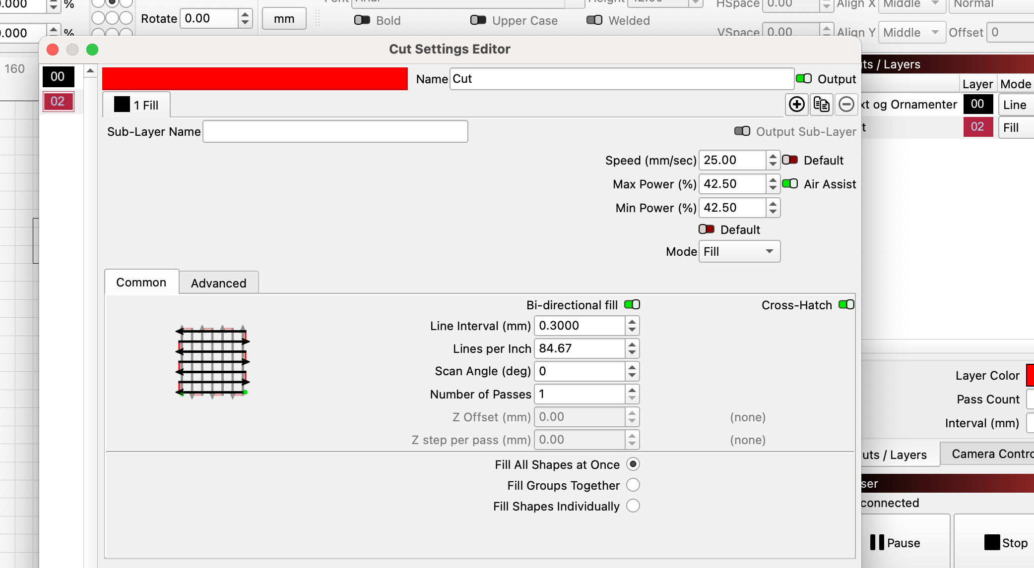

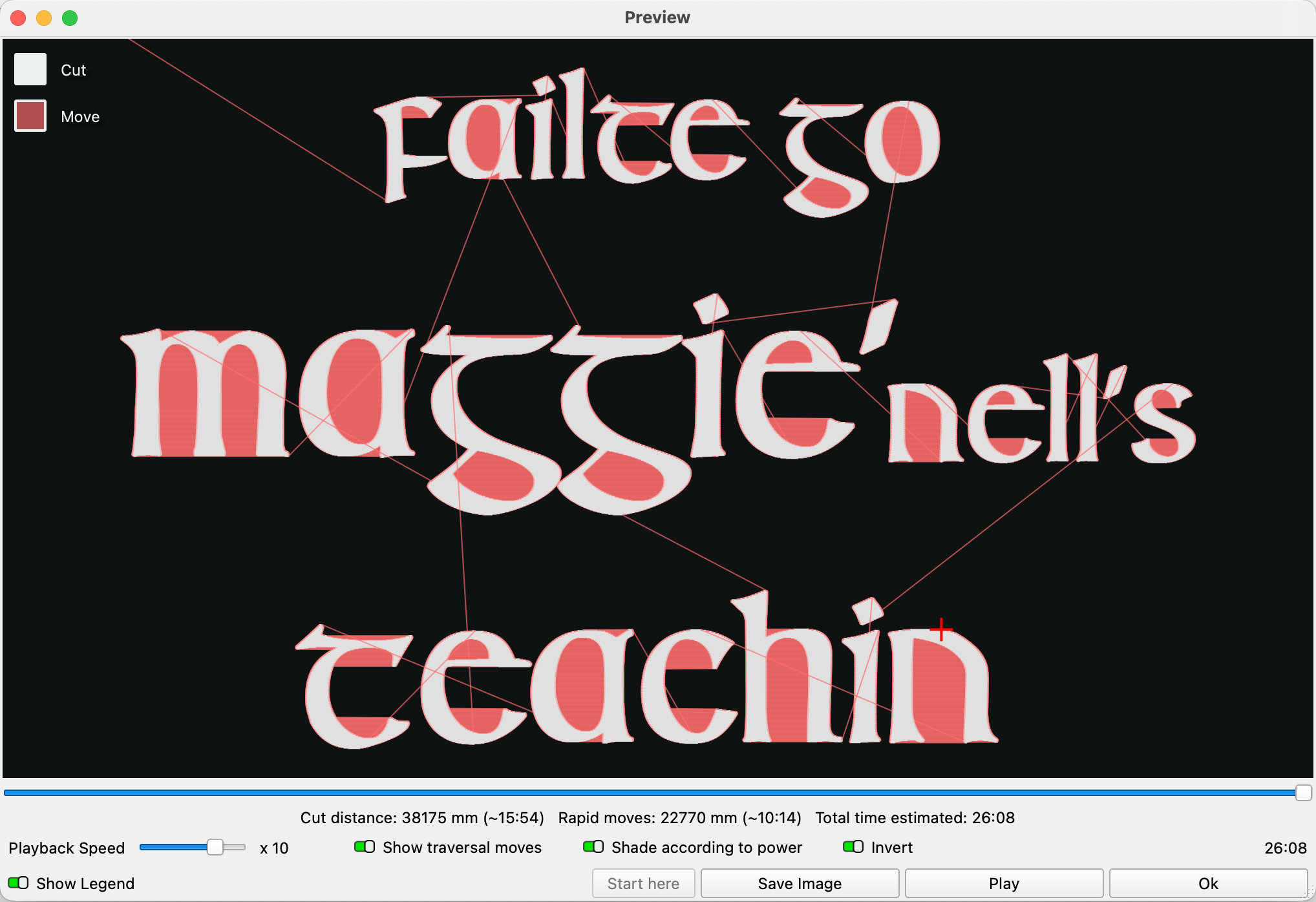

When lasering text my machine will burn the first letter and then travel all of the way to the last letter in the line and burn it, then all the way back and burn second letter, and all the way back to the end and burn next-to-last letter, and then to the middle of the line and burn just part of a letter , etc, and this really slows the job down.
Isn’t there some setting that would cause it to just start at first letter and then burn each succeding letter in order?
Thanks, Lewis
Hi Lewis, it looks like you haven’t “optimized” your cut order.

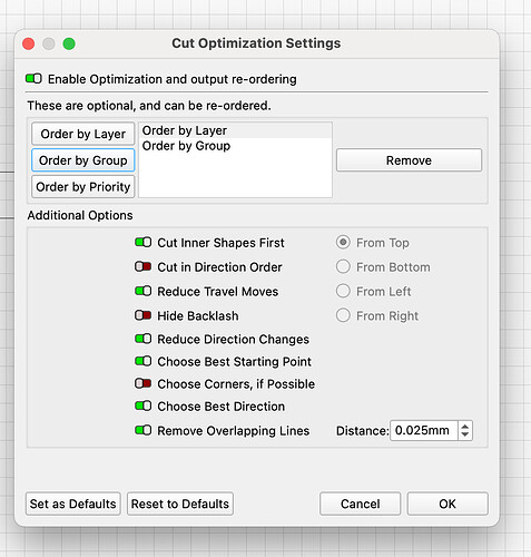

Try to see if you can use some of these settings, especially the image on the left, at the bottom, should be interesting to you.
I made the settings as shown, and it maybe helped a little. It still skips around a lot but perhaps that is just the way it is supposed to work. Thanks for the help.
Not sure if its relevant but I had the same issue today and it was wth a downloaded font from the web, for a one off job I was doing.
The best help to understand and help is examples from the current problem, so create some files we can look at.
