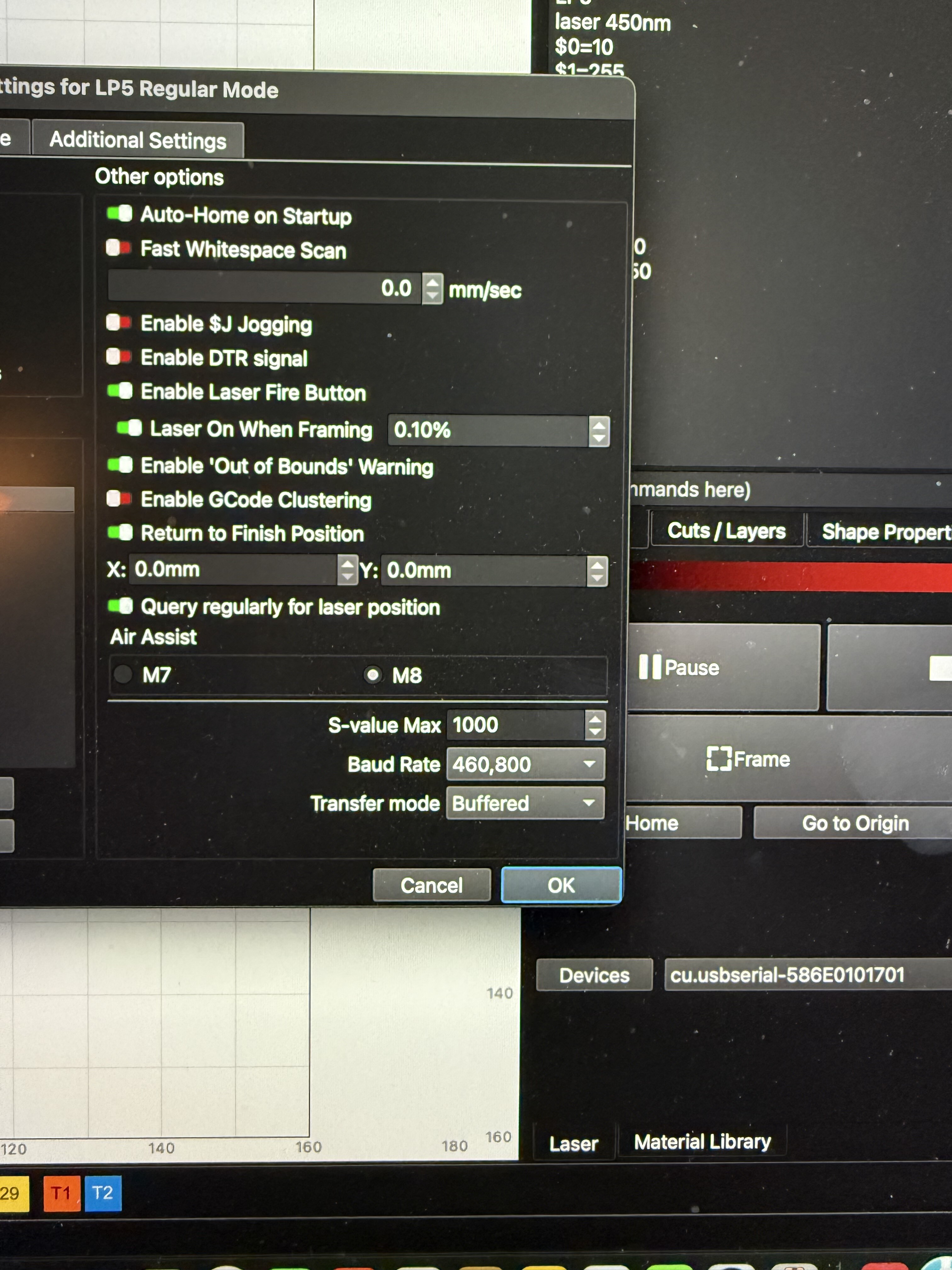

We noticed that S-Value max is at 255.
Explanation from this docs page: GRBL: Low or No Power Output - LightBurn Documentation
This number tells LightBurn how to represent 100% power for your machine. Current versions of GRBL default to 1000 for this, while older versions use 255. The important thing is for the numbers to match.
Please try the following:
  • In the Console Window, enter this command and press enter while your laser is connected: $30=1000
  • Go to “Edit > Device Settings” and enter 1000 in the S-Value Max field on the lower right.
  • Let us know, if this changes anything.

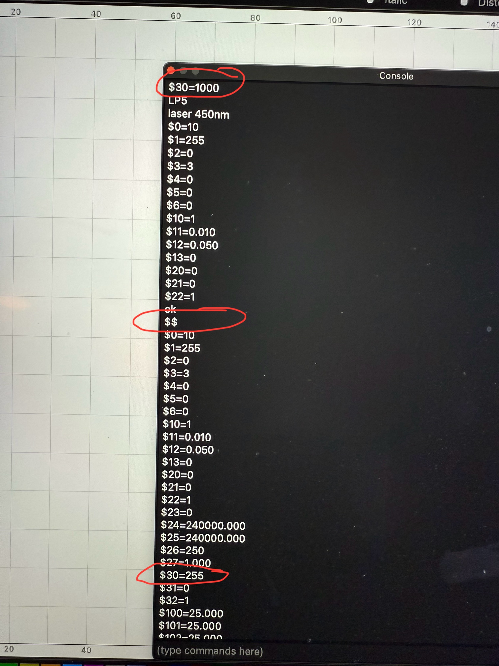

Did everything step by step and while it now allows me to go down to 0.10%, it still cuts into the material. Also after I updated the GRBL setting, I entered $$ in the console window to pull the full config and noticed the value for $30 did not update. It still shows as 255.
Some manufacturers controllers won’t allow the user to change these internally set values.
As an alternative, change S-value Max to whatever your controller shows for the $30 value. In your case, set it to 255.
They need to be the same for both machine to talk correctly or understand each other.
You can check whether there is any room to lower the power by exportig the gcode, opening it in an text editor and looking for the S parameter of the G1 command. If it says “…S1…”, there is no way to reduce the output power without turning it off completly. The LightBurn config, that can be downloaded from LaserPeckers website appears to be correct though. The minimum value should be about 0.4%. Especially the fiber source - being pulsed - is quite violent even at the lowest power setting. When marking black plastic the lowest setting is what I use and I would go lower if I could. Using the blue for framing is also not a good Idea because they are not coaxial at all. I get up to 2.7mm differnece depending on the position.
