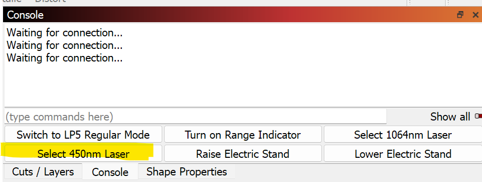

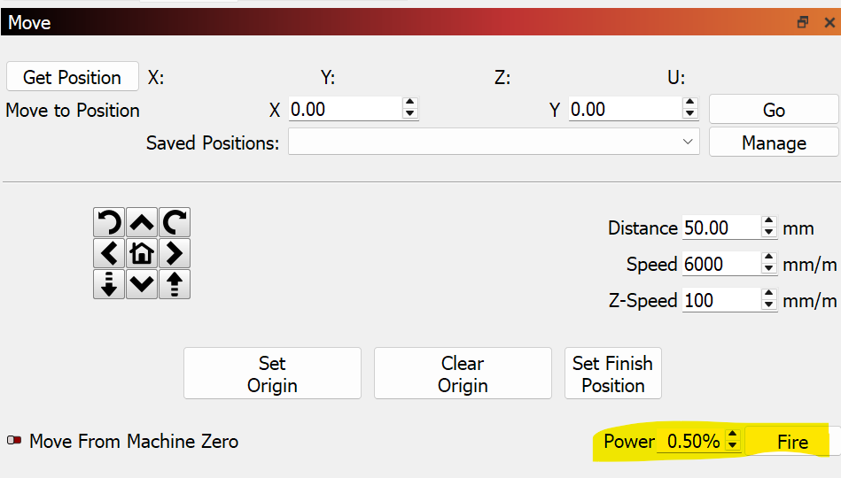

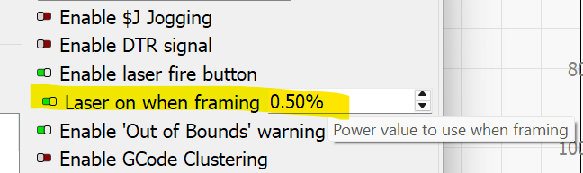

Fairly sure this will be a rhetorical question, but is there a way to get the framing laser with the LP5 to chill out? I learned the hard way that framing with the LP5 in Lightburn actually causes it to engrave on the material. I love Lightburn and absolutely HATE Laserpeckers LDS software, so the more I can use Lightburn, the happier I will be.
I don’t own a Laserpecker, so I can’t confirm this but:
Did you enable “Laser on while framing” in the Device Settings?
You may need to lower the Power value here:
This is off by default with the current LaserPecker Device Profile from here but I believe, they didn’t update it for Adam’s file yet.
Update: You may need to first switch to the 450nm Laser with the macro from the Console window.
I double checked that “laser on while framing” was enabled and that I am using the 450nm laser. The lowest it will allow me to go is 0.40% which is still enough power to engrave the material. If I go lower than 0.40% nothing happens

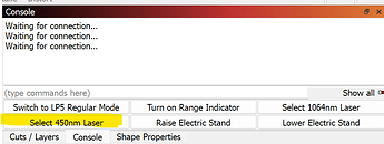

Which material are you using?
So, if you enter 0.2%, you don’t see anything?
Make sure to first run the “Select 450nm Laser” macro here:
Then press the fire button here:
If it’s still marking your material, try a lower value in the “Power” field next to it.

Brightness: $30 and $31 describe max and min brightness values, that are set to 255 and 0 and appear to be interpreted a an integer, which explains why 0.4% is the lowest possible brightness setting in Lightburn (0.4% * 255 ≈ 1). This is also the only advantage the grbl style protocol has against the proprietary one as you can only set intensity in full percent steps using LPDS.

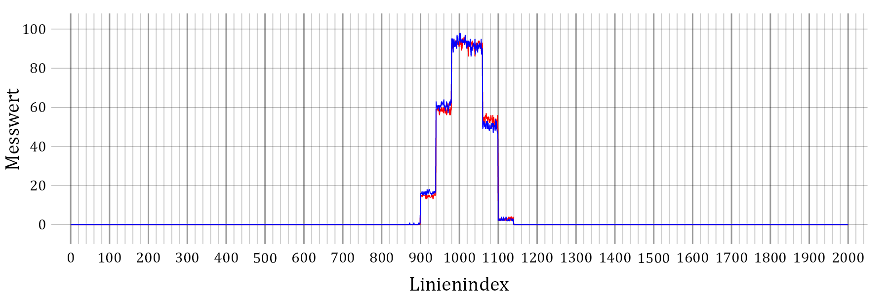

Resolution: Steps per mm ($100 to $102) is set to 25. That means one step every 40µm. Thats 2.5k not 8k in theire lines per dm resolution metric. Every position Lightburn sends is rounded to the closest position on a 40µm grid.I checked that with running the laser point over a pinhole sensor in 1µm increments and checking the change in measurement.
You can have higher resolution: I.e. when rotating the line direction by 45° so you can get about sqrt(40µm) ≈ 28µm line interval, but this will result in jagged start and end positions as those will be rounded to the 40 µm grid.
Speed: Speed ($110 to $112) is limited to 360,000 mm/min. Thats 6,000 mm/s not 10,000mm/s as possible in LPDS. You can check that yourself: increasing the speed over 6000 mm/s wont reduce the duration of any program, not matter how many long and straight lines it includes.
Accelleration: Accelleration ($120 to $122) is set to 750,000 mm/s². I cant compare that to LPDS as its nowhere stated. But it appears to be correct. Checked that by timing the length of different programs containing lots of straigt lines of the same length. Different programs with different line lengths result in different cutoff speeds from that on an increase in speed wont result in an decrease in time. (X-Axis: Speed set in Gcode, Y-Axis: Relative run duration; Lines are measured values, black diamonds are theoretical values).
chart test

HI Aaron, sorry for the delayed response. I have tried using anodized steel as well as aluminum with the same results. If I go below 0.4% the framing laser does not come on at all. At 0.4% it engraves the framing square lightly and at 0.5% it engraves the framing square significantly. I also confirmed on all of my tests that I was running the 450nm laser. I have not tried lowering the power field. I will run some tests playing with the power field to see if I get the same results.
