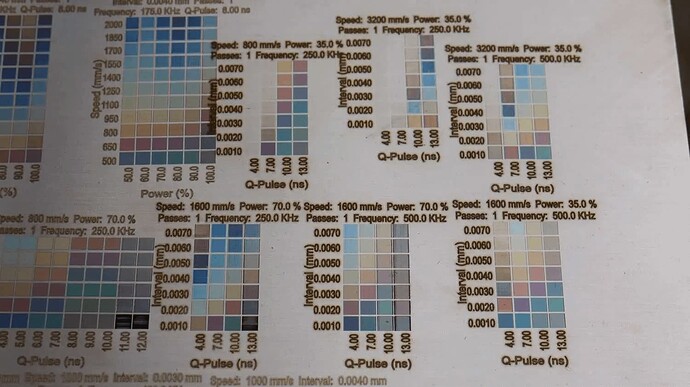

Using an F430 lens (300x300mm area), it seems as though there is a “dead zone” in the lower right quadrant of the work area. To asses the extent of the issue, I marked a grid of squares across a 12x12 plate of (very flat ~0.3mm flatness) aluminum. Please see the image below:
The difference in marking performance is not only visible, but also audible; the laser sounds loud and aggressive while marking in the upper left quadrant, but faint and weak while marking in the lower right.

Do you happen to have an alternative lens that you could test to A/B test if the lens is the issue here?
Alternatively, can you confirm that your workpiece is parallel to the lens? If not, you may be defocusing on the extents of your job.

The F420mm, at least your longest lens, has plenty of depth of focus (dof) to cover any anomalies in height variation. I think I computed mine at nearly 13mm… I doubt that you have a focus issue created by it not being square to the table…
Shorter lens, less dof – F160mm is only about 1.9mm dof
You can always check it by changing the focus when it’s running in the bottom right corner and see if you can adjust the focus enough.

To follow up on this, the tramming/parallelism calibration worked!
I used a digital level with 0.05deg resolution to ensure that the galvo head was trammed with respect to the bed of the machine, following the method outlined in this video.
The bed of the machine is warped, so it was difficult to level the machine along the y-direction. I’m planning to straighten it using some aluminum extrusion, which will allow me to tram it more accurately.
I’ve attached a photo of the marking results after tramming, new marks are highlighted with red circles:
