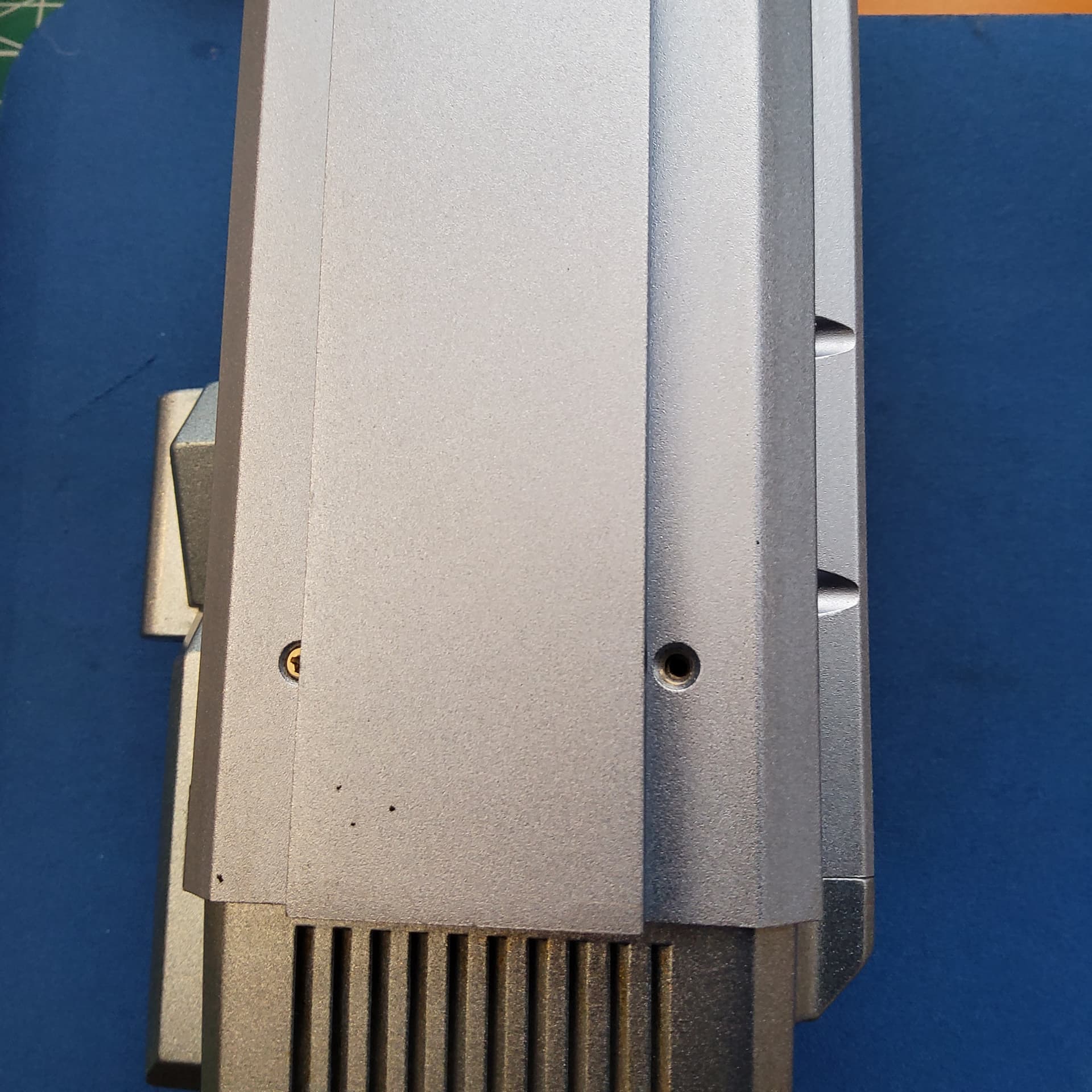

True…very true. But, and maybe I’m wrong, I expect a higher end “hobby” laser to work out of the box when that is what I paid for. I know, now after my first, how to tighten belts, eccentric nuts, etc. This machine, I did NOT put together, it was pre-assembled…badly. I have no idea how to access either side of the Y axis. None.

I don’t have extrusions…these are solid pieces with belts, etc. running through them. I am probably misunderstanding what you are saying, and while I can disassemble the x and y, I do not see a way to access the interior of the Y. In other words, I have no idea how I would ever replace the belt if needed, and indeed it IS a belt. Metric or Imperial has no difference in how the control panel would handle focus…ehh. doesn’t add up.

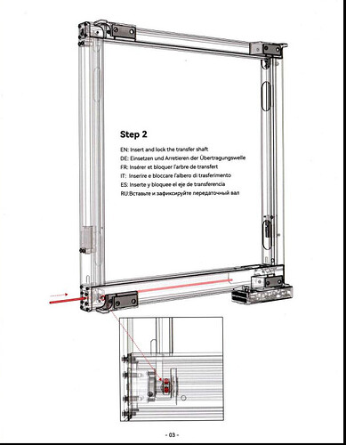

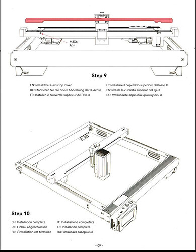

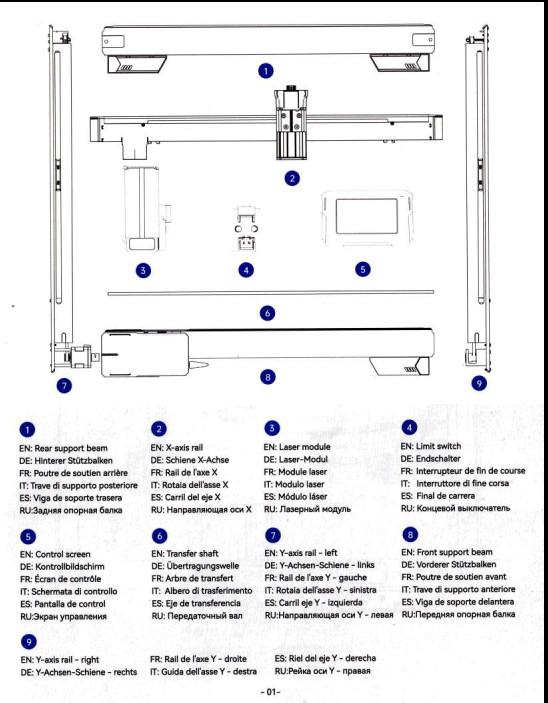

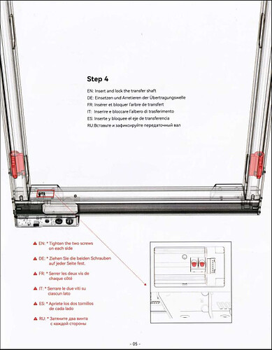

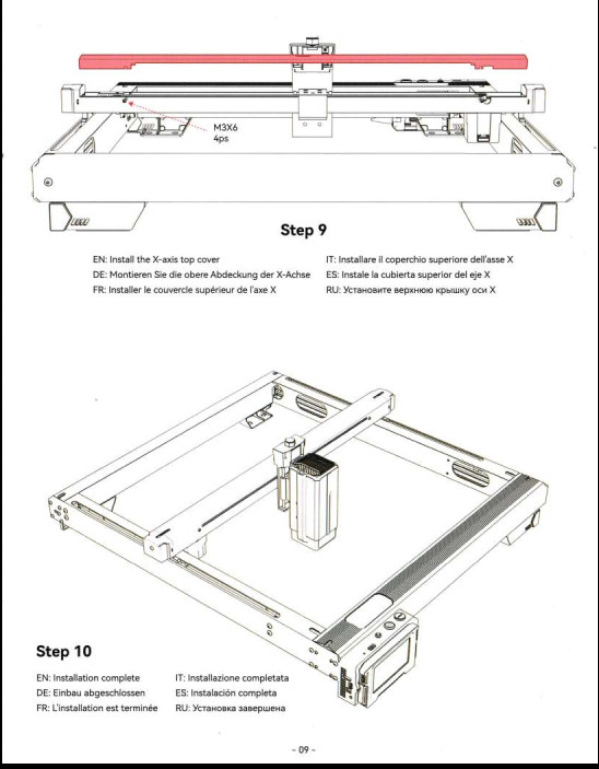

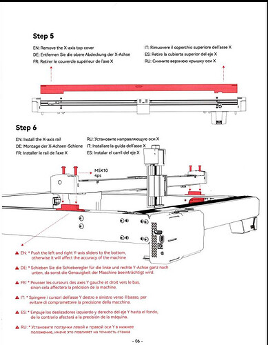

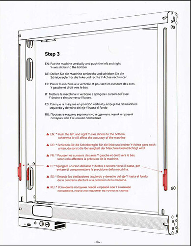

The Y…let’s call them “housings” are extruded. They’re just just not the typical 2020 v-slot extrusions everybody is familiar with. Regardless of name, tho, your machine is built exactly like mine. If you ever decide to really tear into it, it will be obvious how to do it.
Remove gantry cover, remove gantry, loosen y axis shaft coupler, remove y axis housings.

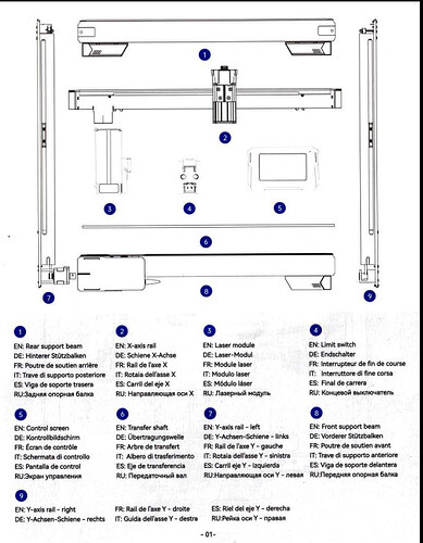

Mine is an earlier model that shipped in pieces and had to be assembled. I can probably dig up the old assembly instructions if you’re curious.

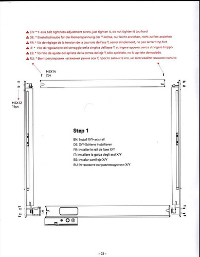

I actually would be curious as to the assembly instructions. Mine did not come with any except how to attach x gantry and module. I did not take everything apart down to me basically having to assemble from scratch again but I really am stumped how to access, even the belts. I would imagine doing so would void their non-existent warranty. And I’ve only dealt with a machine where I installed everything, from X and Y rails to the belts. Sometimes I feel that may be better, even if it is more time consuming.

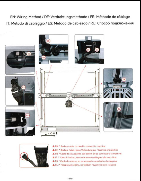

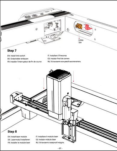

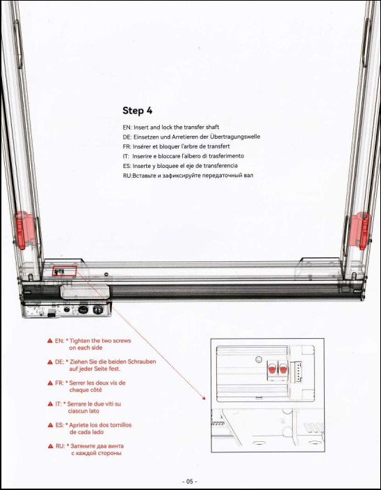

This is a link to the old support site.
I swear they used to have a PDF of the assembly manual, but now it’s just a video. I know the link looks suspicious but I have detected nothing hinky over the last 6 months from using it.
https://h5.clewm.net/?url=http%3A%2F%2Fqr71.cn%2FoIsRvn%2FqG2AaOL
This a scan of the paper booklet I have. I apologize for the quality, my good scanner is dead and I haven’t replaced it yet.
Ikier K1 Assembly Manual.pdf.txt (678.8 KB)
(download, then remove the “.txt” before trying to open.)

Not opening correctly even when removing .txt. But the on line manual looks very similar if not exact. Not sure all the screws are the same, but I will check tomorrow.
Odd. It works on two of my PCs with both Acrobat and PDF Escape.
Maybe this…
Thank you so much for this. I really appreciate it. I am still waiting for their final…offer?.. to fix this. Today they offered me replacement lenses? Besides the fact I had already ordered some with a bad tracking number, I have no idea what lenses have to do with the z axis issues and screws just falling out. Once I am sure they are not really gonna do anything, and my Roly gets here, I will do a full break down and see where these mystery screws go, if anywhere. Although, I did find one and immedietely dropped it that came from the module itself. Now its gone. No response yet as to how that should occur. This should really help me. Again, thanks. Here’s a pic of the module where the screw fell out and was just sitting on the work piece.
