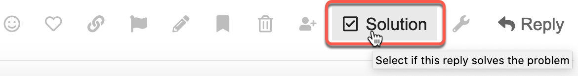

Awesome. If willing, it is helpful to mark the working comment as ‘Solved’ to help others find it more easily in the future. ![]()
