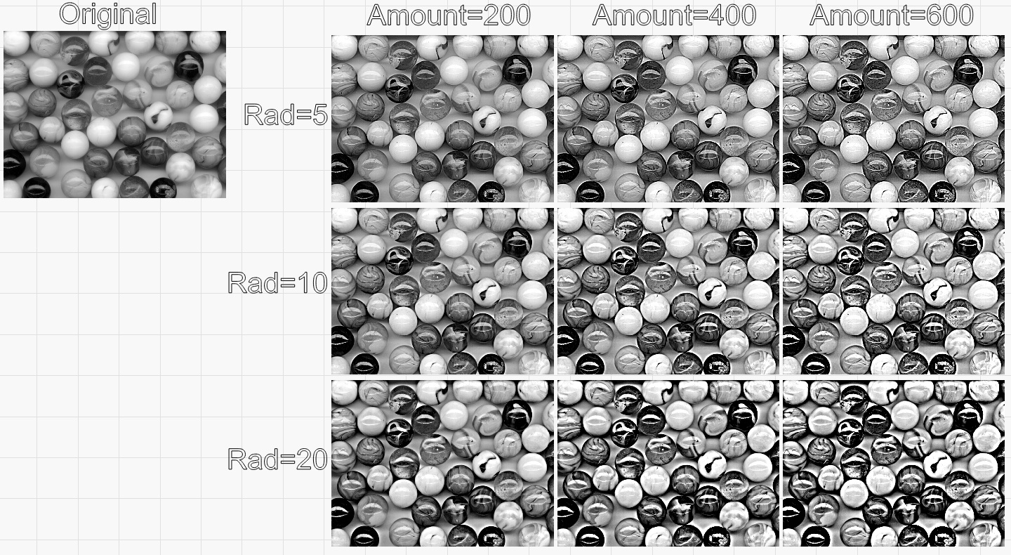

What does radius do, or are you referring to the corner radius in the shape properties. I cant find anything in the docs about it.
Enhance Radius and Enhance Amount work together to enhance the edges in the image. ‘Amount’ is the strength of the enhancement, and ‘Radius’ controls the area of the effect. It’s a little tricky to describe, but relatively easy to see:
Look in the 3rd column - all three pics have the same “Amount” but the Radius increases with each row. The bottom row of pics has a very distinct wide “halo” around the edges that is less pronounced in the upper images.
Great post and response. You can definitley see the halo on the bottom row espicially around the white marbles
