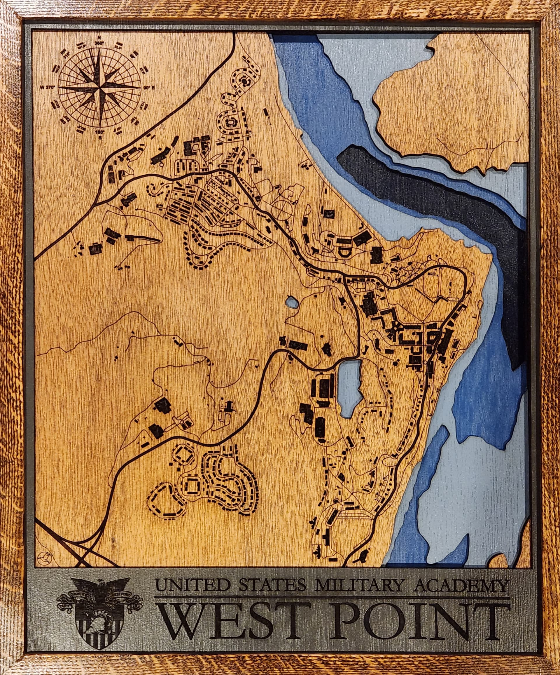

Layered Digital Maps
Custom built with QGIS and public domain data .

Frames were built out of Red Oak.

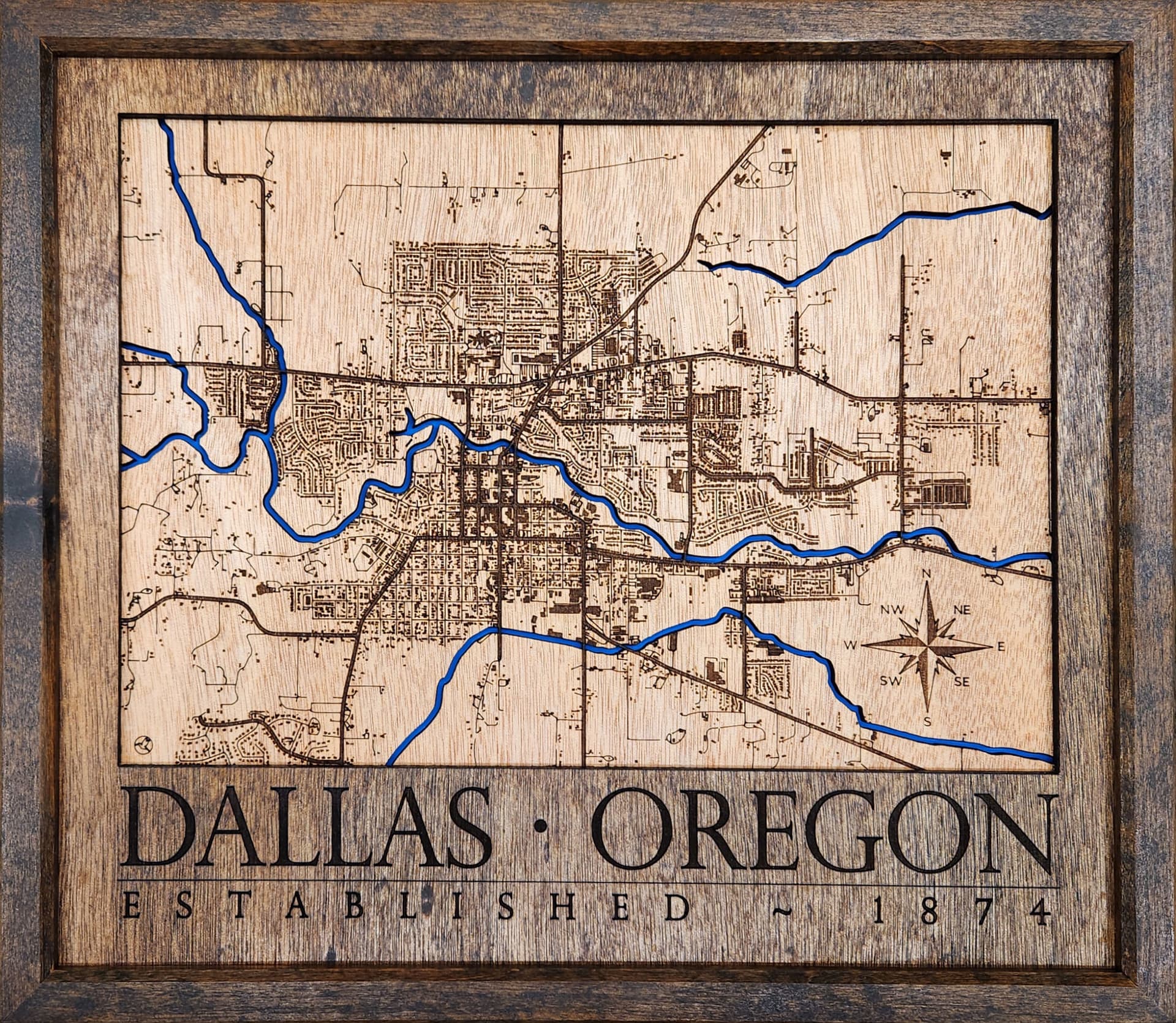

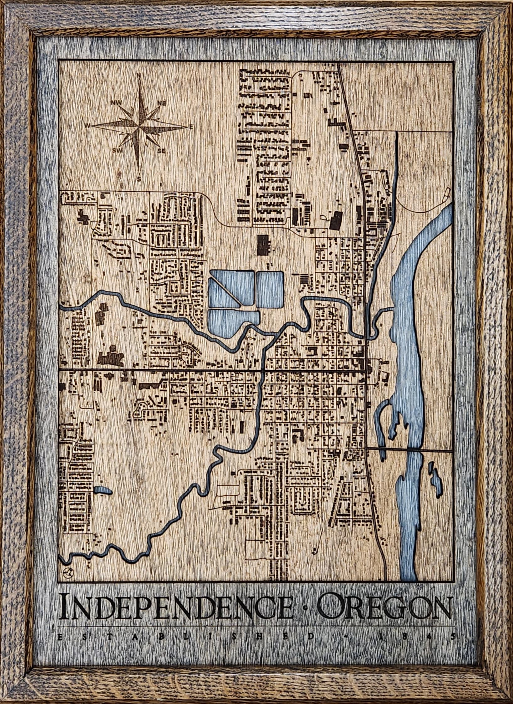

I used QGIS to build my maps. With the right filters, you can get to Primary, Secondary & Tertiary roads, which usually yields alot of small roads. Exporting out as vectors allows me to get single stroke roads that burn fast rather than engraved/fill passes for them.

Yeah, it takes me about 3 - 4 hrs to build the map so I can extract the layers I need. If it has bathymetry data (water depths) then it takes a bit longer as that data is pretty sketchy to get ahold of sometimes, depending upon where it is.
It took me 3 or 4 map iterations to figure out all the steps & get the files in a format that allowed a “reasonable” burn time for cutting & engraving.
