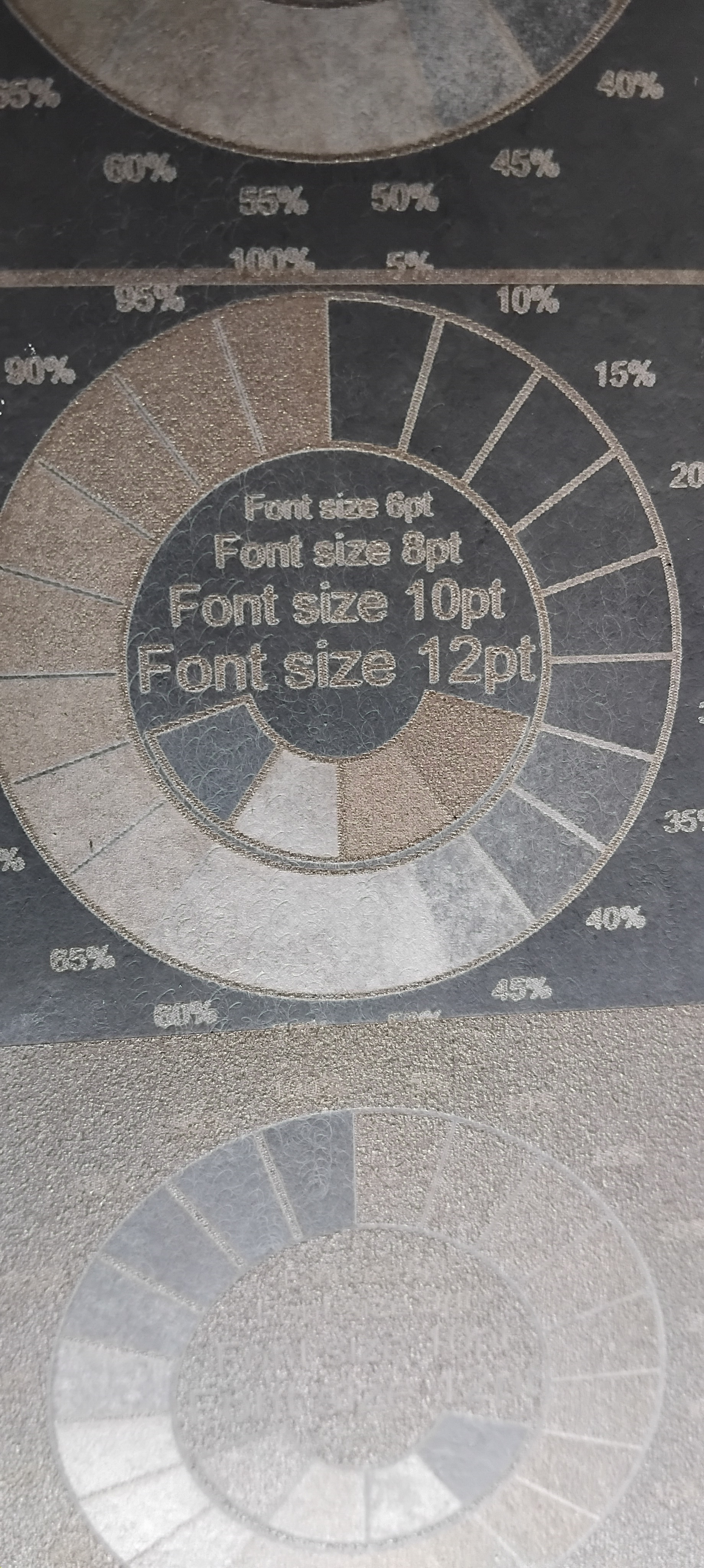

Gil from lightburn also has a vid on speed/power test where he introduces a dial test as opposed to the usual square type. I wached that..applied exactly what he did and it was a huge learning for me, especially when I changed Engraving Mode and watched the different outcome, and then Speed and Power. Use one of your big slates to create a Go to refrence.

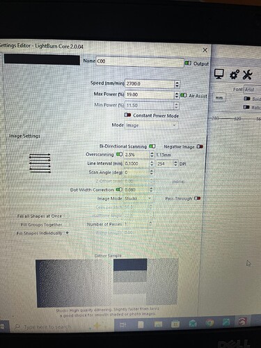

Max power: 19%. DPI- 254. I used stucki. No pass through. I think for the first tile I had negative on, it took 40 minutes and came out like a negative photo. So I changed to grayscale using a photo image not changed in ImageR. It was worse. It looked more pale. Where do I find the brightness, is that when using imageR? Is it imported looking like a negative photo or just a photo? Sorry for being so new at this, I see how clever you guys are! I am a retired teacher just trying to have a hobby! I really appreciate your expertise! I am also in Australia so times will differ!

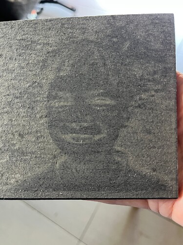

Here are some photos of today’s output!
I was super impressed with the speed! So Thankyou!

Try set your speed to 2000mm/min, dpi 220, Dont bother with other software, just pop your image in lightburn and select Negative (for black paint on white tile). And dont bother too much with finding perfect settings just now.
Select Jarvis mode.
Power set to 5%.
Run the job
Observe, But dont move the tile!
Restart the job.
Go to the Move window in Lightburn and Raise power by 5%…Let it run a while and keep raising the power until you see an improvement in appearance.

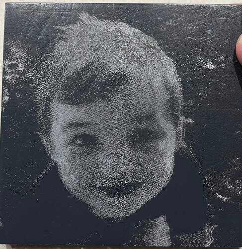

More practice with settings! This is 3000 speed, 16.5 power, 240 DPI, Image- Stucki. Pass through not on.
Certainly feeling happier with results.
Hi Carol
If you could crop that photo to just the area from the nose to the forehead you could focus on getting that part right and the rest of the photo would improve with it.but you could have many more attempts at it and save time and materials.
I think the image settings need more work than the machine so if you use that result as your base and raise the brightness a bit and lower the gamma and also the contrast to get more natural tones and shading in the area of the eyes where there is a lot of shadow presently.
It will depend on the original photo quality but I’m assuming its reasonably ok.
Are you setting the Image adjust settings by judging what you see on screen! sometimes a bit more brightness than would appear necessary can work out better, and if you apply too much you’ll know it.
