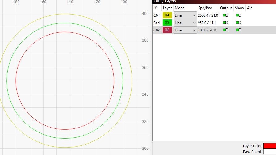

Hi,
I have made 3 circles, then chose one of the time to I get 3 rings.
then I want to just make the outer ring, but I only get one big circle.
I know is easy fix for them there know what todo
Thanks in advanced

Put the outer two rings on the same layer. Put the layer on fill.
Ring test.lbrn2 (50.1 KB)
I think that is what you want. Duplicate the innner ring and rename to 04, likewise duplicate the red ring to green. You must have something to fill!! As you have it now as you have found out it fills all. Hope this helps.
Check out this video (featuring my voice! ) for an explanation of the behavior you’re seeing, and how to get the outcome you’re looking for:
Around 1:23 you’ll see an example of what you’re seeing, but be sure to watch the whole thing for an understanding of the underlying principle.
We’ve also got written documentation that explains this behavior:
So as I understand it now
LightBurn cannot use the *same vector across different layers.
Therefore, I need to duplicate the shared circle as Brian Bigland said
Thanks to all and Tyler Raps thanks for the video.
