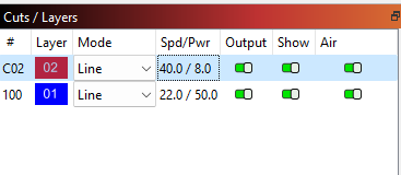

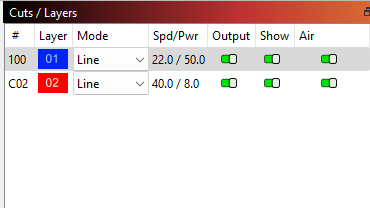

The issue im having is when i do engraving and cutting, i use the knife bed so that the parts will fall down in a collector tray, so obviously it is important that the machine is engraving before cutting. However almost every day im facing a issue where (in this example) the red layer (C02) has suddenly dropped under the blue (100) layer (using the same file when this occurs) meaning it is cutting before engraving and i have no clue why this is happening. I’ve tried looking for short keys explaining this with no results.
Summary:
I have set it to cut / engrave in layer order and that is correct and doing so, however the layers keep switching positions?

Yes i know the layer order can be changed, and i always double check the layer order is correct when i start my job with the file, but after this i change the cuts/layers screen to the camera screen when switching materials so im not messing with any layers after they set the first time.
There is not really any specific file that is making the wierd change in the layer order, usually i have big files including hundreds or thousands different earring shapes that i am organizing ready “outside of the workspace” while the machine is makimg the previous batch to save time.
Thats why i assume there might be some key combination that is triggering this because i use the software while cutting, like i said im organizing and twisting objects to reduce material waste.
I always have my camera window open, so i do not notice the change when sending it from my computer, i either notice it from the controller when pressing start, or in worst scenario like today when my customer contacted my sayin there was one color batch without engravings.

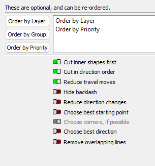

Can we see what optimization settings you are using?

Upper part was left out by accident.
Glad to hear you’re enjoying LightBurn! Thanks for sharing your settings.
Is your red layer possibly an inner shape that is getting cut first? That may be where a layer is being overridden. It’s hard to say without inspecting your file.

This has happened to me a few times in the last week or so. Click and hold one of the layers and drag it back to where it’s supposed to go.

Today i finally think i figured out what is causing this layer order switching. Like you know you can organize the layers like you want them, for me personally is use red for line engraving,blue for cutting, green for perforation mode and so on. BUT if you select your objects and want to move them i usually use ctrl+x to make sure i got everything and prefer to move object this way, this causes the layers to go away because there is now no layers in your project anymore until you paste them back and when you paste your objects back the order of the layers are in the order like displayed in bottom of lightburn.

I’ve replicated the behavior. I managed to make the numbers appear out of order. The layer that is fully cut from the project is appended to the end of the list of layers when it is pasted back in.
ctrl+x on the contents of a layer does not replace the layer in the previous order when ctrl+z is used to undo the cut.
