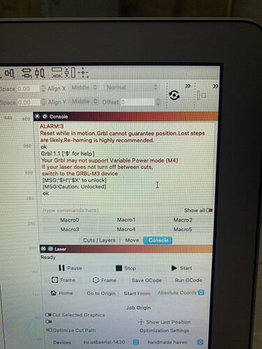

i fixed that but now my laser is just burning holes in the wood & not moving to engrave. it will move to one spot then just burn a hole. is there any videos you recommend for me to get started, because every time i figure out something, something else causes problems ![]()

Does your laser have homing switches? If so are you homing the laser?
After homing, don’t move the laser module by hand, use the jogging controls exclusively.
No it’s the atomstack a5 pro plus it doesn’t have homing switches i watched a few videos & it said to use absolute coordinate & always have home it in the bottom left
In that case before turning on the machine manually position the laser head at front left. That’s a manual homing process and the position of the machine will be considered 0,0. That will allow you to use Absolute Coords without issue. Additionally, make sure to only use jogging controls after you home or else the machine will lose track of position.
