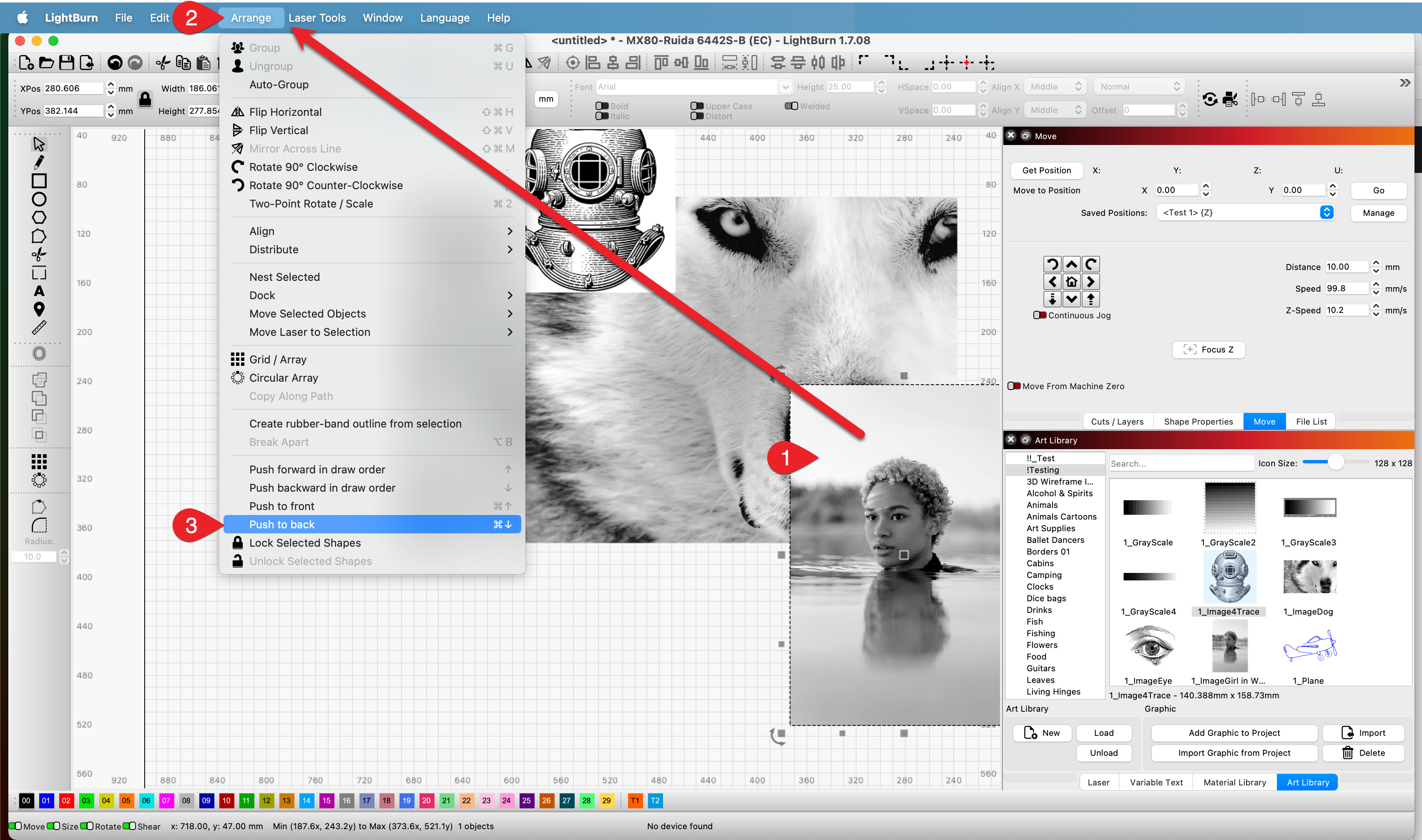

Hi Jack
Thats probably it. I was looking into how to give a sense of depth by stacking images with differing image adjust, and trace.
The LB team member in the vid seemed to be making the point of being able to simply bring one image to the forground but keep both on same layer.
I don’t know the video as I really don’t know a uv abilities. Can you post a link to the video and maybe they will drop by and clarify the issue for you.
This can be achieved using the ‘Arrange’ menu. From there, one can - Push the selection forward or back in the stack. ![]()
You also mention a trace in the mix. Please share an example of what you want to achieve, and we may have additional suggestions / workflows to offer for this task.

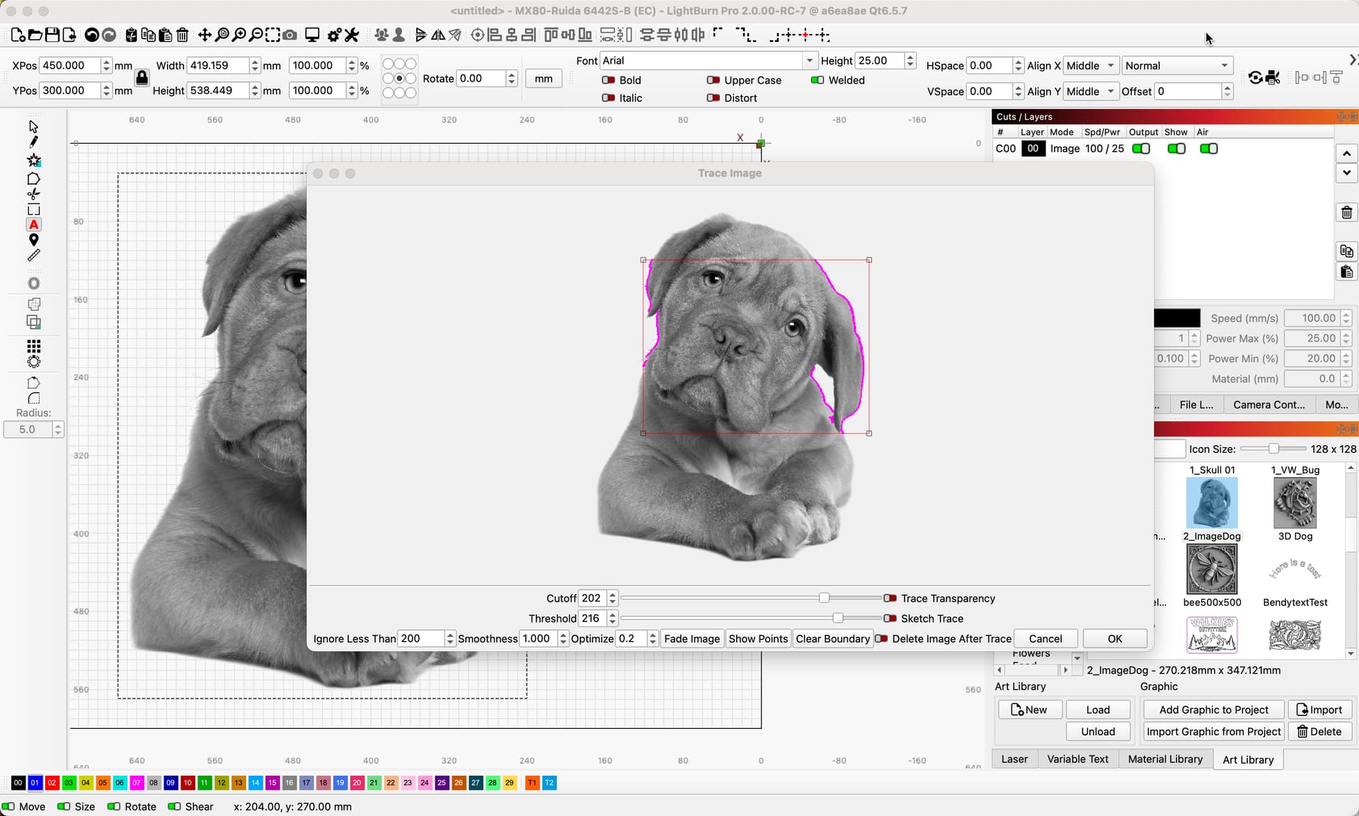

You can select portions of an image by adjusting the size and placement of the trace bounding box, which I show an example below:
For more from the documentation:
Click and drag in the preview to specify a portion of the image to trace. Click Clear Boundary to reset it.
Thanks Rick
That will also help a lot with cleaning up a trace and reduce job time also.
