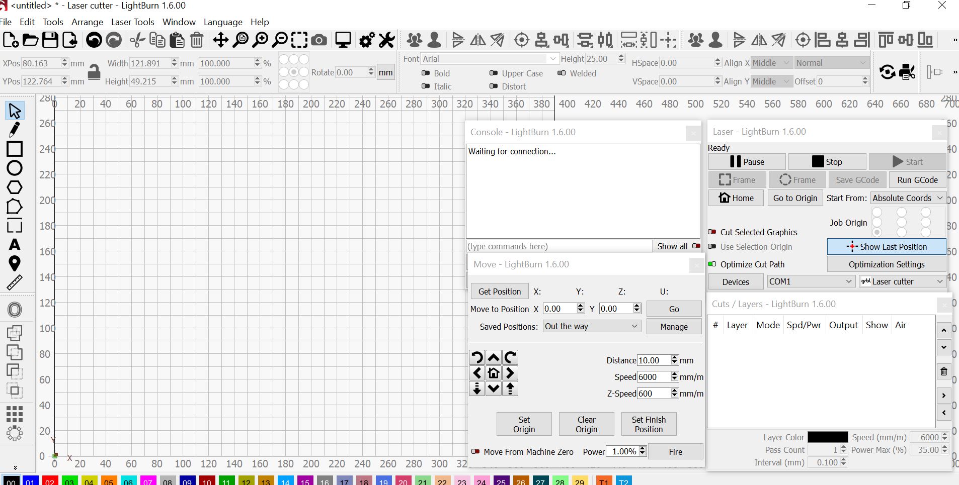

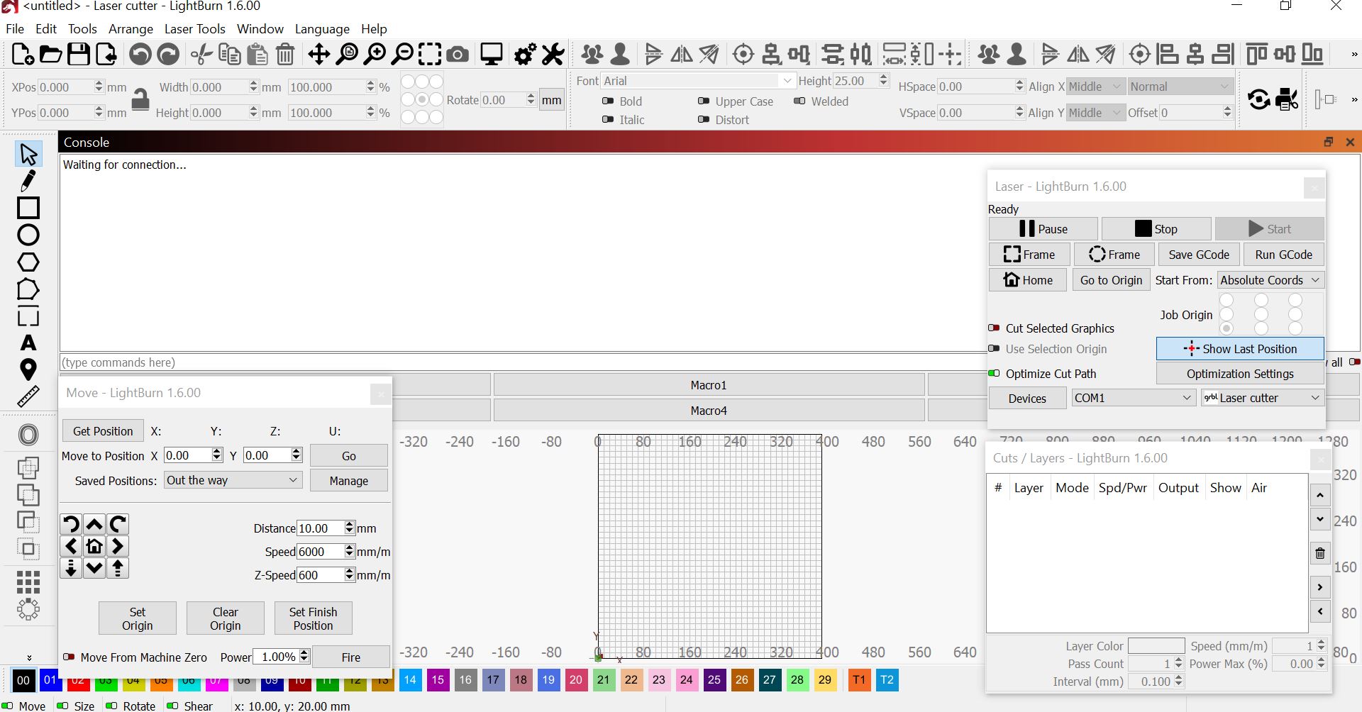

With all the updates recently, one was rather hoping that you might have sorted out the layout of lightburn so I can arrange these windows in the order I like without them constantly enlarging to fill the entire width of the screen
What layout are you trying to achieve and what’s preventing you from achieving that? It’s not clear from what you’re describing.
Are you deliberately going for floating windows rather than docking them?
All good questions,

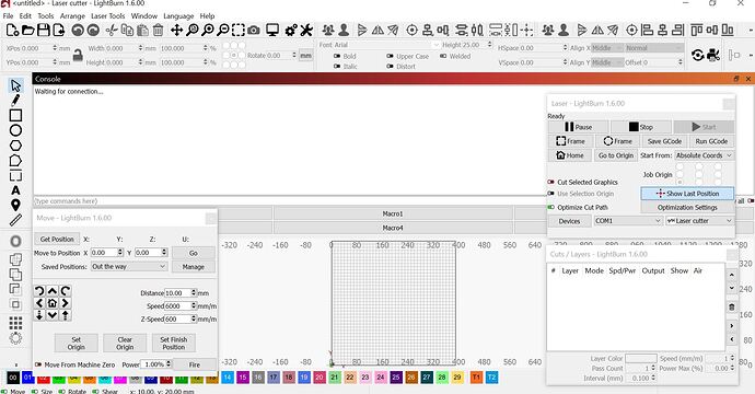

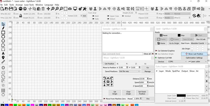

What I’m going for is what I have on the screen, but it takes me an age to organise the windows like this because they constantly want to expand and fill the entire width of the screen, when all I want is these 4 small windows grouped together on one side of the screen and out of the way.
This put me off updating Lightburn as means faffing around agin to get the layout I like

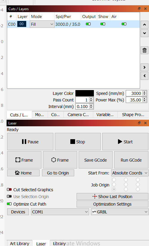

A couple of suggestions:
- Dock the two right windows so that they’re managed by the primary window and should stay out of the way no matter what you do. That leaves 2 floating windows.
- I haven’t seen the window expansion issue you’re describing but when that occurs perhaps try going to File->Preferences->Load Prefs backup to see if you can restore your old window positions. I’m not certain that works but worth a try.

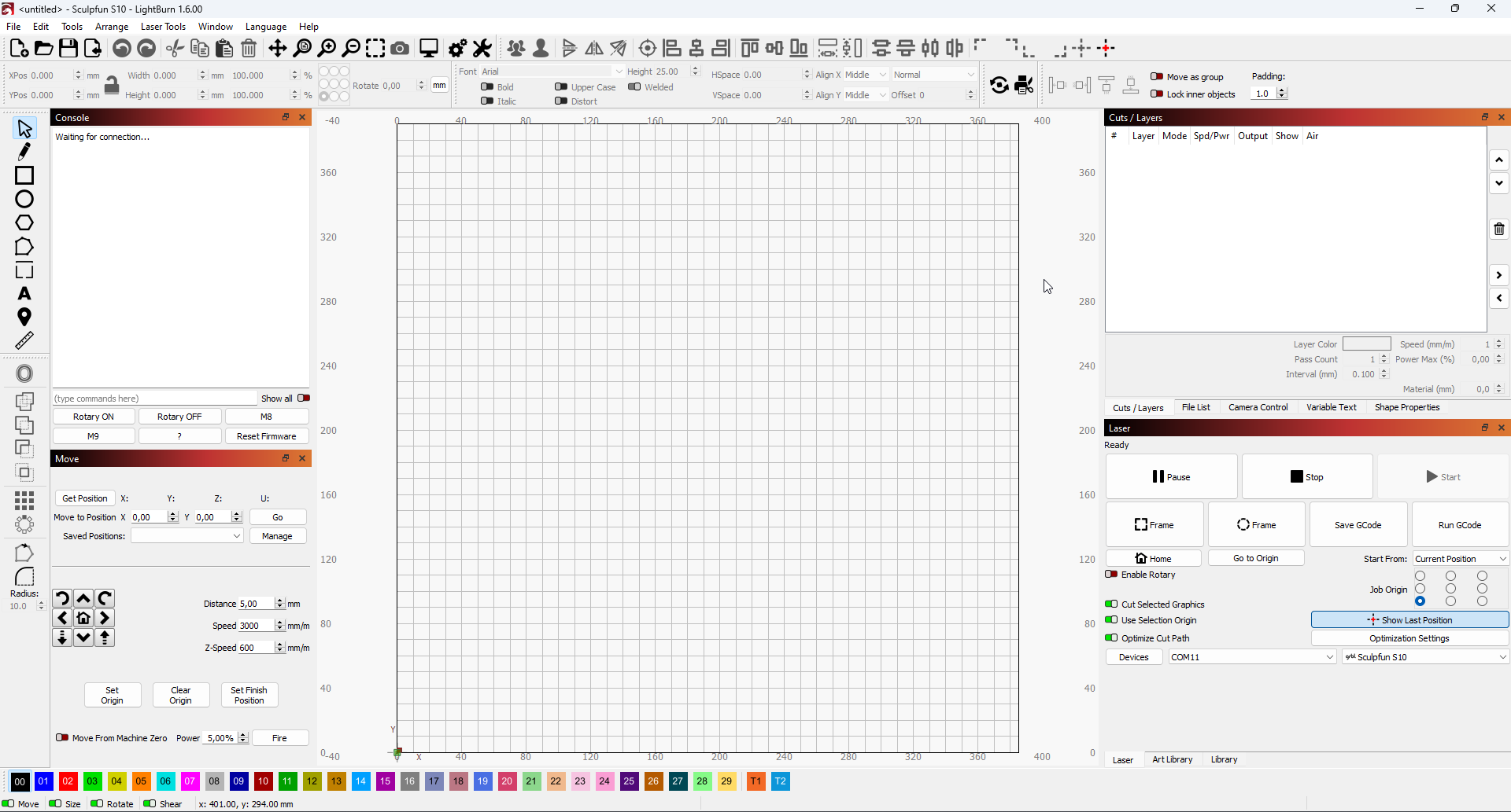

I think you can’t dock two columns on the right side of the main window. There is only one docking zone on each side. You can dock two windows left and two windows right:
Here, I put the console and move window to the left docking zone, and they stay there when moving the window. This positioning is also preserved when updating LightBurn (ok, at least in most cases, I also experienced lost window settings when updating LB already, but typically it went well).
