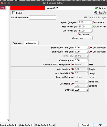

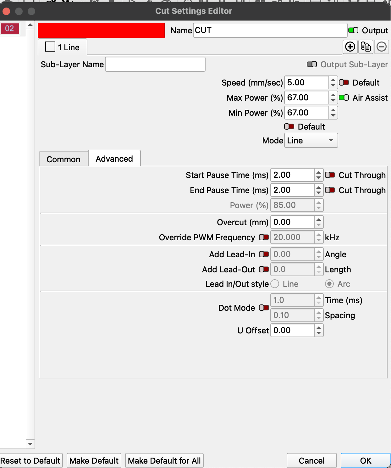

Why do you have a start and end pause set?

Not quite sure where the 2ms delay came from I removed it.

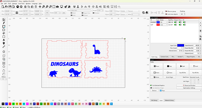

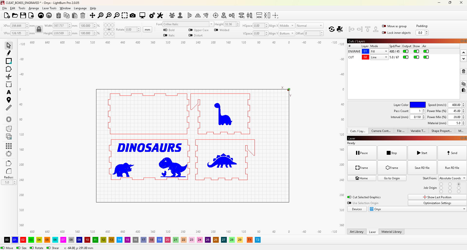

Don’t know that I will see anything, but post a screenshot of your entire Lightburn screen with your project loaded and the laser window and cuts/layers window in view. (No phone pics please)
I was hoping something would jump out at me, b ut it didn’t. The only thing I see here, and it wouldn’t be causing your issue, is you have min and max power set different for fill mode and min max the same on line mode. This is just opposite of how I work. I have min power set on line mode so it doesn’t burn corners and keep the setting the same on fill mode as it doesn’t need to reduce power due to overscanning.
What exactly is happening? Does it get to a certain point and then error out or does it not even start to cut? Does the engraving portion work? Without a console to show error messages it makes troubleshooting more difficult.
