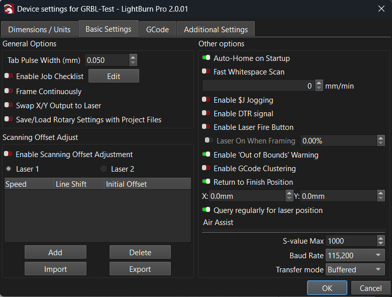

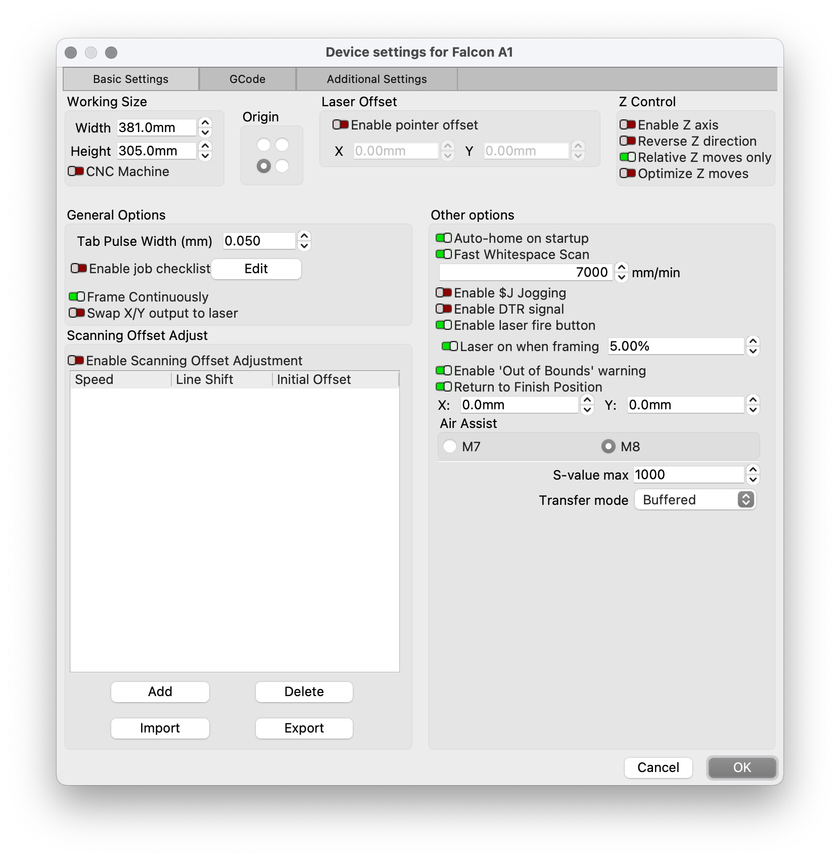

No problem. Since I cannot upload the lbzip files, would a screenshot of each help you?
That would definitely be a good way to start.
Ideally if you can show me this tab in particular, that would be of great help:
Thanks

I have to say I don’t quite grasp what the issue is here - the gcode generated seems to be consistent.
There’s an option in 2.0.01 that was set that adds an extra G1 S0 line, but that shouldn’t explain the issue you’re having from what I can see. We’re digging in deeper to understand this.
