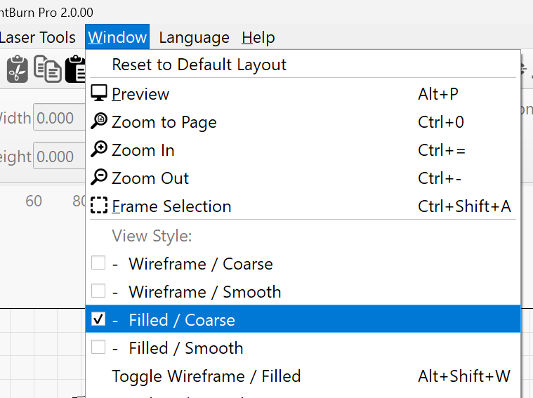

Lb 2.0 the figure no change from line to fill
the new version, 2.0 do not the fill uo the shapes
in time, after the instalation of 2.0, all the version om my computer do not the fill up, cn some friend help me?
Hello Eric and welcome!
The Fill Mode only works with shapes that are closed. A shape is closed when it is a complete, continuous loop whose start and end points are the same. When a shape’s start and end points are different, it is open.
See Open vs. Closed Shapes for more information.

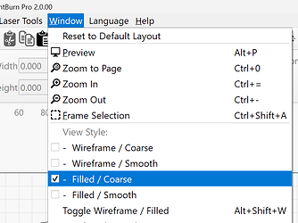

To display the designs in the Fill mode, change the View Style to “Filled” here:
You can toggle between wireframe and filled with Alt-Shift-W
(or with the corresponding command from the “window”-menu)
