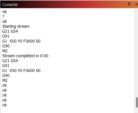

Having a strange issue where lightburn is sending all gcode in duplicate. If I look in the console, I can see the gcode for a move command appear twice (ie move x +50 and the gcode to do that task will be sent twice as can be seen in the console).

LB Console
I should add that not only jogging, but also does framing and actual laser job twice as well. Also LB v 1.5.06 on Windows 11

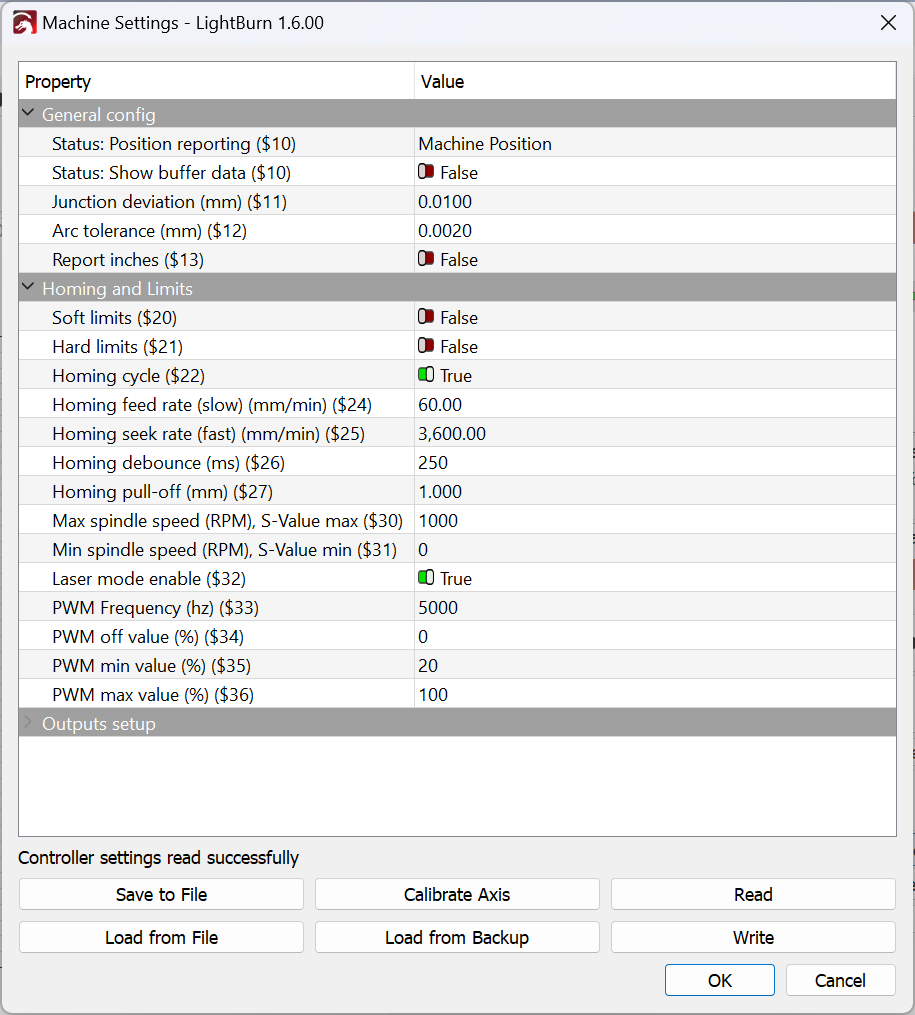

a) Screenshot of the Edit > Device window

You also reminded me of another thing I needed to test. The attached gc isn’t the one from the video, but if I save the gcode then tell it to run gcode, it only goes once. If I don’t do anything to the setup and just hit start, it goes twice.

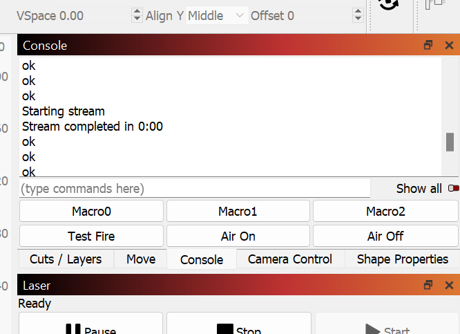

In the Video I noticed that ‘Show all’ is selected.
LightBurn won’t usually display what it sends unless that switch is selected, If you turn off ‘Show Selected’ and repeat the test, one of two things should happen.
You’ll see only one copy of the sent commands, showing that the controller is echoing what LightBurn sends. This could be normal. Still investigating.
*Note: Controllers are occasionally set to Echo the commands sent. There’s probably something in a config file to turn Echo off. I hope this isn’t an option that’s limited to Build-time (when the firmware is compiled and flashed into the controller).
or…
You’ll see zero copies of the sent commands, showing that LightBurn was sending both sets of commands and that neither will be shown under this circumstance.

show all off
The screen shot shows what happens during a jog with “Show all” off in the console.

Another thing that I noticed is that while it moves twice, the current position coordinates only update to show one of the moves (ie jog x+50, coordinates show the position as x50 after the doubled jog)
