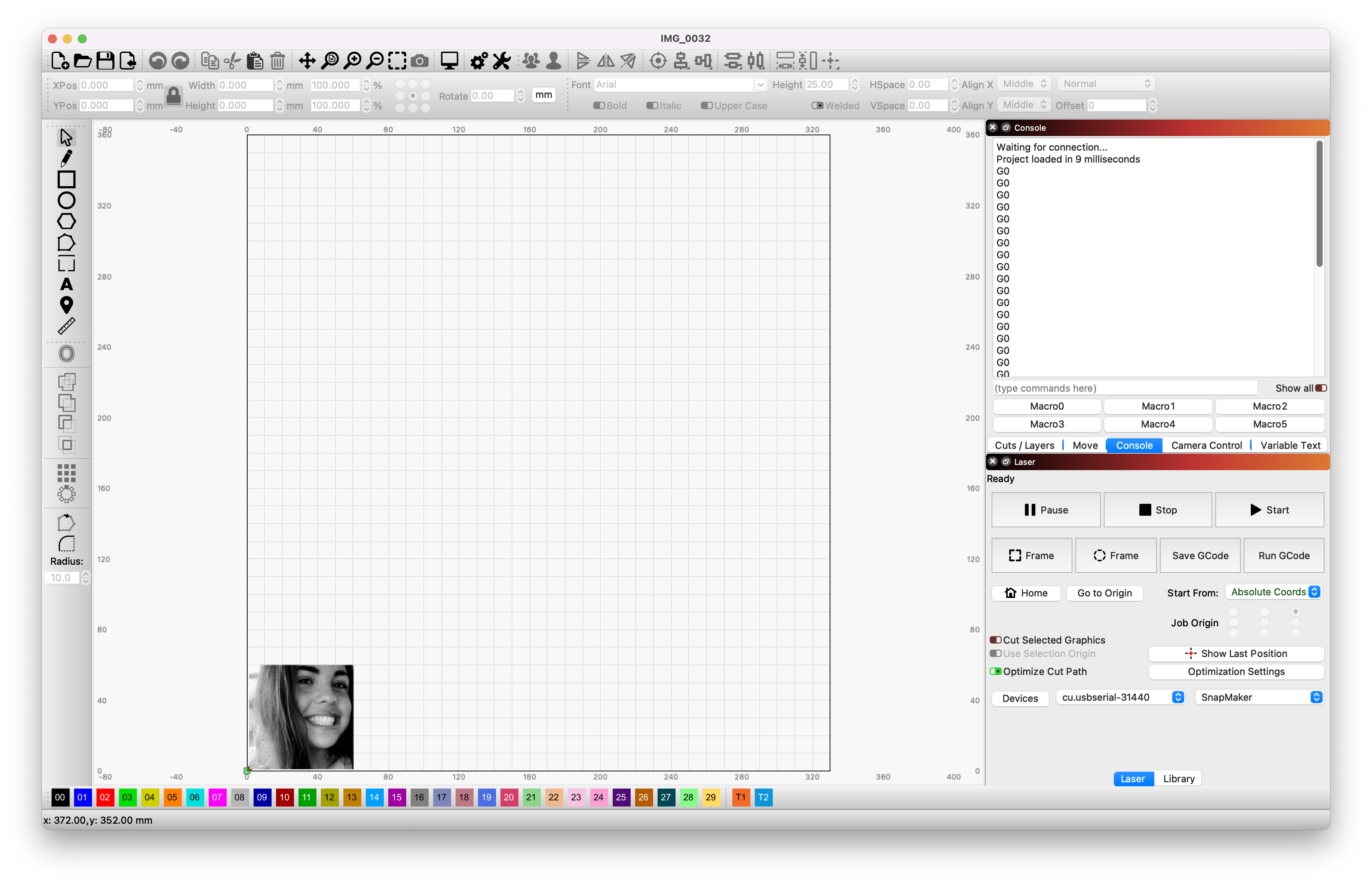

iMac with latest Monterey was working then just stopped connecting. I verified USB device for Snapmaker 2 was available, right clicked on devices, removed and reinstalled Snapmaker 2 device, rebooted, uninstalled all LB files, reinstalled, still same result. Simply refuses to connect. The connection panel sometimes shows connection but the console say “waiting for connection”.
I can connect to the Snapmaker 2 using terminal and other software.
Any ideas? I can’t buy this if it won’t work.

How exactly are you doing this? Can you send a screenshot of LightBurn as well as you connected to with the terminal?

I just noticed something in the UI, devices are specified cu.usbserialXXX and in the terminal looking at /dev they are all tty.usbserialXXX.

Just noticed after turning on “Show All” in the console pane that LB is constantly sending out G0 over and over. Why?
From what I understood of the issue it wasn’t that you needed a 3rd party driver to support FTDI. It’s that the included driver was interfering with other drivers that were installed.
You being able to connect to other devices seems to negate that though.
Not sure what’s going on with the G0 but it may be the way that LightBurn is initiating the connection and expecting a response.
