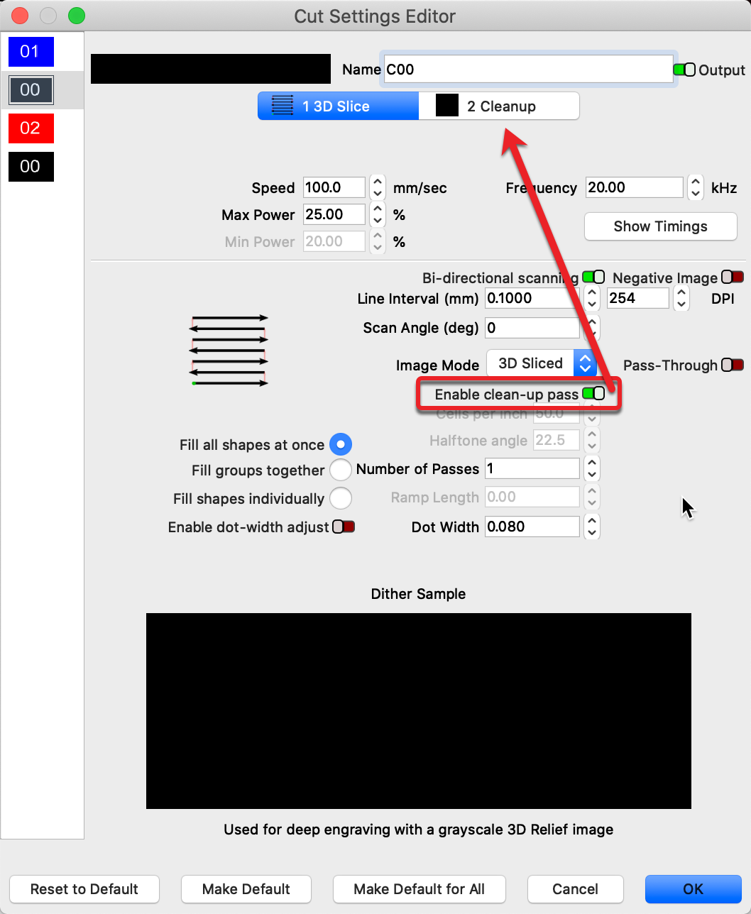

LB ver 1.5.02 ENABLE Clean up Pass
Just upgraded to 1.5.02
Started a 3D Slice operation on a Brass Coin
Enabled “Clean up Pass”
what it does is that after EACH 3D engrave pass the Cleanup pass starts
I thought it would only initiate at the end of the 3D slice operation

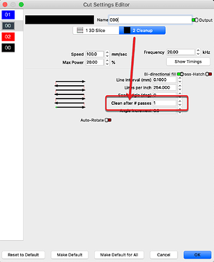

OK, so I missed it as well.
When you tick the ‘Enable clean-up pass’ to On (green), a ‘Cleanup’ sub-layer is added to that layer and has additional settings. One option allows you to define when you want the clean-up passes to intervene.
Ok Thank you
I was thinking that was how many clean passes to do

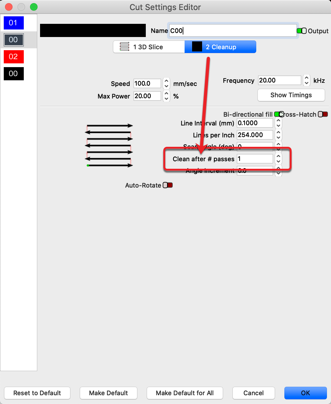

It is being discussed, yes. And as mentioned,
Update, chatting with Oz:
Oz: The feature has a single bug that I’m aware of, and that is that it will clean the last section it engraved, not the previous N sections. For example, if you say “clean every 8 passes” it should clean the area covered by any of the last 8, not just the previous pass. That has been resolved for the next update.
…I made it not clean the entire image because I didn’t want it dulling fine details you had engraved early by repeatedly going over those areas long after they’d stopped engraving. If one wants to rid the engravings of slag, air works far better than a cleaning pass and doesn’t add engraving time.
