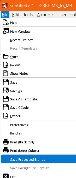

Vectors you cannot load into Word. Images can be pulled onto the Lightburn grid, then saved as image files. I have no image files in my art library, so I do not know if you can copy from the design grid and paste directly into a Word document.
You can get vectors by pulling it to the grid, and then using the Preview window. You can then save the image from there.
